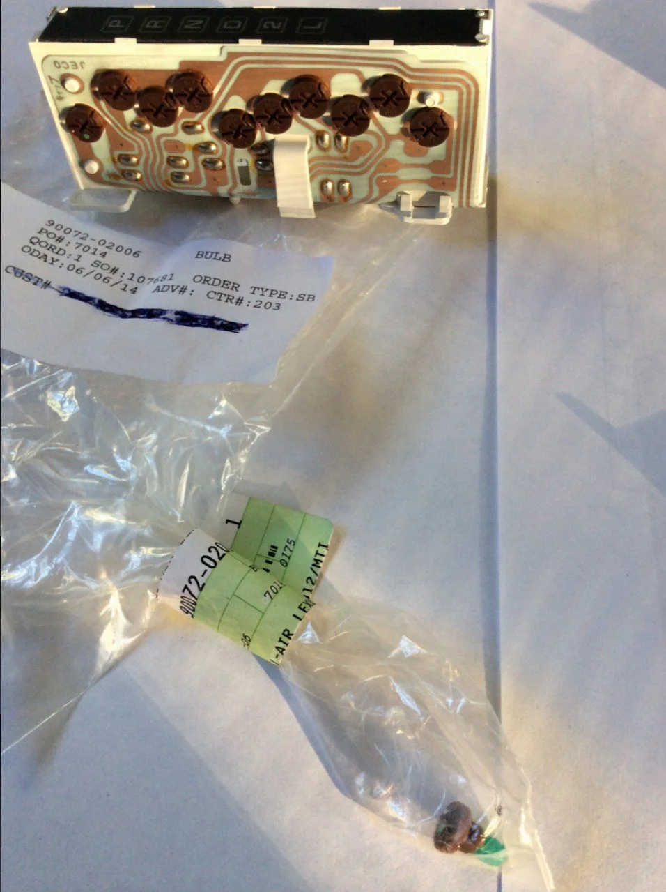

Seems there's been a few threads on dash bulbs, and since I have my dash completely apart, I thought I would change out the multitude of burnt out bulbs.
Here we go.
Antenna Switch.
Hazard Switch.
Diff Lock Switch.
Instrument Cluster trans shifter module.
90072-02006 (qty 1)
90072-02005 (qty 9)

So which position is the odd one for?
Sorry, but I have no idea.
