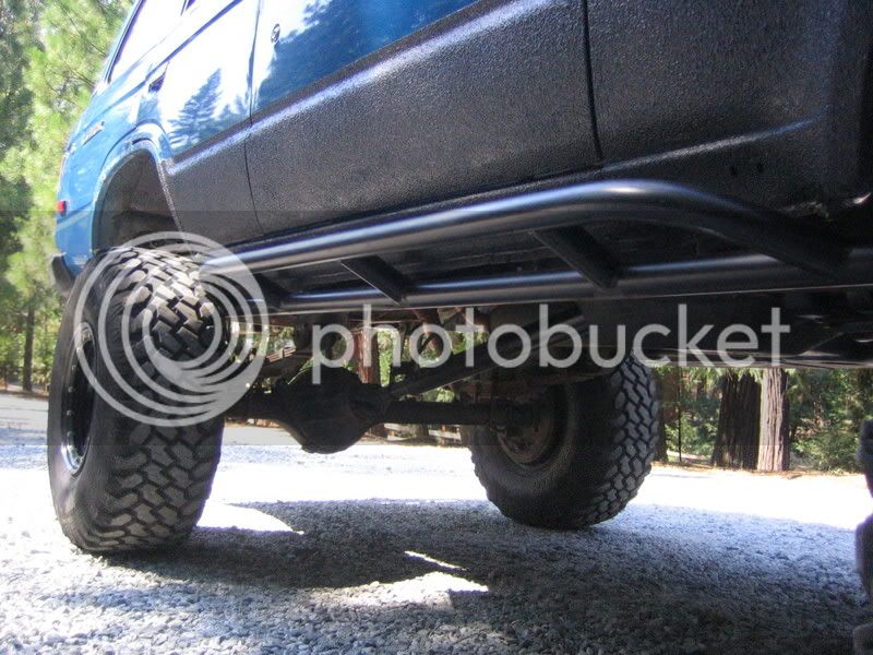

67" sliders.:D
So, are the bars that tie into the frame at a downward angle on those trucks that have the marlin/TG sliders? I bent a bar up for mine and even with an inch of body lift i had to notch out the bottom of the rocker to run the supports at a 90 degree angle to the frame.
nice looking rig hatman. the close up pics of the front are perfect to get an idea on how beefy these are.
yes they are at an angle, I also cut out the pinch weld to get the slider a .5" closer to the body.
Im doing mine as we speak...waiting for the paint to dry...
I angled the outrigger bars down and added a gusset.
BTW, if you have a 62 with the stock exhaust...it takes a bit of work to get around that crap on the drivers side!
I ended up needing a longer outrigger piece for the front one...
The frame angles in, and the ones supplied are too short!

67" sliders.:D
Nice rig man! It looks like you went with a pretty steep angle.
