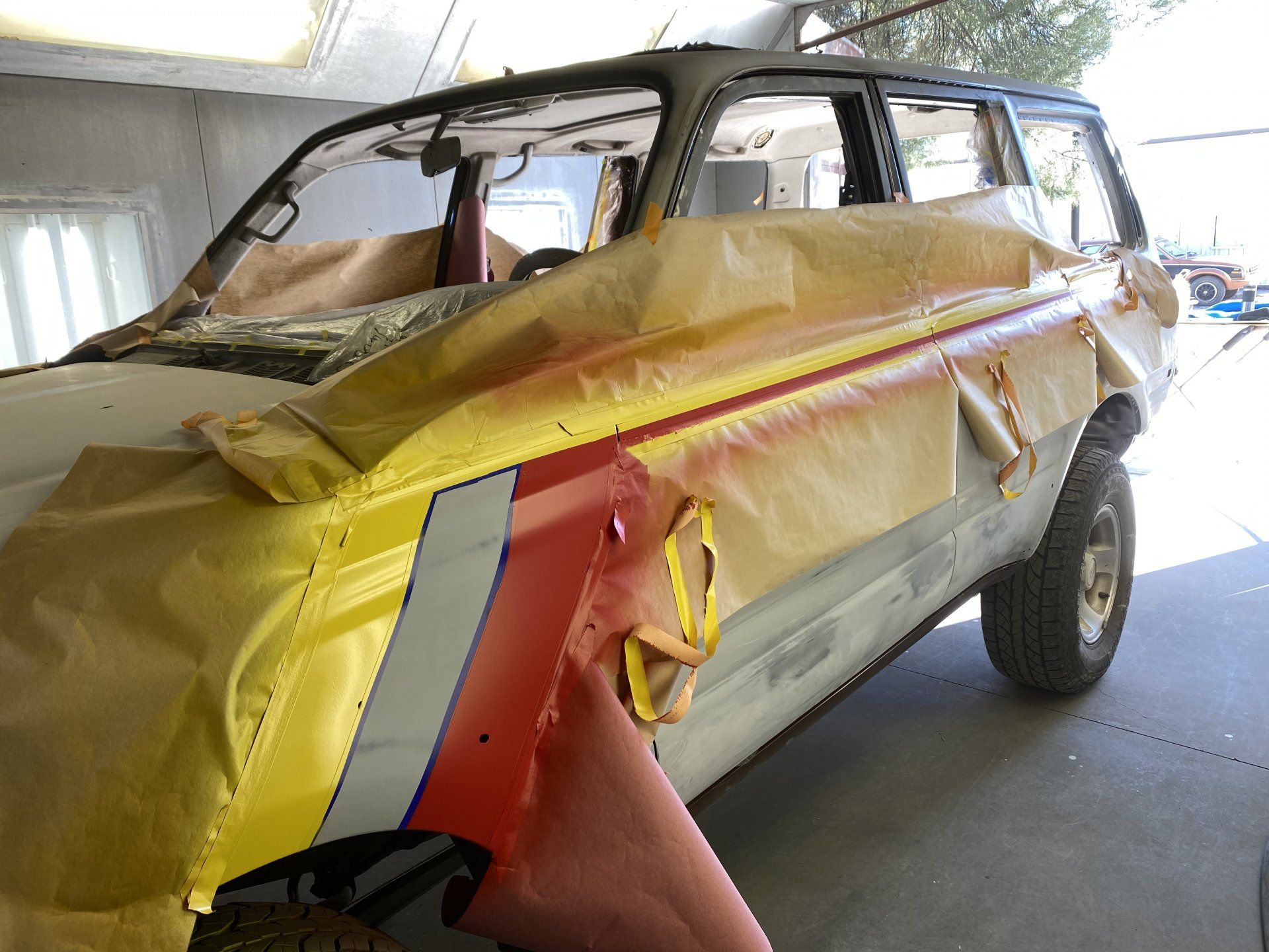

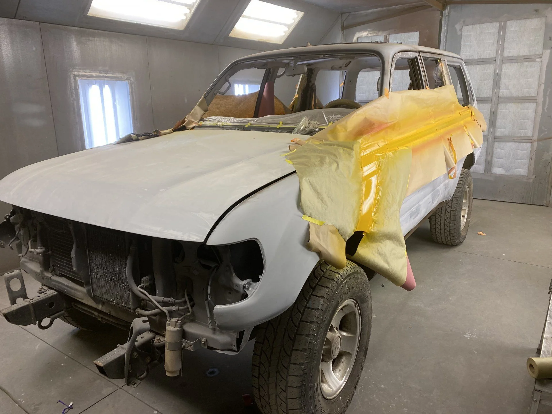

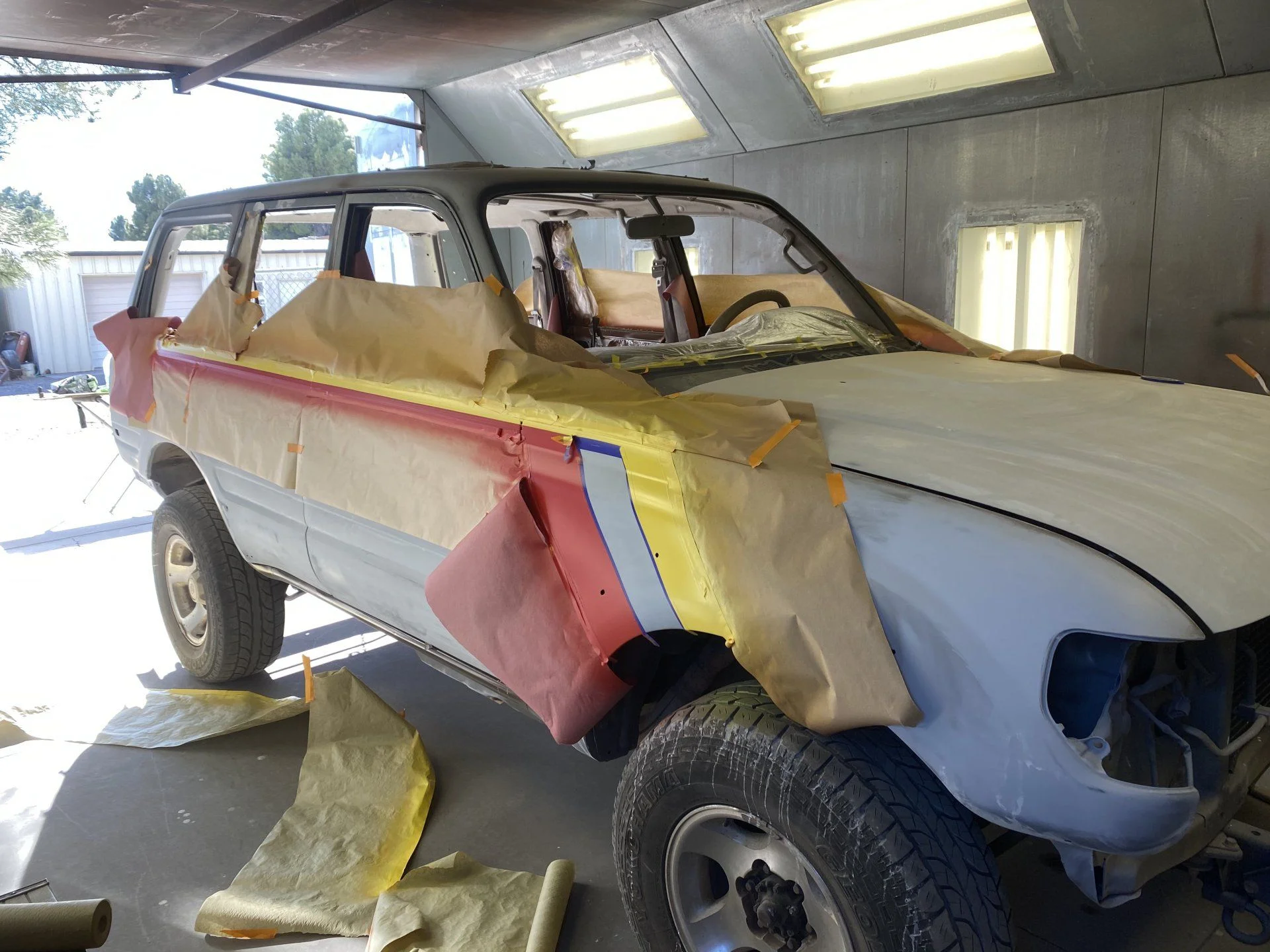

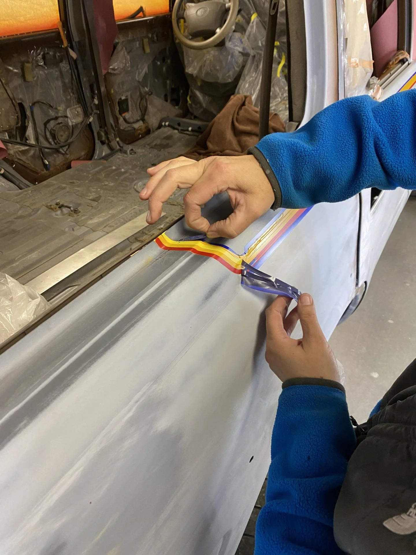

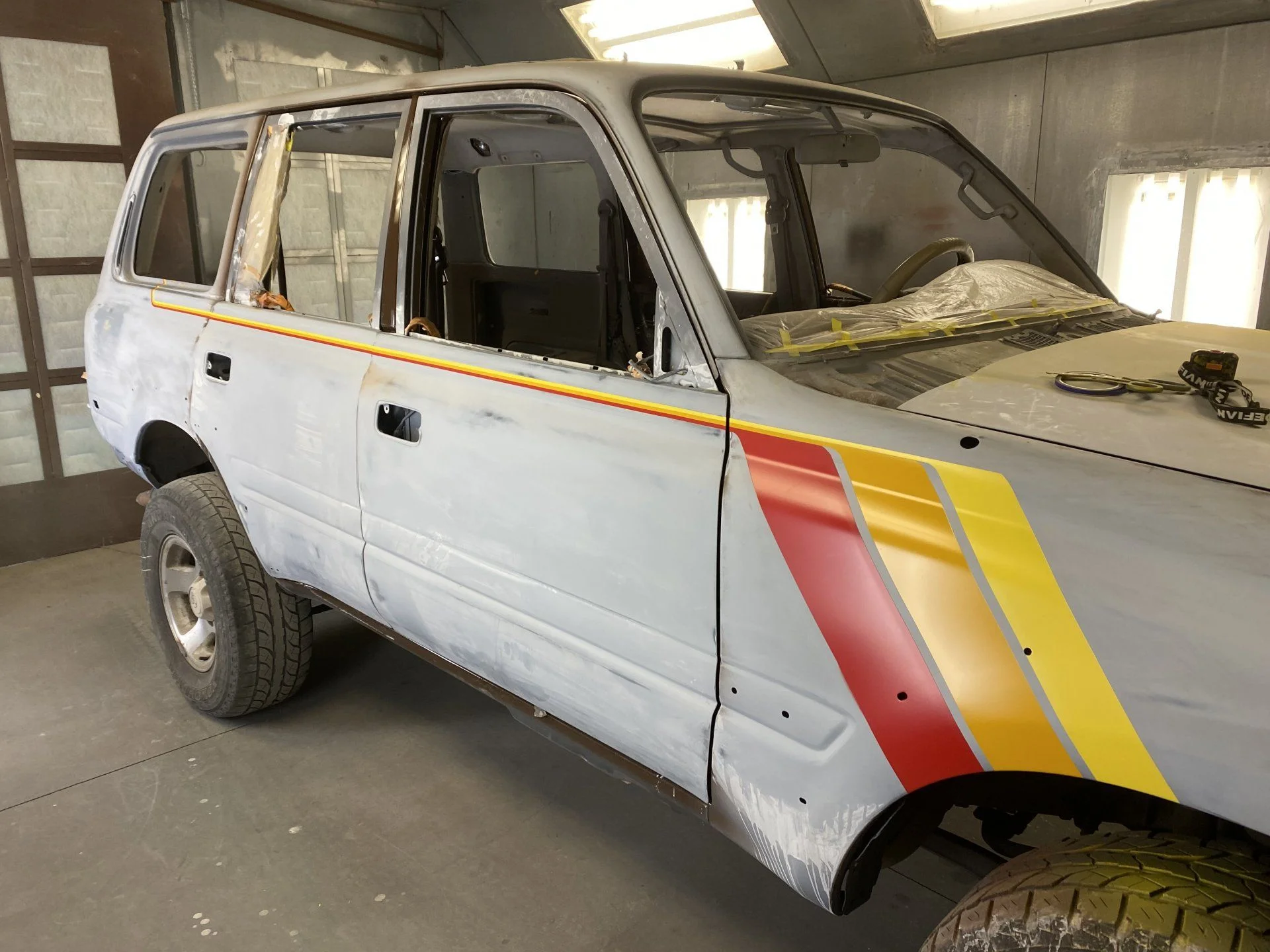

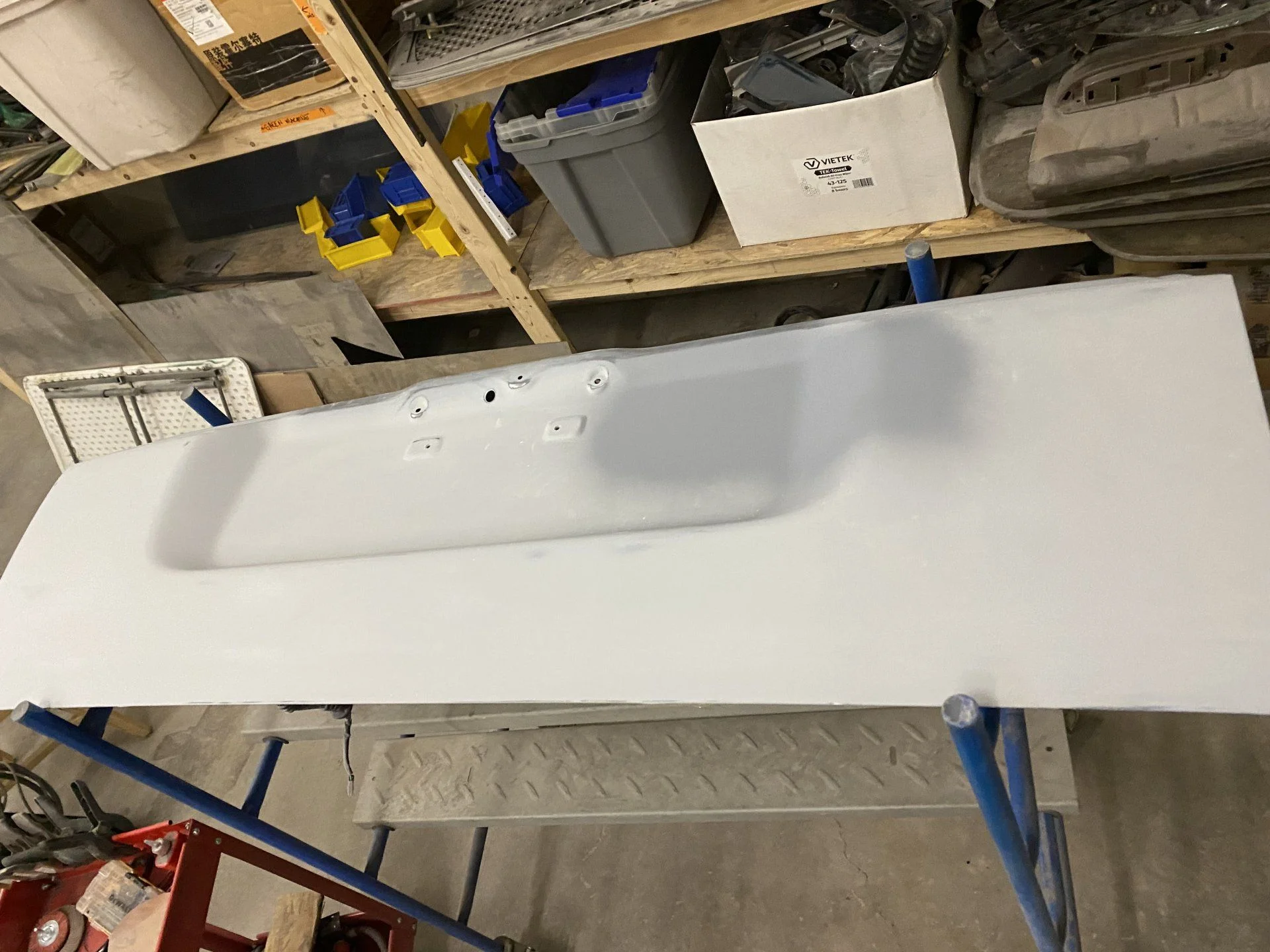

Another color about to be painted! I need Kelly’s help today, but I will do as much as I can
Super curious to see what you’re up to! Your dedication is impressive. Judging by your username, I bet this project has been a great escape this year.
thank you! I’ve been an RN for 11 years. 2020 has been tough for so many reasons...for so many people. I don’t know much about restoring Land Cruisers, but I'm learning a lot. I love it too!!!!!

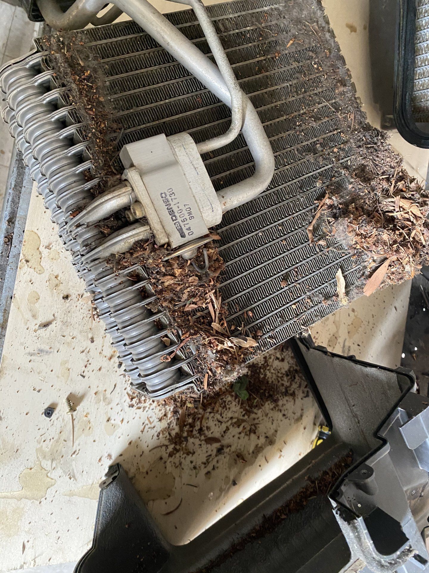

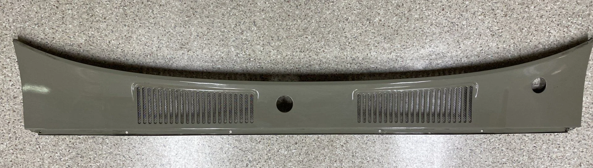

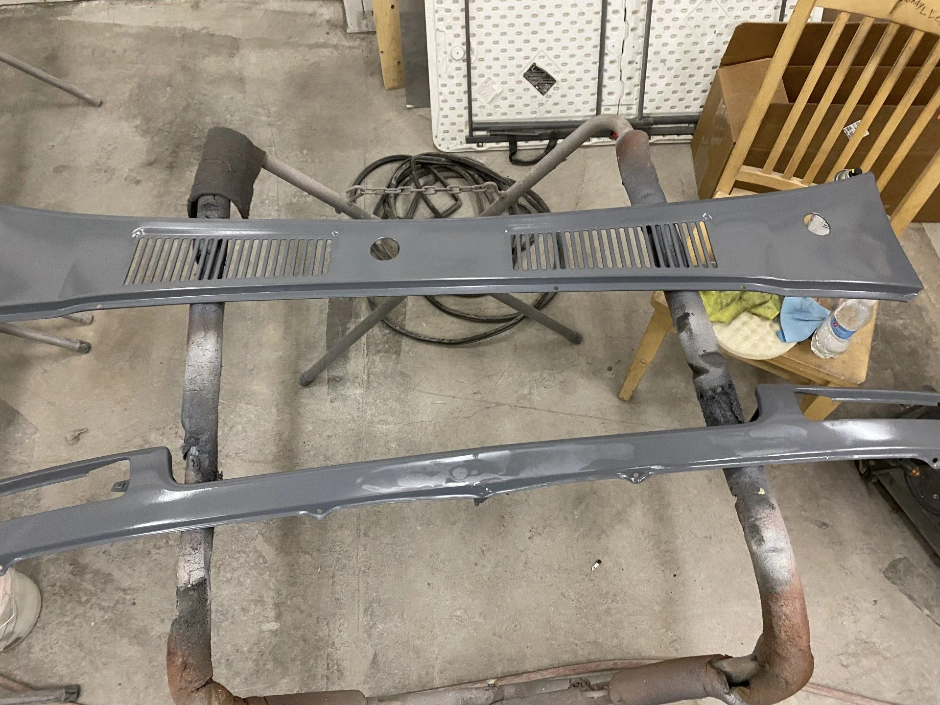

You are doing an amazing job. Can’t wait to visit you guys in Flagstaff and see it in person. I highly recommend adding a screen under the grill that is by the wipers. The 80 series does not have a cabin air filter and when fixing a leaky air heater, I found a forest in there. At least you capture the big stuff. I just glued it with aluminum epoxy.

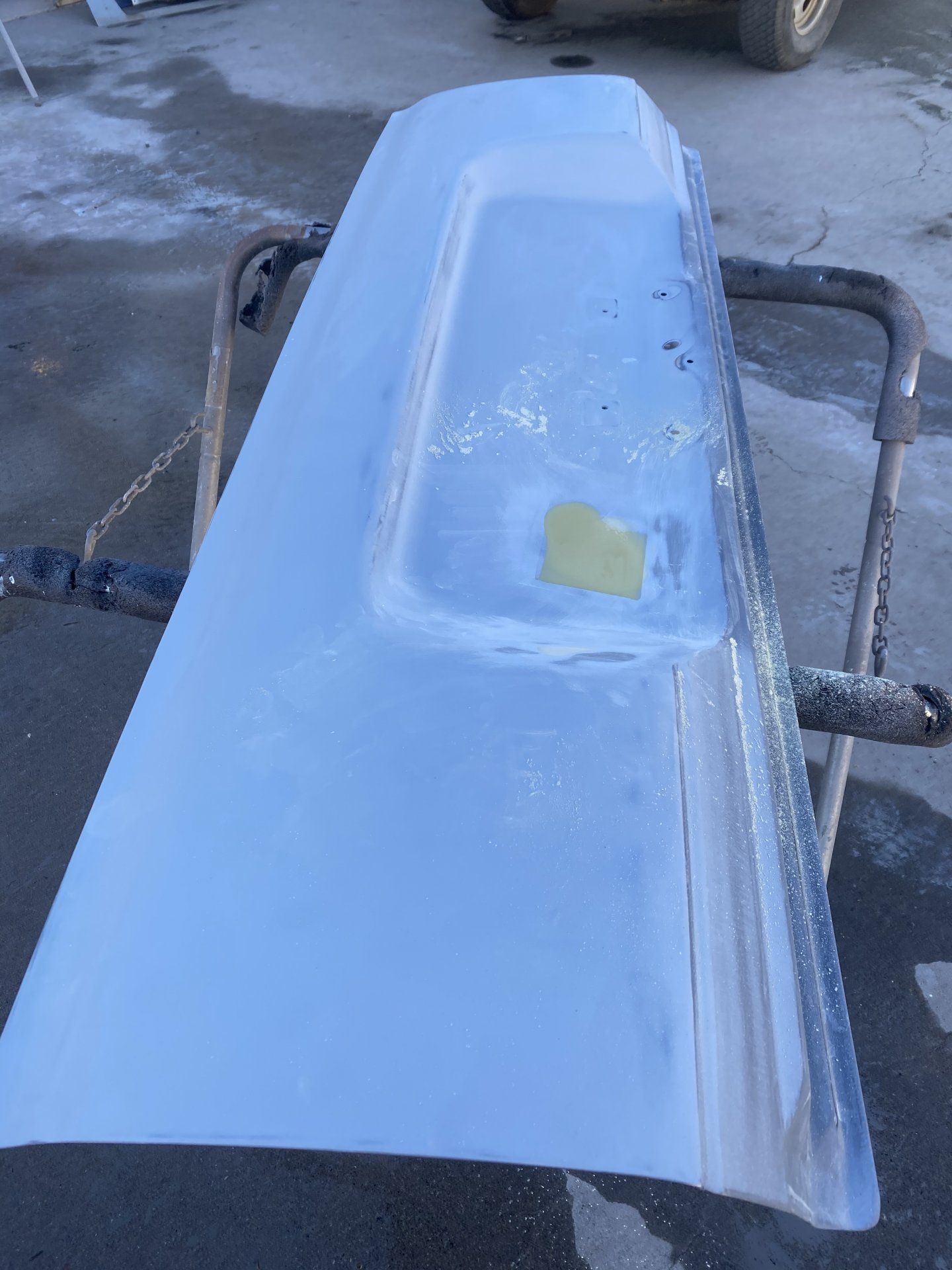

i used Easwood Contour Drum Sander for the monstaliner. Mostly 80 & 120 grit
