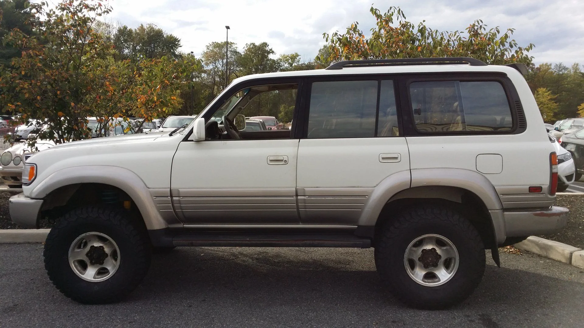

It took me a long time because I travel all the time. Also, I bought a second truck. Here is my 96 lx450 with 315 bfg at ko2 with a dobbins 4" lift.
