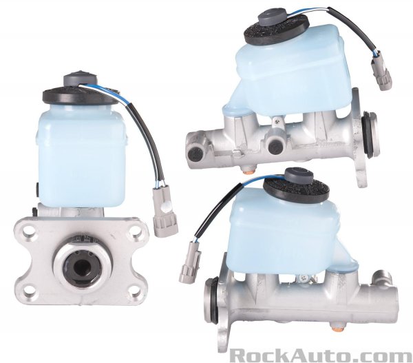

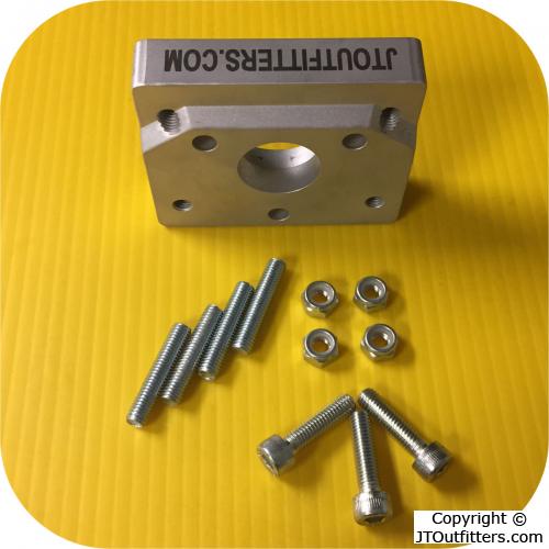

FWIW, it is less money and easier to do this using the JTO adapter block
and an OEM Aisin BMT051 brake master.
It looks like this on the firewall of a 1962 FJ45. BTW, that's a common 1978 clutch master next to it, also OEM Aisin from Rockauto.
Just posting this for informational purposes to anybody reading later about this same question.

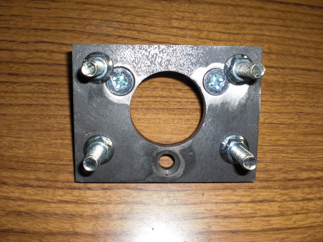

And a pic of the prototype I made for the 65SWB ...back in 1993:
I should probably paint it, eh?
