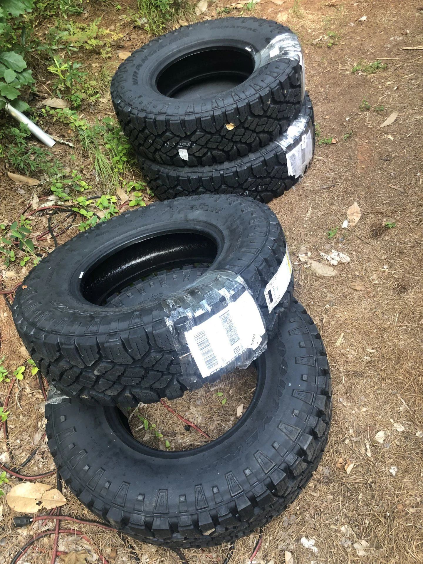

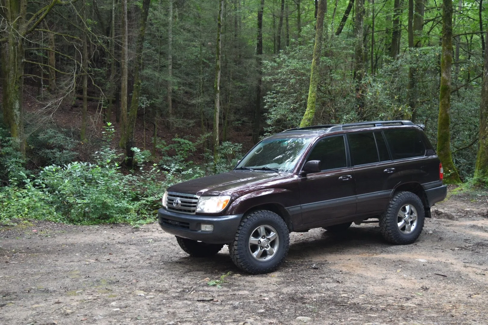

Also, went a different route on tires. 295/70r18 KM3s were backordered to infinity so I changed my order to a set of 285/75r18 Duratracs after seeing @sonk76 LX in some photos. They’ll probably rub less, be more quiet, last longer, and just generally be a better choice for my 99.99999% pavement driving.

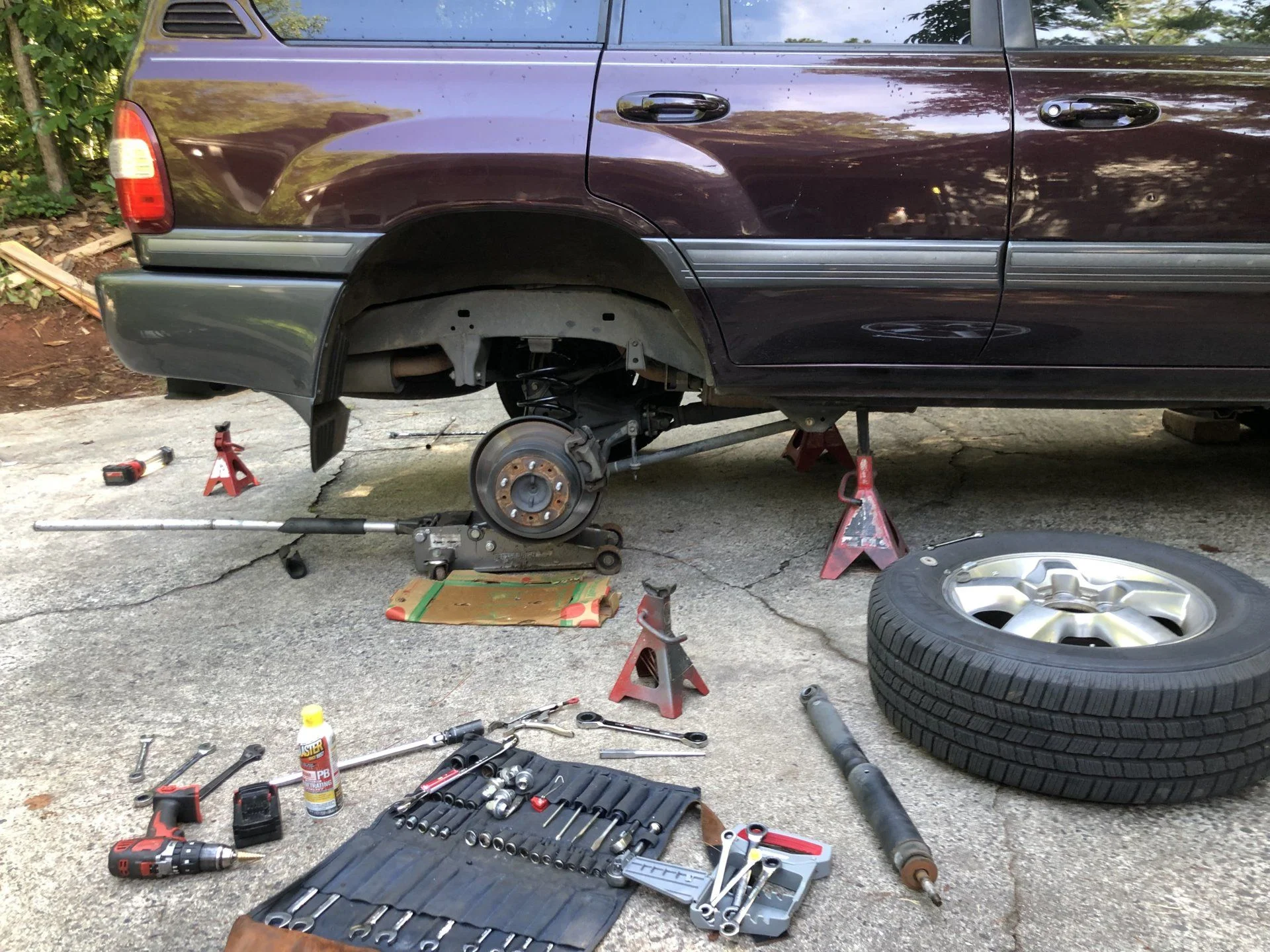

It’s been a couple weeks since I installed the OME kit, @TRAIL TAILOR diff drop, and put the new tires on. It went really smooth, the no rust really spoiled me. The worst part was having my arms get tired while removing the rear passenger side shock, but I am a sissy little girl so your experience may differ.

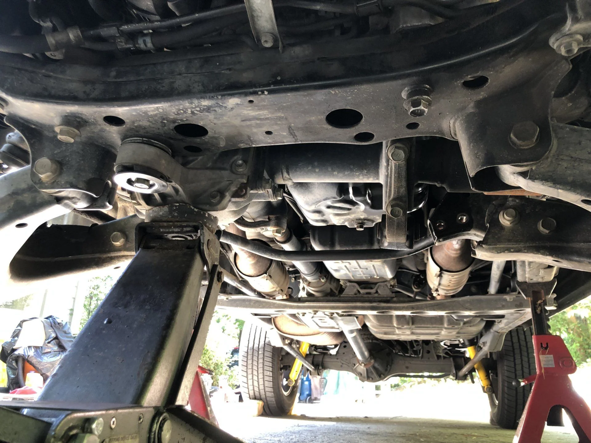

Installing the diff drop was super simple. Jason’s instructions were dead on and having the torque numbers in hand was much better than me deciding, “eh, that’s probably tight enough.”
I didn’t have any angle iron laying around to use as a straight edge so with me on one side of the torsion bar and my brother on the other, we decided with “100% certainty” which valleys were exactly at the 12 o’clock position so we could mark the torsion bars for proper orientation and installation. Lucky for us, we got it right the first time lol.
The rear sits just a hair over 23” hub to fender and I’ve got the fronts set at 22”.
Initially, I was really happy with the way it rode, but I’d like it to be smoother over bumps and on the highway. It’s not awful and it’s still more comfortable than my brother’s 80, but I’ll definitely be upgrading the shocks down the line.

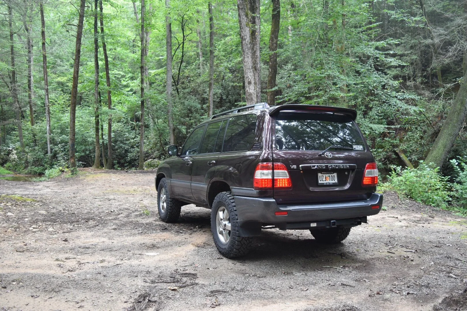

Any rubbing with that size tire?
Had my heart on some 295s also but the 285/75 might be an good alternative.
At full lock it rubs the pinch weld. I’ll probably hammer that down but I for now I just don’t turn that hard. They also do not contact the stock UCAs.
