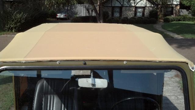

Well here is the final product not bad for my second attempt. I love the zippers and this material... It is strong!
It took me so long to finish because i was trying to color match... My first supplier ran out of the lighter color. I gave up and made a two tone top piece
