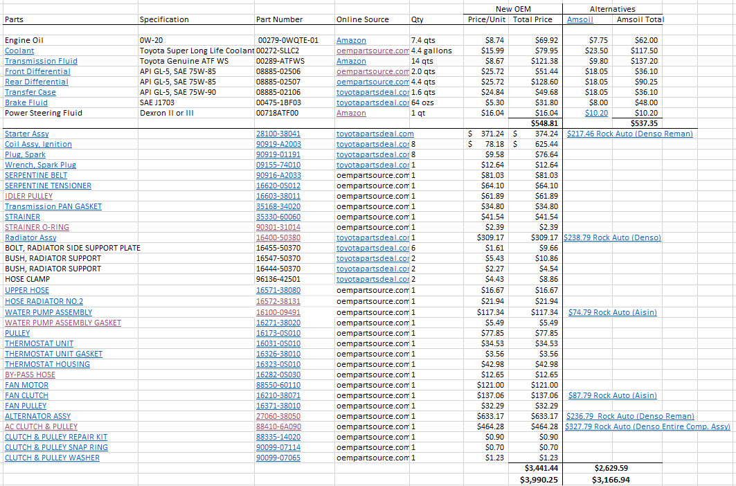

So this is what I've comprised. If anyone knows of an easy way for me to embed the spreadsheet let me know. (Edit: I attached the file. Tell me if its working or not.) It has hyperlinks to part sites and how to's on the fluid changes. One thing I don't have yet are part numbers or sourcing for the cooling system plumbing that I'll replace with metallics over plastics.
I thought I would change my mind and go all OEM Fluids, but after some reading and price comparisons, I'm reverting back to the original plan with Amsoil.
Something additional I will do is go ahead and replace my front brakes and rotors. The rears were done 5k miles ago.
I don't think I'm going to do the starter or ignition coils at this time, but I am going to do the AC compressor. Not because of the compressor necessarily, but because of the clutch and pulley potentially failing. Plus I might as well since I'll have everything apart. As you can see below, I can get the entire assy from Rock Auto (Denso) for over 100 bucks cheaper than just the OEM clutch and pulley.
So all in, I'm looking at around $2500 in parts (going with alternative route). I think that's good insurance for the future.
