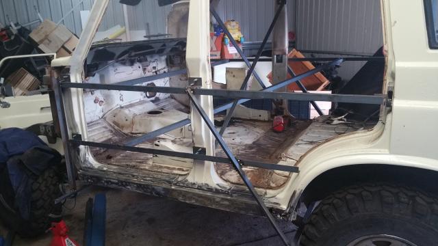

Well i got some steel and made mounts for the bracing today.. then mocked up how i was going to brace it..any feed back?
The last photo shows bracing under the a pillar that ties into the vertical,. The horizontal is bolted to the chassis. Again under the c pillar the horizontal is bolted to the chassis and the vertical comes up diagonally ending up near the b pillar.
I would take measurements in all my critical openings up/down and diagonal, you’ll need to remove all the rubber in the doorjamb to make scribe lines that will help you take repeatable measurements then remove most of that bracing you have to make room to work.
The bracing you have will limit movement at best and you will still need to have the ability push or pull everything back straight, in my experience I remove panels first then push or pull what’s needed to get my critical dimensions and weld bracing to hold while I install the new panels.
Good luck, looks like a cool project.
