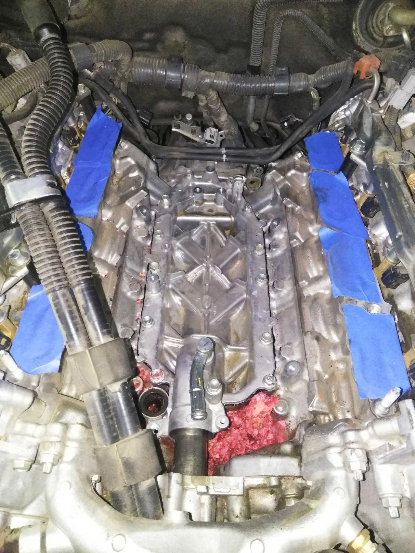

I had my first repair this week. '13 LC with 255,000 miles. I had a coolant leak "in the valley", and had to get it repaired. No visible leaks or issues. Truck temperature gauge spiked last week when driving at low speed (<30 mph). Temperature returned to normal at highway speed. Checked fluid levels after cooled down. Overflow tank was nearly empty and could not see any coolant in radiator. I added about 2 quarts of water in order to get back home safely.
Took it to the shop this week and they found the leak. Water pump still looked solid; no evidence of issues there. Hoses looked good. They tore it apart and found it.
Repair was about $880.

Did they say exactly where the leak was? The valley cover? The pipe that connects it to the pump?
Also, did you do any coolant exchanges on your way to that high mileage?
Not the connecting pipe. It was the seal/gasket around the valley plate.
