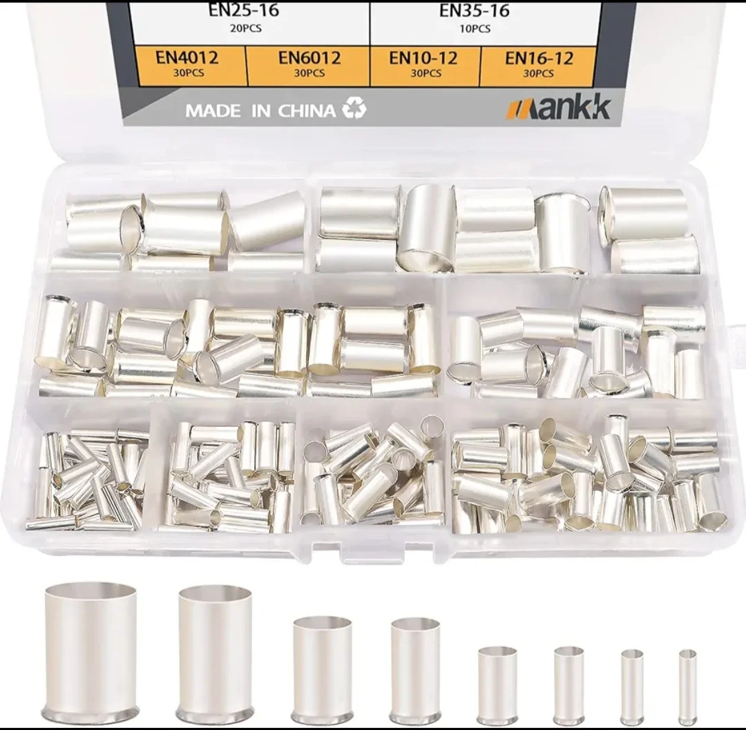

I tried using terminals that use allen head grub screws to secure the cable. ( typically sold for car audio systems)
I found them close to useless. There's not enough surface area clamping the cable. Unless you crimped on a ferule first maybe, but then, you may as well crimp on an eyelet

Agreed, but what eyelet (lug) can fit through the hole so I can tighten down the grub screw? Appears that the lead is 2 AWG, but I can't confirm.
Something like this crimped on first. Gives you a solid surface to clamp down onto.
But then you need a suitable crimping tool . . .
