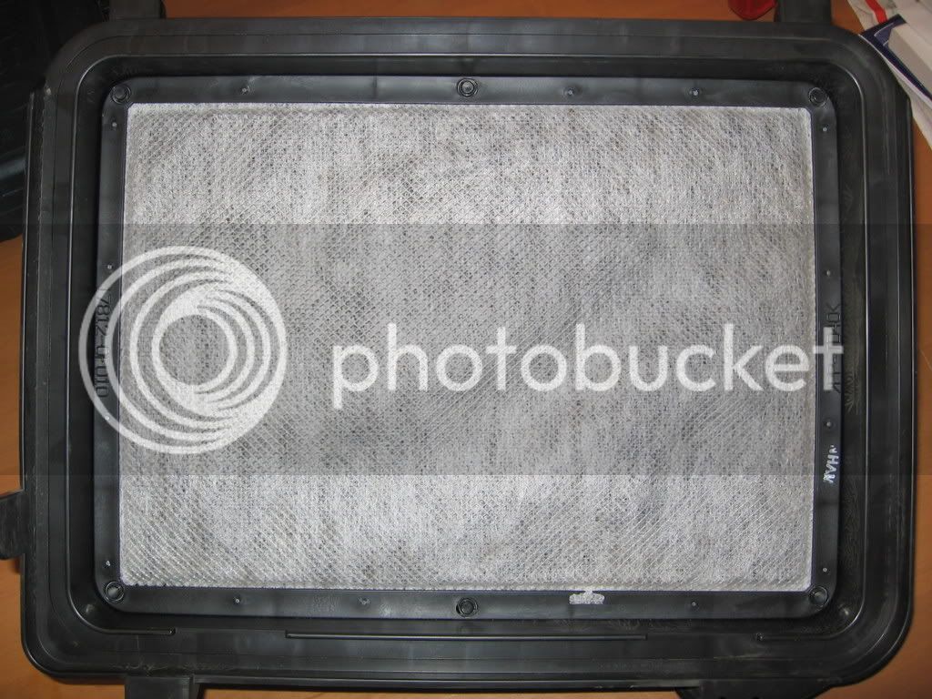

It is held in by 6 or 8 little plastic posts that have the tips melted to hold the element to the top of the box. I simply slipped a flat-head screw driver between the box and the element and just popped it loose at each little plastic stud then removed it. I put it away to keep it for later, just in case.

It's the exact size and shape as the OEM paper filter, but it's only 1/4" thick. It is comprised of some type of synthetic fibrous filter media that is sandwiched in a net "mesh" with a plastic ring around the outside. I have it at home - I'll try to snap some pics this evening.
The OEM paper filter is the primary element in removing dirt/debris from the intake. This is a non-replacable secondary element that keeps any of the paper filter from being sucked into the intake in case a mouse gets in the airbox and chews a hole in the paper, like one did in my 2000 UZJ about a year ago. :D
IS this it?
See my pic? Is that what you are talking about?

This is a charcoal filter on newer vehicles. When you shut-off your engine, there are residual fumes that travel up the intake manifold. This filter captures those fumes. It may or may not make a performance different but surely, it doesn't help airflow.
For those who live in strict smog areas, a thorough smog tech might spot the removal of this filter.
As hoser said, that's something else. This is inside the LID to the paper filter box. When you lift the lid, you cannot see the MAF because there is another element in the way, but this one is "permanently" mounted to the lid and is not servicable. Mine is now in my garage. :D
Actually, Andy, I was talking about the part you removed. I have not seen one in a 100 yet but I have the additional charcoal filter in my '08 BMW.
Does the part you removed look like this? This is from a 2nd gen Tacoma.
BINGO. That's it.
