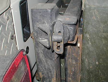

mods finished
finally "finished" the metal work. Paint is just temporary to keep it from rusting until I can rhino and paint the whole thing to match the 40. I tried using a seam sealer on the areas I didn't weld....what a mistake. I put it on late and the day and it froze overnight causing horrible results. Oh well....I'm going to strip the whole thing down to paint anyway and I'll just fix it then.

Mine are adjustable and from Grainger. About $13 each....says they hold like 650lbs each...whatever. They snap tightly closed and even "draw" the sides in just a bit as they do so. No rattles that I have found and easy to replace if damaged. I need to get off my butt and get this painted since the rattle paint bothers me so much. It's just cold outside... :(
