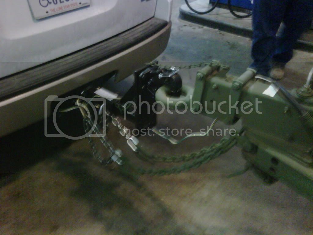

I've got a friend who just bought an M101A3 for his 80-Series. I'll see if he's got any pics yet. We towed it 8-9hrs back from Oklahoma with his wife's Explorer and that SUV looked like a half-scale tow vehicle doing it, lol.
Again, I'll see if he's got pics yet with the 80. :cheers:

The body-on-frame Explorer is Class III-capable (500 tongue weight / 5000lbs towing), but their's had a Class II hitch (250/2500). We had planned to take my FJ for the trip, but then he decided to take his wife and daughter. We ended up with a 2"-to-3" adapter with a pintle hitch bolted to 12" riser. I had my reservations, but it worked fine and the trailer wasn't loaded.
The tranny downshifted everytime we hit an upward incline, but overall it was a pleasant towing experience. I think he said we got 15-17mpg at 60-65mph with that 4.0L V6.
