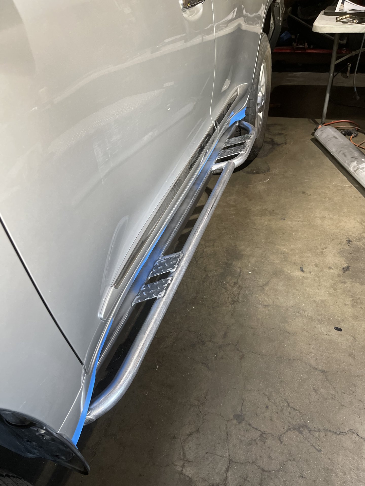

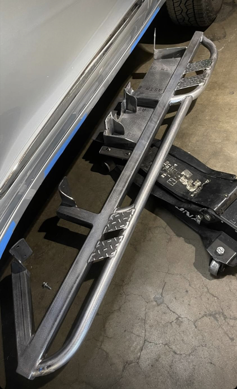

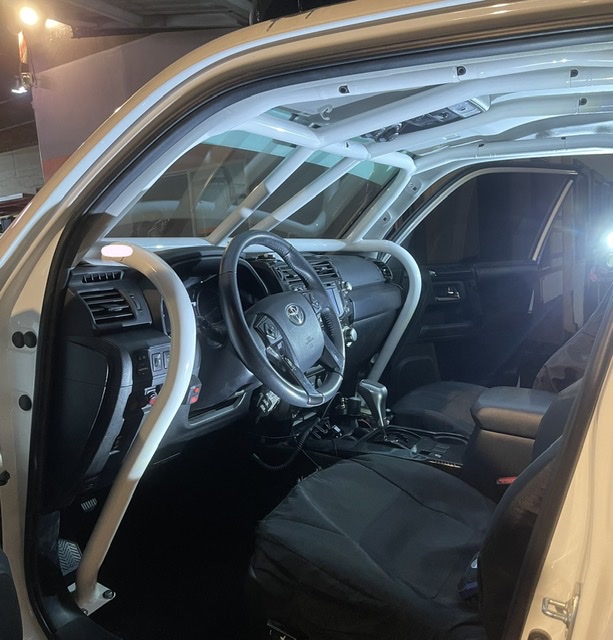

It’s a go now! As expected, the challenge is the leg placement. Well, we figured out a design that’ll work around the ahc system and keep the globe protection in place! It’ll be bolted on to the frame. In the mean time, here’s one rad project 🤘🏽anybody wants a roll caGe? Lol

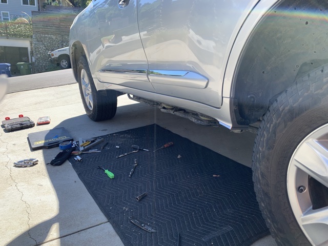

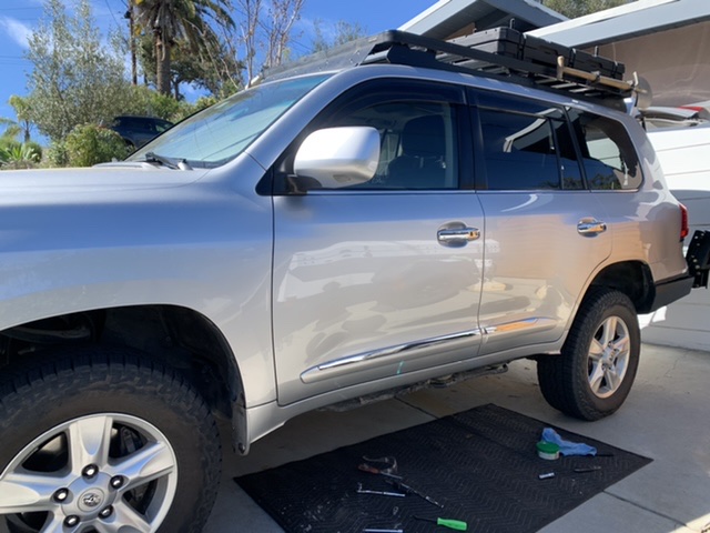

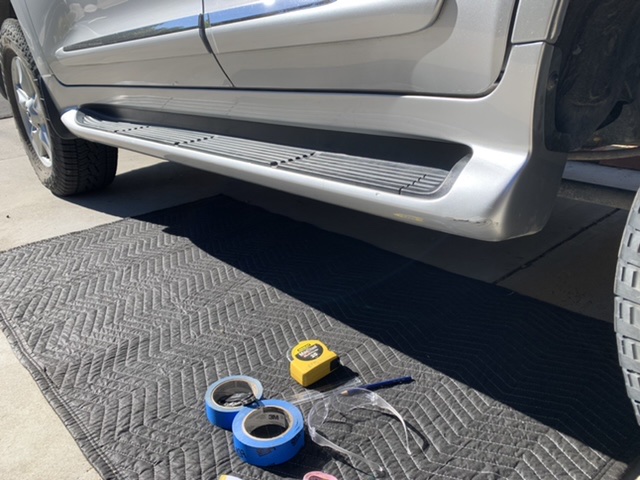

Removing the running boards is straight forward. Remove the splash guard then mark guide lines for the cut. I recommend using utility knife for a clean cut. Once you're done with cutting, unbolt the supporting legs, then start popping the rocker panel tabs that hold the running board.
It’s a go now! As expected, the challenge is the leg placement. Well, we figured out a design that’ll work around the ahc system and keep the globe protection in place! It’ll be bolted on to the frame. In the mean time, here’s one rad project 🤘🏽anybody wants a roll caGe? LolView attachment 2928910
Don't trust your life with that "cage".

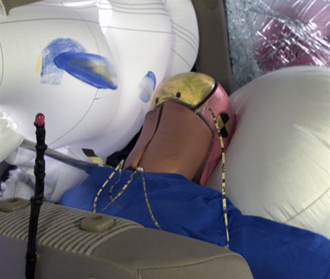

Not sure about LC…….but the older vehicles with the older design airbags, in a front collision, your head tends to slide off the depolyed airbag (from steering wheel and/or front dash) to the side……where those wonderfully-placed grab handles! And i assume that you would need to remove the side curtain airbags too. And lack of side airbags will remove the last protection of your head from sliding off the front airbags.
This is the 4runner:
See how the head is sliding off the airbag? It is only by the side airbag that prevented the head from sliding completely off the airbag and hitting the A-pillar/glass……or in your case, those beefy rollcage bars. In other words, for older vehicles like our LC, it is imperative to have side curtain airbags intact in a frontal collision (not just side collision) because it is what keeps our head on the front deploying airbags!
Removing the running boards is straight forward. Remove the splash guard then mark guide lines for the cut. I recommend using utility knife for a clean cut. Once you're done with cutting, unbolt the supporting legs, then start popping the rocker panel tabs that hold the running board.View attachment 2931061View attachment 2931063
Does it come with a cutting template for the OEM running board?

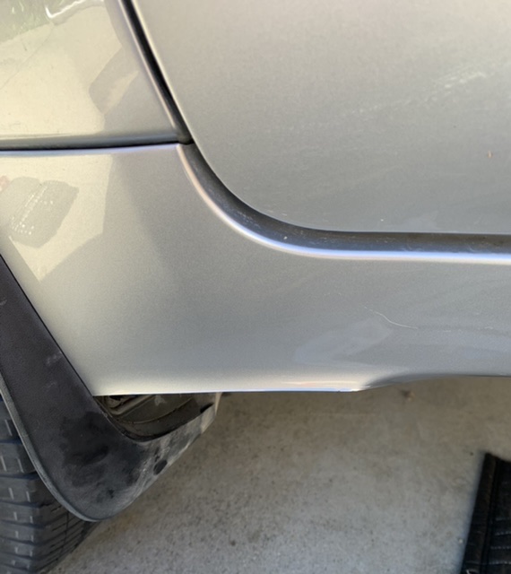

I just followed the contour to my liking. Look closely to where it starts to curve and just follow the line.
This took some detail work, making sure it matches the other side.
I finally got a chance to test fit the sliders today. Looking at the photo, it doesn’t seem complicated but there was a lot of back and forth thoughtful discussion on the mounting design. Finishing up the light tabs and off to powder coating
