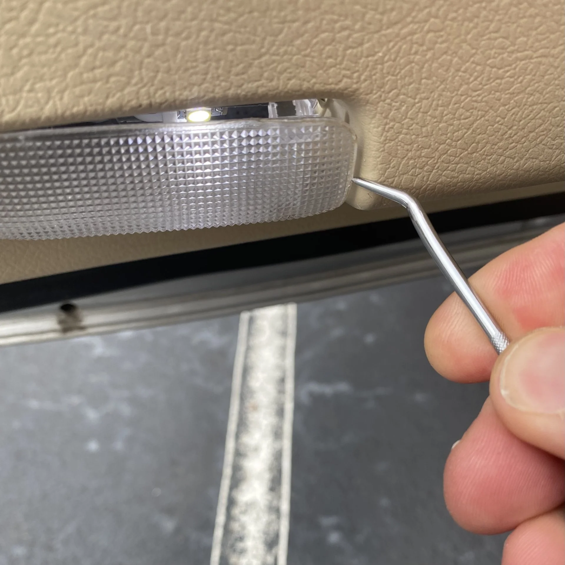

To not be totally useless, here’s a pic I took for someone else on how to get to the puddle light bulbs in the door.

Nice little tool!!! I was using a small screwdriver with tape over it lol
Can vouch for little tools like that. Got this kit off amazon and it's surprisingly good for misc items like those stubborn clips in the engine bay and other interior items.
