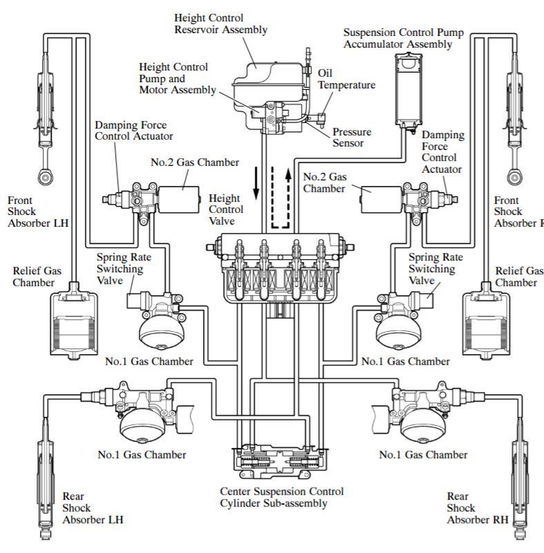

Where are the Rest of them? I see 4 globes, 1 large heigh control cylinder, and that’s it. The rest of the system is a pump and shocks. Is all the calving/solenoids in those main components?
Fsm shows two small accumulators on front corners and one small at back corners. They are high pressure, and yes, the valve opens the path to low or high, not sure about both. I’m not sure if I got the pdf onto my build thread when I was looking at it last fall.

There are an additional six accumulators on the LX570 beyond what I sourced above. There are a total of three each side in the front, and two each side in the back.
Here's the part numbers
Front (per side)
49041-60030 Accumulator sub-assembly, front suspension control No. 1
49147-60010 Accumulator front suspension control No. 2
49141-60020 Accumulator front suspension control
Rear (per side)
49158-60010 Accumulator rear suspension control No. 3
49151-60020 Accumulator rear suspension control
I'm in $600 on the four 60020 parts, so I'll roll those and see how it goes.
Also for those installing at home, make sure to pick up four 49156-60030 Suspension control back-up ring. each install takes two o-rings, and the 60020s come with one. At least mine did.
Torque on the 60020s is 111 ft lb. Use the bolt head which is on the top of the accumulator.
