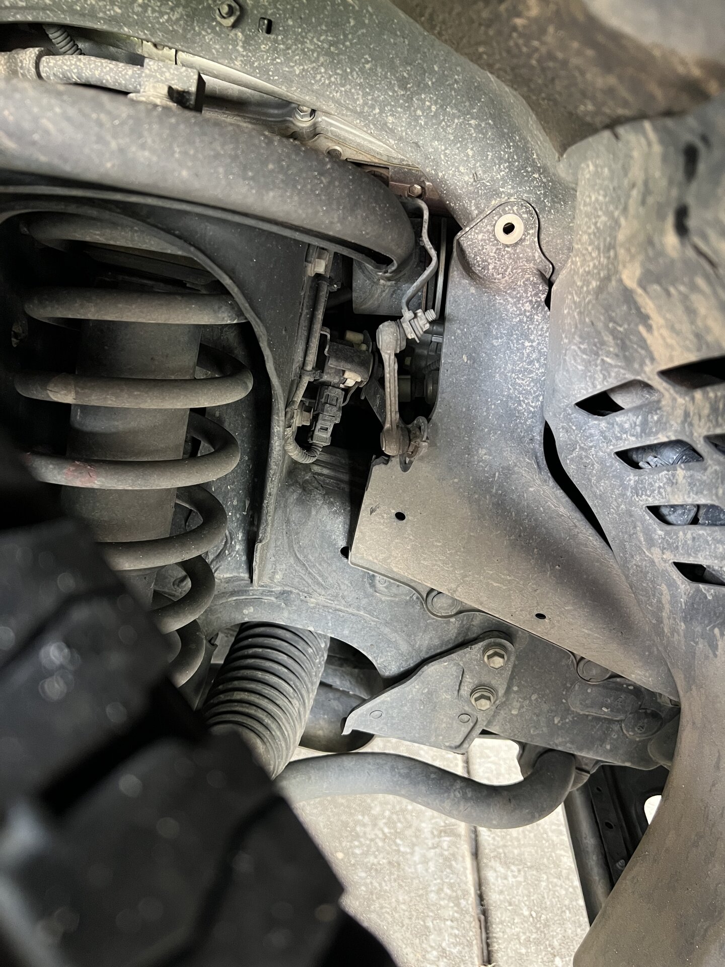

I was getting ready to do a sensor lift the other day when I noticed my front right sensor assembly was bent. I bent it back to approximately its original position, but I have no idea how or when it happened. It’s a 2014 that I bought in January. Any ideas on what could have caused this?
Holy carp! Had to look at mine to see how tweaked your bracket is! Looks like it was pulled downward somehow. Somewhere amongst this thread or another is someone who fabricated a longer bracket to increase the sensor lift. Might look into that unless it’s not an issue after fixing it?
