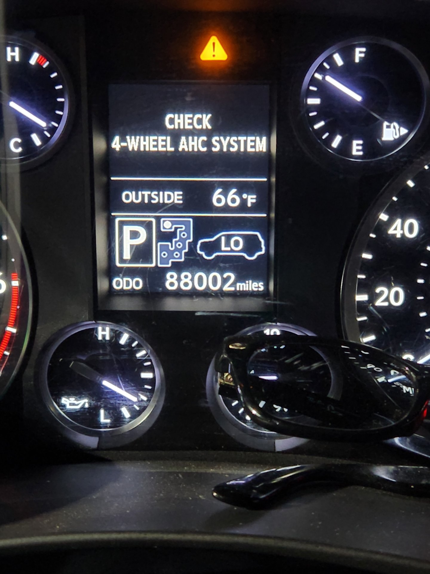

There is a dash light showing : Check 4 wheel AHC.
I was bleeding the front driver side. The first bled was fine. I started the car and it raised up. The second time I bled it, the pump kept going and stop after it tried and it didnt raised the car. Then the light showing Check 4 Wheel AHC.
I tried to bleed the 5th accumulator next to the resonator until it stop bleed, the pump kept trying and nothing.
What can I do to fix this issue?
After a restart, do you get the check AHC light?
Did you make sure your reservoir tank isn’t out of fluid? Are you using fluid from plastic cans, if so did you check it for clumpy gel?
Might try to do some repeated restarts while changing height to N before the system completes a self check, assuming the answer to above is that the fluid you added was good.
If you can get it to pass a self check without failing after a restart, I’d try driving it around for a while. If everything is still in working order it will eventually level out. If you want to have a better idea what is happening, check techstream, or get OBD Fusion and monitor AHC with that.
I can see you threw your glasses off in frustration lol.
I've had this happen after and a bleed and for me the trick was always to press the height switch as soon as I turned the key on, before the engine finished turning over, before the check runs. That starts the pump running right away.
Hope that helps.
Hope that helps.
Hahaha..
I tried that too and it didn't work
I had the check AHC message when I first did mine too. I didn't want to deal with it and let it sit overnight. The message was gone the next day.
You might try doing it 10-12 times before giving up on that tactic. I've had to do it multiple times before to get enough pressure to build up so it won't trip on the self test.
When you get the AHC alert, is it immediately after start up (2-3 sec), or after the pump runs for a while (30 sec)?
The Pump starts after about 3 seconds when I started the engine. The pump automatically starts. It sounded louder than normal.
Pump ran about 30 secs before it stopped and post the warning check 4 wheel ahc
tell us more about your fluid cans and if the reservoir ever ran out or close to out during bleeding
After verifying fluid is all good and plenty of it, you may try making sure the fill cover is removed when starting. I've had issues where the check valve would starve the pump because air doesn't fill in behind the fluid removed from the reservoir.
