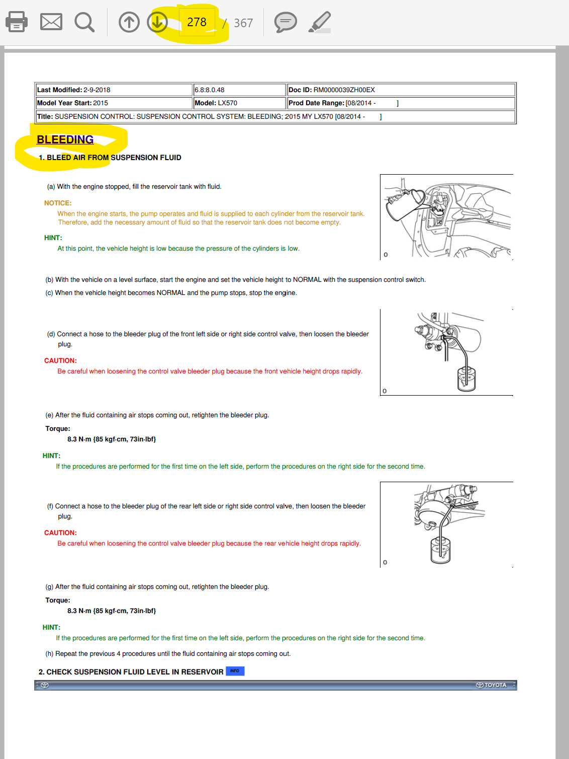

Thanks all, actually I am in the process of fighting South Bay Lexus in Torrance, because the AHC fluid service I asked for according to them only includes draining the AHC reservoir and adding new fluid into the reservoir even though I asked for a flush and compared it to bleeding a brake system.
The Service Manager wants me to provide the dealer shop section that shows the bleeding process (Pretty sure he assumes I won't do it)
Anyway I should of just spent the few hours of research to drain and replace the fluid myself. Lesson learned. I am attempting to A) Get a full refund, around $375 or B) Ask nicely to have the service done. I even have texts of the Service Advisor confirming it will be a flush.
page 278 of the document i linked earlier...

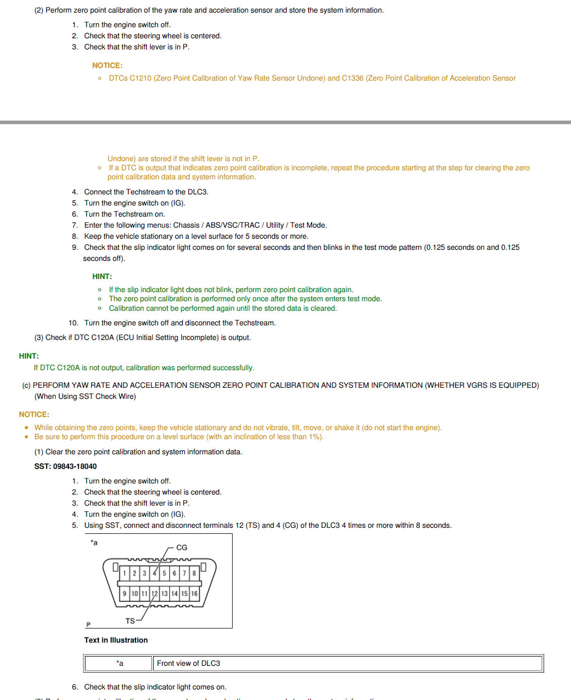

Anyways, I thought it wouldn't hurt to conduct a calibration of the VSC system and a height adjustment calibration. I found the most level parking lot in the area and measured the vehicle height multiple times to ensure it was correct. Per the FSM, front height offset is spec'd at 101mm +/-8mm, my FL was 103 and FR was 106. Rear height offset is spec'd at 94mm +/-8mm, my RL was 94mm and RR was 90mm. I probably could have adjusted the sensors a bit more to get it a little bit closer to level, but they were within spec. I used those measurements for the height adjustment calibration and I figured the truck now knew where it was sitting at all four corners. Calibrating the VSC system was simple, just follow the instructions in the FSM. Below is the data list after adjusting and calibrating.
After completing those two simple tasks, all of my above symptoms went away. As you can see, left to right height is much more even and the Back&Forth G sensor is zero'd out. I've cycled the system dozens of times since doing this, and everything works as it should, but even smoother and faster. I have yet to experience any of my previous symptoms since doing this, and I'm comfortable with call these issues resolved.

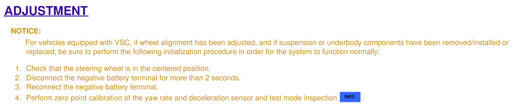

What is the procedure for calibrating the VSC?
Thanks, @radman . Going to try my luck using Techstream (which I just got and still learning).

Did the jumper reset. Started her up and the lean was reduced by .5". I slightly adjuster the sensor lift on one side and she appears to be riding level(er) but I wanted to drive around a bit before measuring. Fingers crossed this will eliminate my gangsta lean and the excessive wear I am getting on my front tires.
