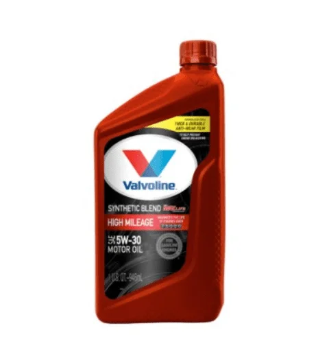

Depends on the number of oil leaks. When I buy one with leaking front or rear main seals, they get Valvoline High Mileage Syn-Blend (Red Bottle) until I can stop the bleeding. I've used it to clean up and slow some leaky messes until I can take the right corrective action.
