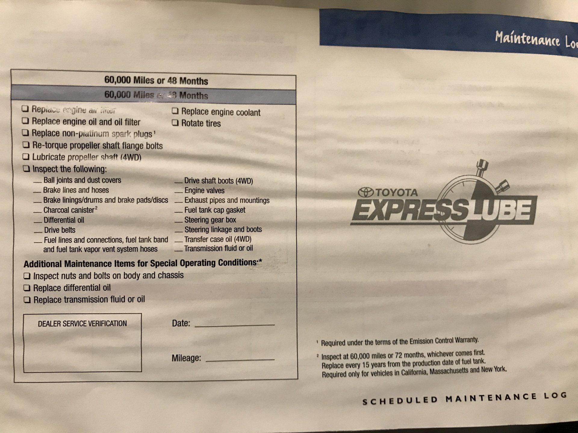

“Lubricate propeller shaft (4WD)” first appears in the Toyota maintenance log book at 5k and reoccurrs every 5k thereafter, which is kind of on par with every oil change depending on if you run conventional or synthetic. Also, this is dependent upon whether you follow the 5k, 7.5k, or 15k service intervals (the 15k interval coincides with the 5k & 7k intervals). On a side note, does anyone actually "Re-torque propeller shaft flange bolts" which appears at every service interval??
Also diff and tranny fluid are recommending to be changed every 75k. Of course that interval is determined by what Toyota calls “Special Operating Conditions”, which is obviously how you use your truck (frequent long highway trips, towing, steep mtn passes like the San Juan’s, etc..). And yes, this vehicle has stayed in the same family it’s entire life. My uncle bought it new off the lot in ‘00 to give to my aunt because they had 3 labs of their own and sometimes a 4th when they were dog sitting for my cousin. This vehicle never touched so much as a boat ramp and was the definition of a grocery getting, mall crawling, soccer mom mobile while they had it! Then my father purchased it from his brother (my uncle) and I bought it from my father.
