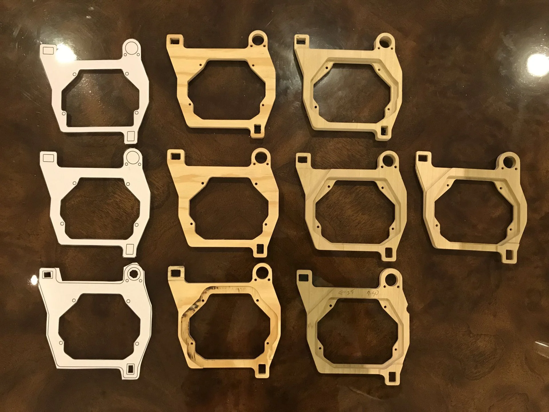

Okay, so I went to work. I made some templates out of paper first, then as I felt they were fairly on point, I started making some prototype brackets out of wood. I went through a lot of iterations, but the wood cuts fast and it was cheap. It took a lot of trial and error to get a single piece bracket that would clear everything and use all the factory hardware, but in the end, I got it.

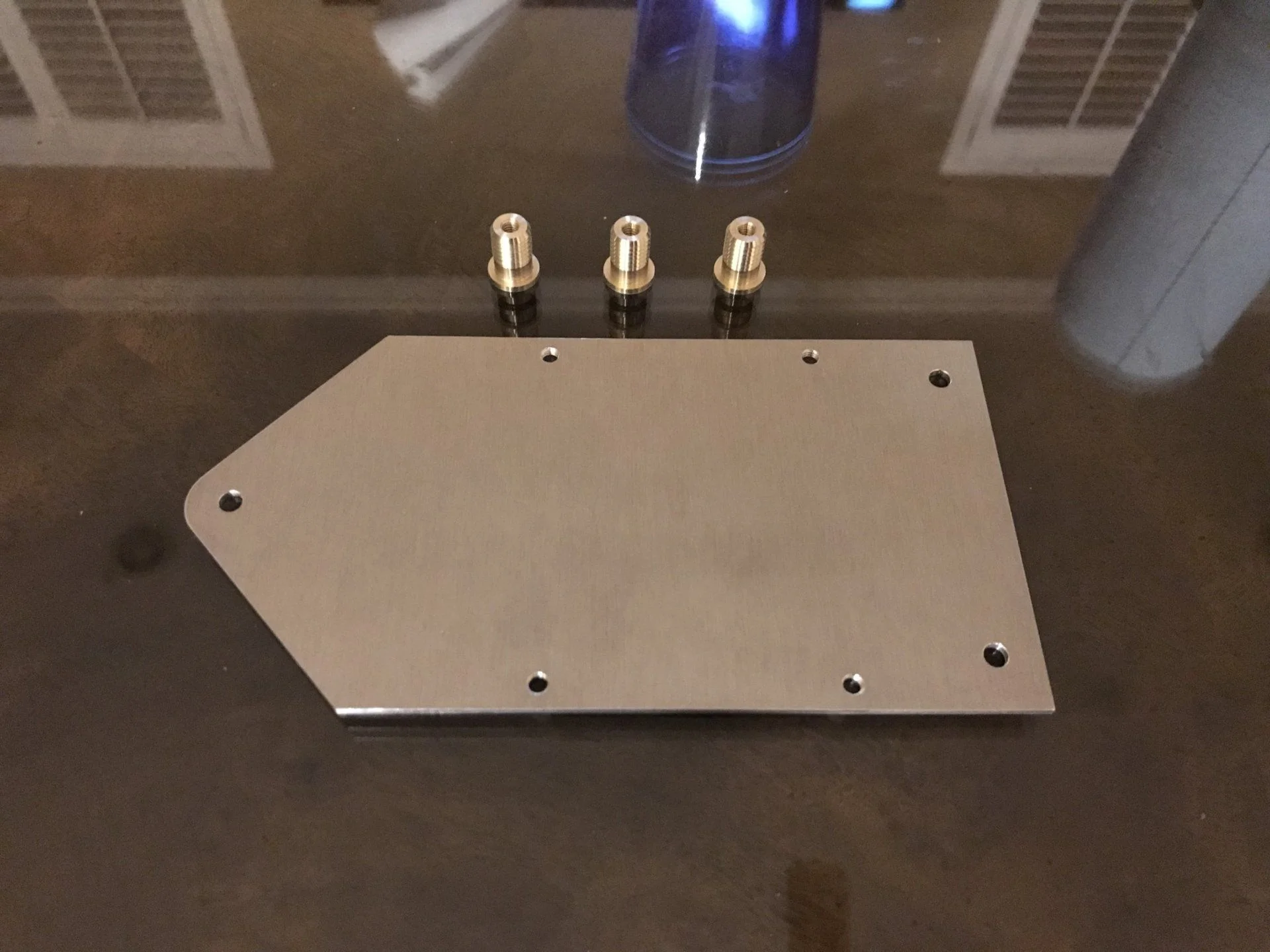

Then I decided I didn't want to mount the ballast the way everyone else was doing it. I wanted to attach it to the bottom of the headlight. So I made some brass bushings to press into the housing, and used those to attach an aluminum plate to mount the ballast to. I also didn't want to use a relay harness since I was using a 35W ballast, so I wired the ballast directly to the OEM harness.

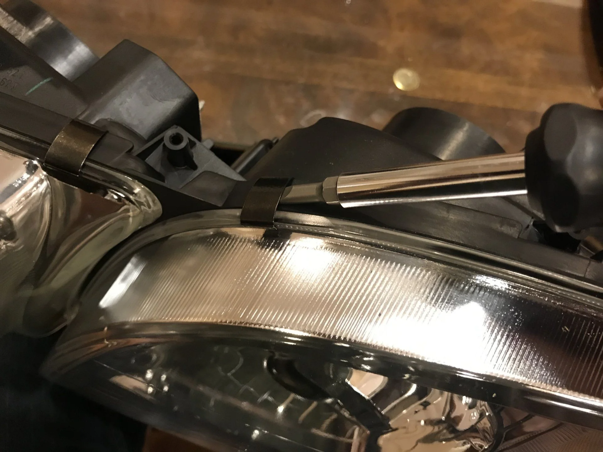

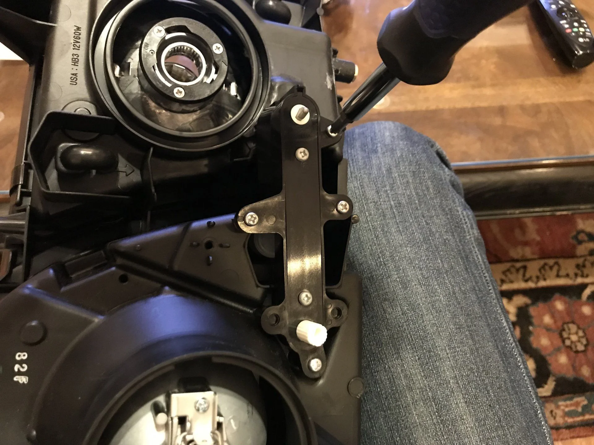

Step one, remove the vertical adjustment piece and the 4 metal clips that help secure the glass to the housing.
1903558
1903559
1903560

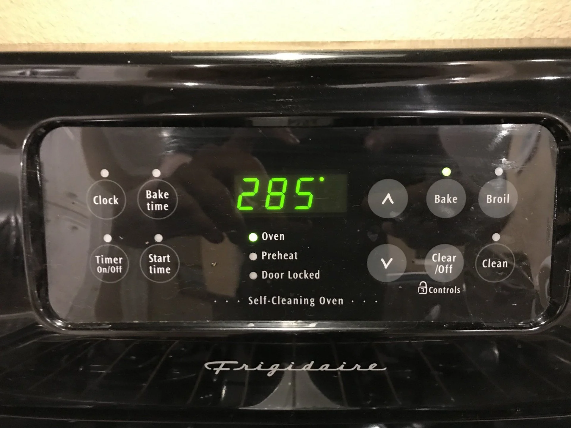

Step 2: Bake at 285 for 8 minutes. In this step I would get it mostly pulled off, but from me handling the headlight so long it would start to cool. You want to do this slowly so you don't crack the glass. I would put it back in for 4 minutes and by this time I was usually good to pull the glass all the way off. Also, as others have suggested, set the headlight on wood so the metal rack doesn't damage the plastic housings.
1903561
1903562

Step 5: Press in brass bushings
1903566
1903567

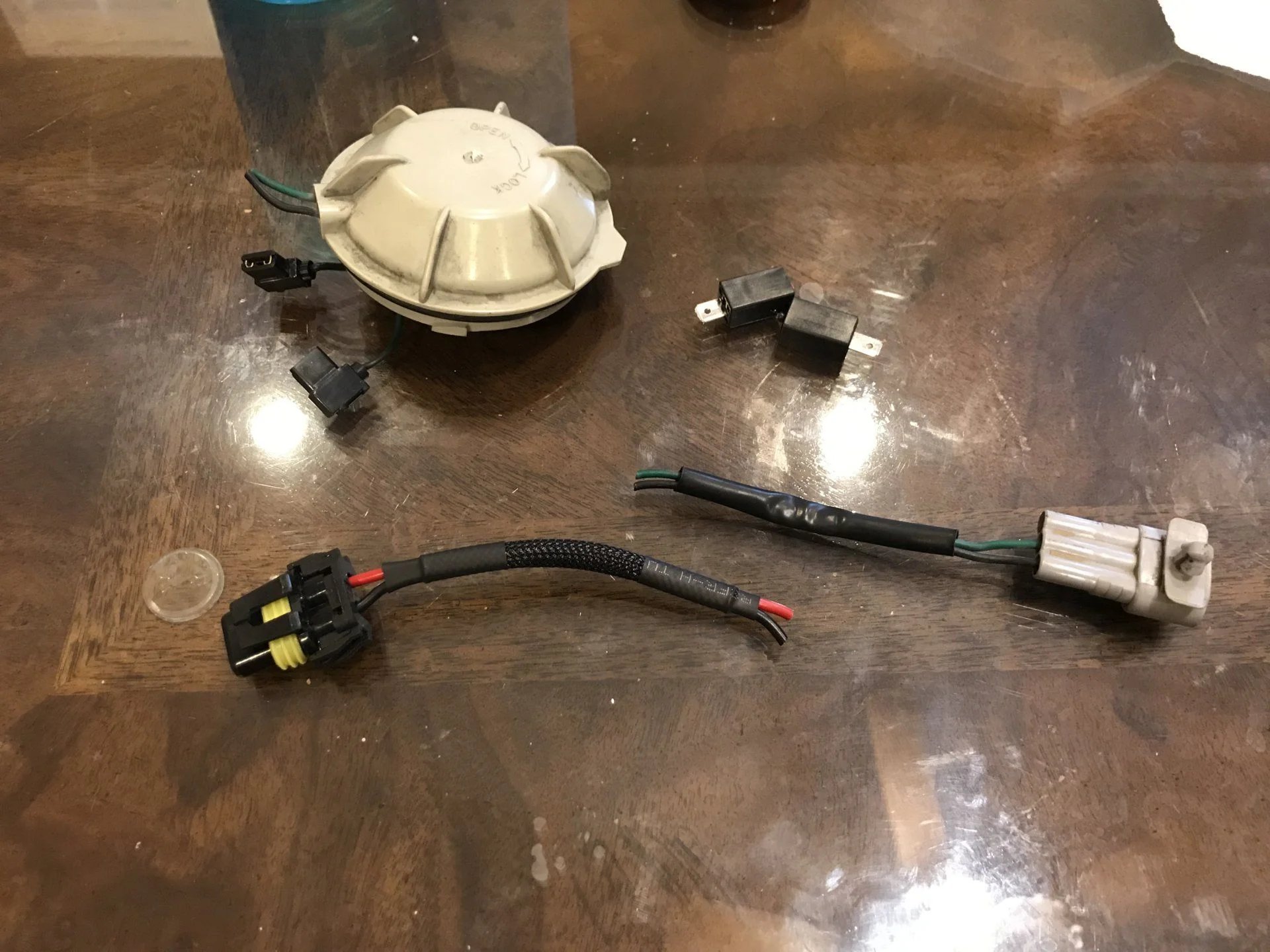

Step 8: Cut stock wire connector and the 9005 to H1 adapter wire. I spliced these together.
1903569
1903571

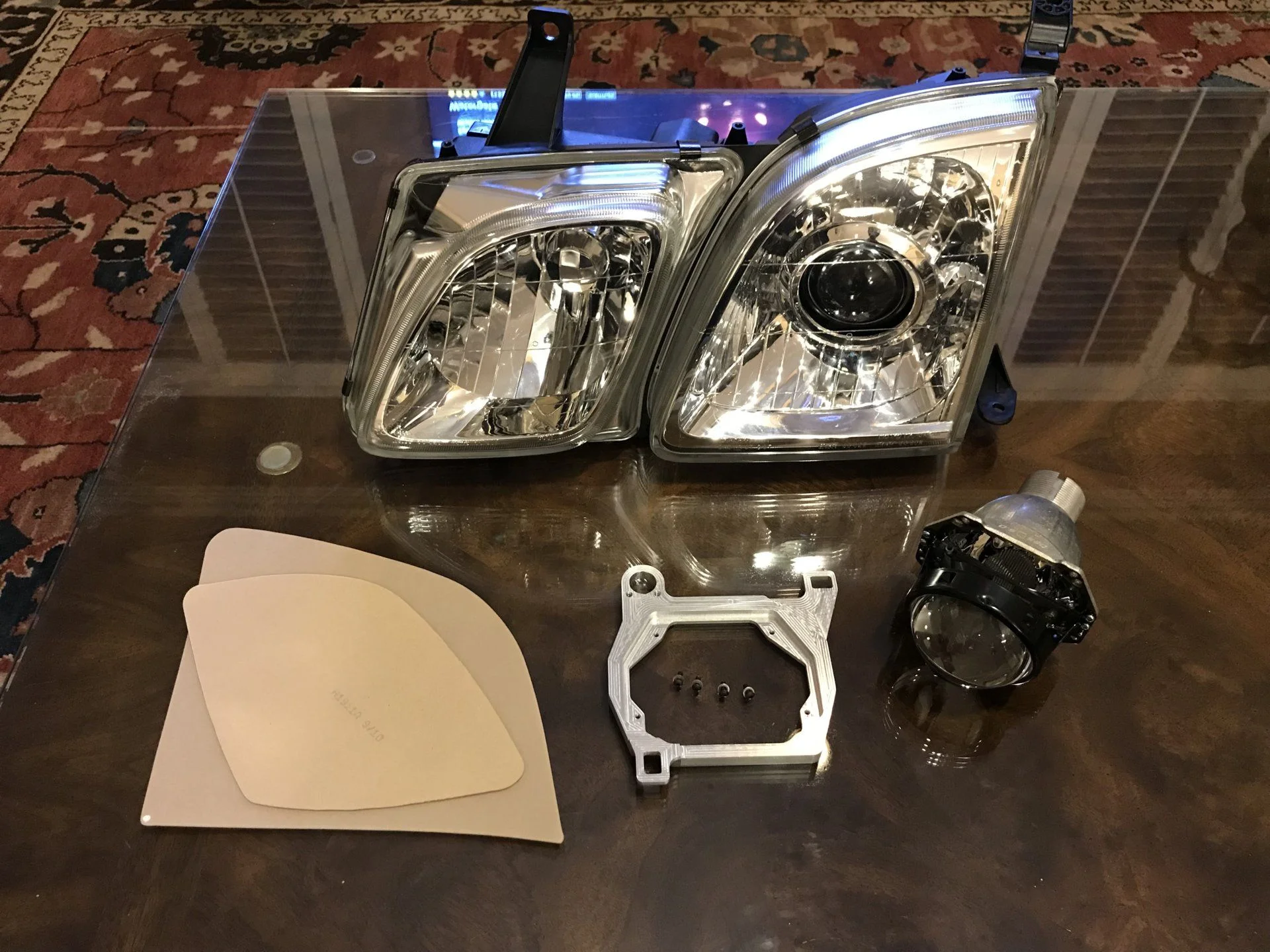

Here is a picture of the new headlights, but one has the factory projector, the other has the Morimoto one. The factory is the smaller one on the left.
1903578

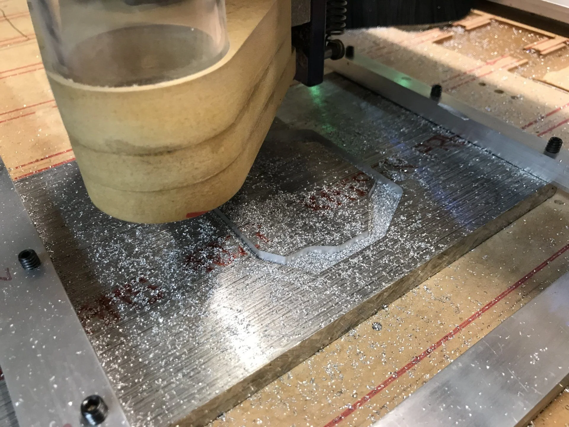

Here is some of the work that went into making the parts:
1903580
1903581
1903582

It may be possible, but I didn't experiment around with it very hard. Ask Lou he will definitely know the answer. So the bracket I made were made from a 1/2" thick piece of 6061 aluminum and the mounting surface for the projector is recessed in the bracket to allow the depth. It was also that thick to accommodate the tab on the bottom that needs to be kicked out a bit in order to work properly with the adjustment screw. I cannot recommend the glass headlights enough, simply amazing. If you get them, don't forget to get some type of film protection for them to keep them looking brand new.
Wow that looks awesome, great job on the bracket! Man what I would give to have a CNC router and lathe....gotta love big boy toys;)
Awesome job. I plan on doing this mod in the next 6 months. I already have the glass lens headlights, also the cnc router and lathe. Now I just need to get the rest of the materials and parts. I love how your projectors sit back further. I will design mine the same. Unless you will sell me your file. 😁
