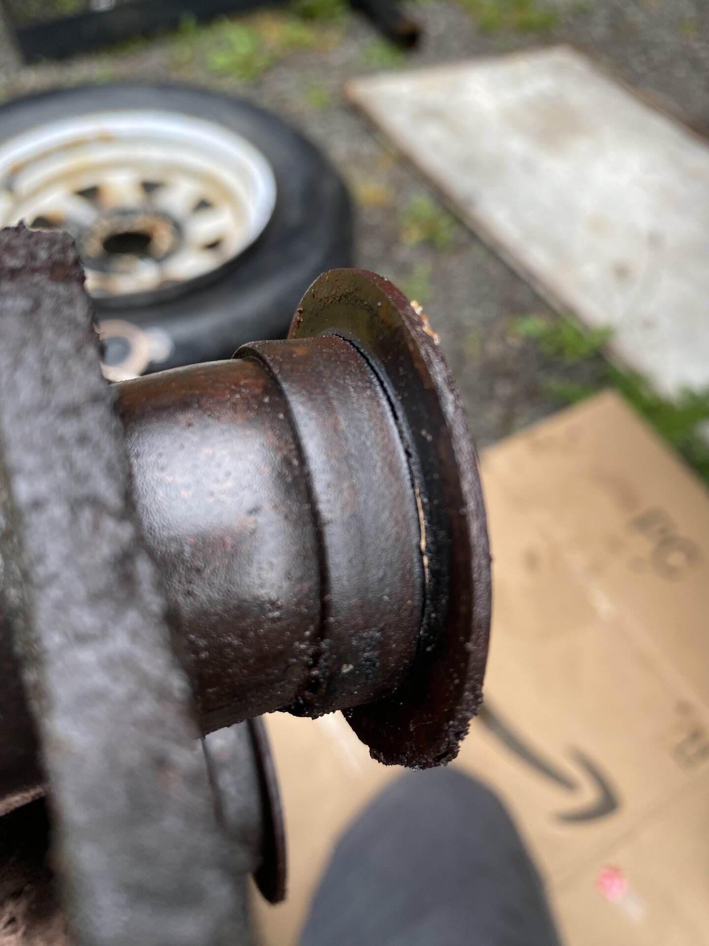

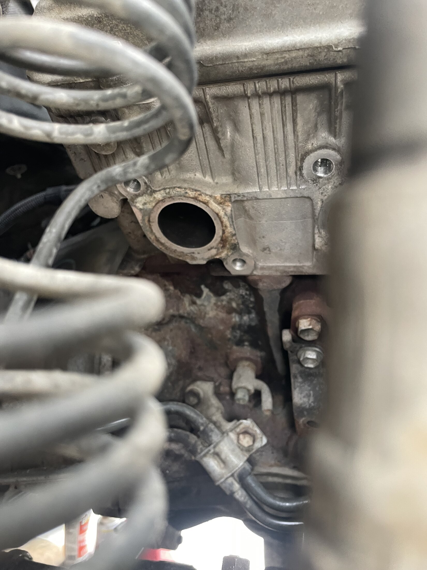

Did my drivers side today. Well, I concluded it today. All in all it’s been over a week with stud soaking and stoping myself before I made an error. Getting torque is all but impossible on a few nuts. I got them as tight as I could. Still haven’t gotten the dipstick back in. Walked away before I lost
