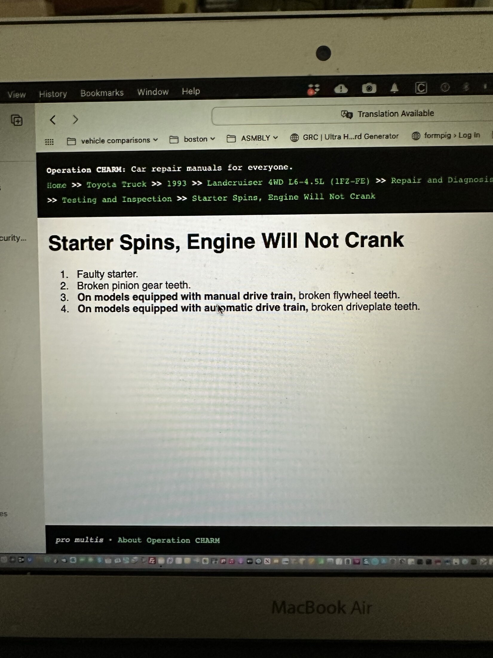

The strarter spins up, but the bendix unit is not engaging the fly wheel?
sounds like it RM. i'm always learning here so i think bendix has to do with the starter i guess or is it the solenoid?

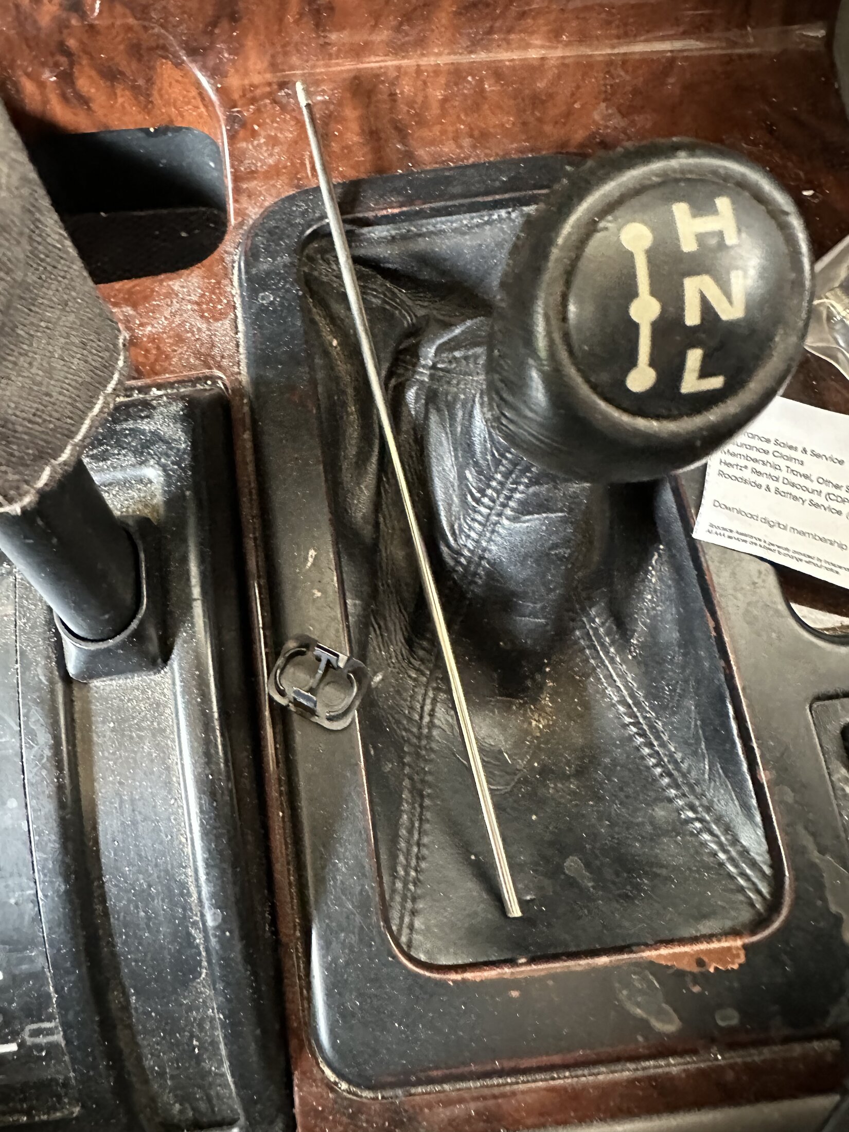

i was trying to print out the CHARM.io manual for charging and stating and i remembered that i had to pop this cap to get it into neutral at one point to try to roll it a bit to get it in some jackstands. so i started to wonder if i knocked something down there.
but i just tried it and i get the same sound with key in ON and transmission in D or N but it's locked out at all other positions so i think this is not it.

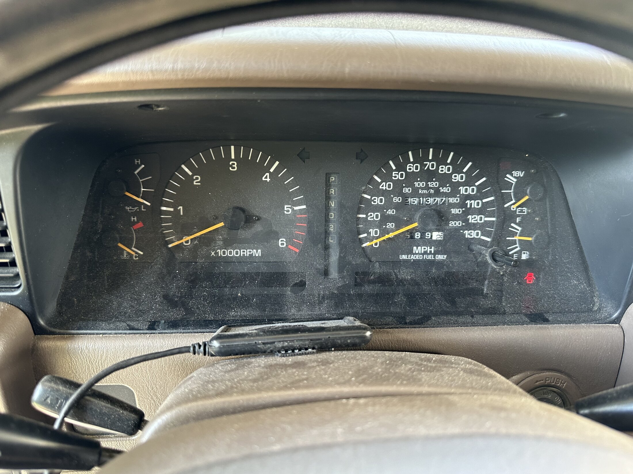

It's really hard when you aren't using the right terms to describe the problem. From your video it is definitely 'turning over'. Turning over means the engine is turning. You can hear the starter turning the motor and changing speeds as it goes around through it's cycles.
The first thing to check is, is the 'Check engine light' lit when you turn the key to the ON position? The screen that you have on the dash is covering it in your video so you can't see if it comes on or not. It should be on until the engine starts and then goes out assuming all things are normal. That eliminates all the relay, fuse and link swapping stuff.

so if i understand (i took a video) car door symbol is on when i open the door obviously and the engine symbol is in fact on when i have key in On position.
are you saying this gets me up to the engine basically?
