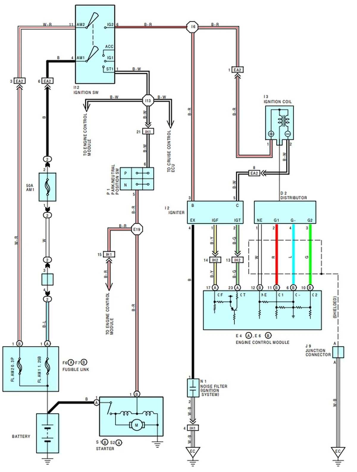

I have a 1996 LX450 that decided to stop starting up. I replaced the starter because I was having issues with it. But, that wasn't the fix. I noticed sometimes, that I have to hold the ignition key in the START position for a while before it would start. But now, it just doesn't turn over. I've checked all of the fuses and the neutral safety switch...but I'm just not too sure.
I'd GREATLY appreciate anyone's feedback on how to diagnose and solve this electrical issue.
Thanks!
Thanks Guys! And no, I no longer hear any clicks and the starter is new. I will say that I no longer see a "draw of power" as I turn the ignition switch on the battery meter. There were times when the battery meter needle would lower as I turned the ignition switch.
Check your fusible links.
Thanks... I used a 1996 Toyota Landcruiser Starting & Ignition Wiring diagram to locate the fusible links, which were fine. For some reason, I'm leaning toward diagnosing the Ignition and Park/Neutral Position Safety Switches. To AZNGARAGE recommendation; I may have to replace the ignition switch wiring harness. Again, I greatly appreciate everyone's feedback. Thanks!

Good Day! The answer to your question is No. I no longer hear a "click." And when I used to, I could also see the needle to battery gauge show to me what look like a draw of energy (needle would drop). But now, there's no clicking or energy draw. Here's something that may be of interest. Sometimes I would have to hold the ignition key in the START position for 10-15 seconds and it would start. It was as if I was energizing a glow plug or capacitor long enough to send the electrical current to engage the starter. Thanks again!

I think your starter is received signal but the your ignition switch is wore out to to the point that it doesn't send enough current to energize the start solenoid. That y when u hold the ignition long enough it would start. Before on my, it's happen when it get cold on the winter.
Good Day! Yes, I'm under the very same impression and suspect the ignition switch to be the issue. In fact, I have noticed that cold weather has been a factor. How easy was if for you to replace the ignition switch my friend?
