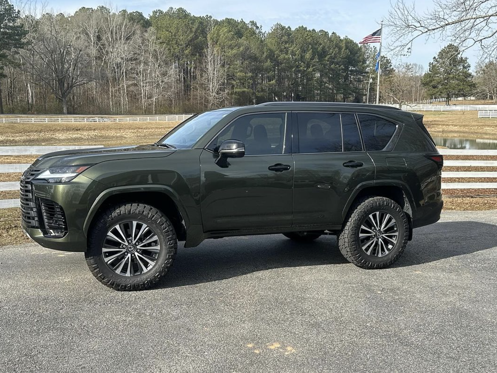

Does it look clean with it off? Or is it obvious that something has been removed. Do you have a pic of the car with them off

I just removed the running boards on my LX600 and it was both easy and in my opinion, looks better. It certainly is easier to get in and out of.
