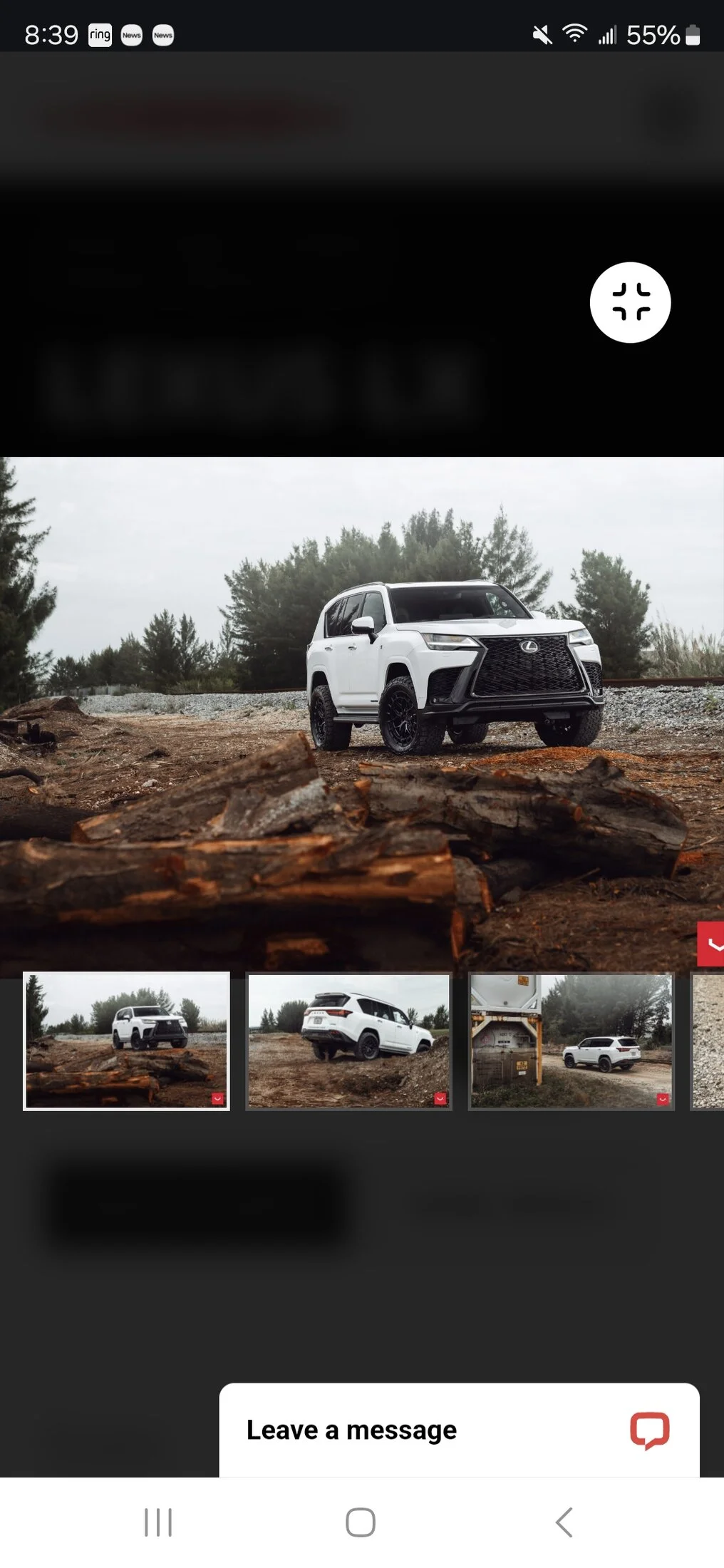

Has anyone put 295s or 305s yet on their lx? There is a white lx on the vossen website with 295 tires.

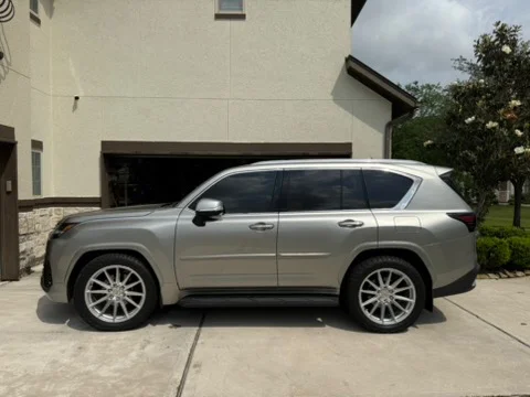

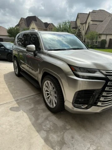

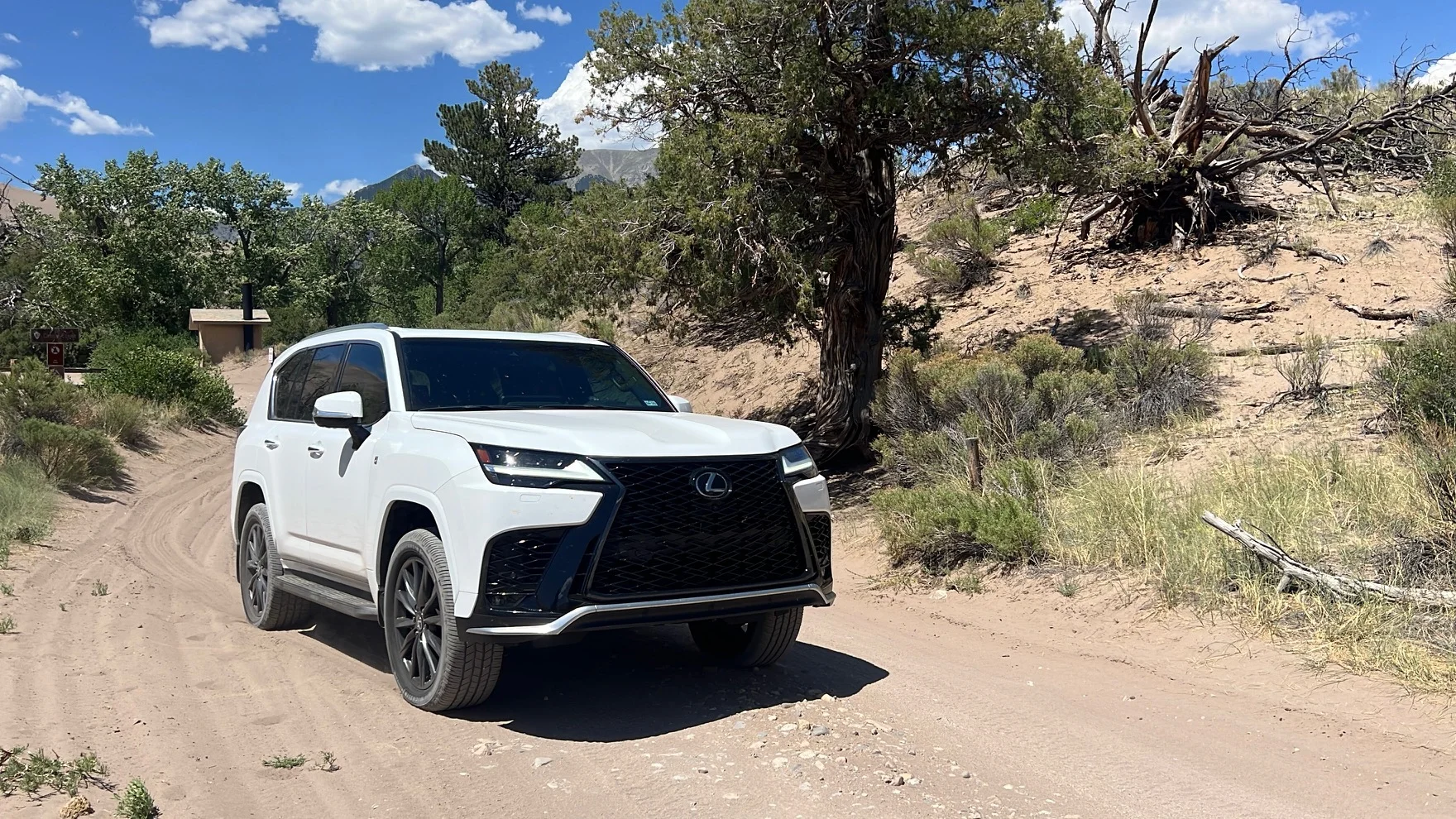

I viewed the white lx on Vossen's website and loved it also. This rig is in stays in the H1 setting and had to be slightly modified to reduce rubbing. I choose to go with the 275/50/22 on the vossen HF-1 with nitto recon grapplers. I love the way it turned out.
U had rubbing with 275s? Weird and others here no rubbing with 285s. What offset did u use? Nice lx!
Let me be clearer. My silver LX has no rubbing with the 275/50/22. When i mentioned rubbing, i was referring to the white LX on Vossen's website with the 295/60/20 set up.
295s would be smoking on the lx! 295 50 22s would be nice. Sorry I misread your post. Tired eyes
It's wasn't your fault. I could have be more clear in my initial post. I can tell you the ride quality improved with the extra rubber from the 275/50's compared to the stock 265/50's.

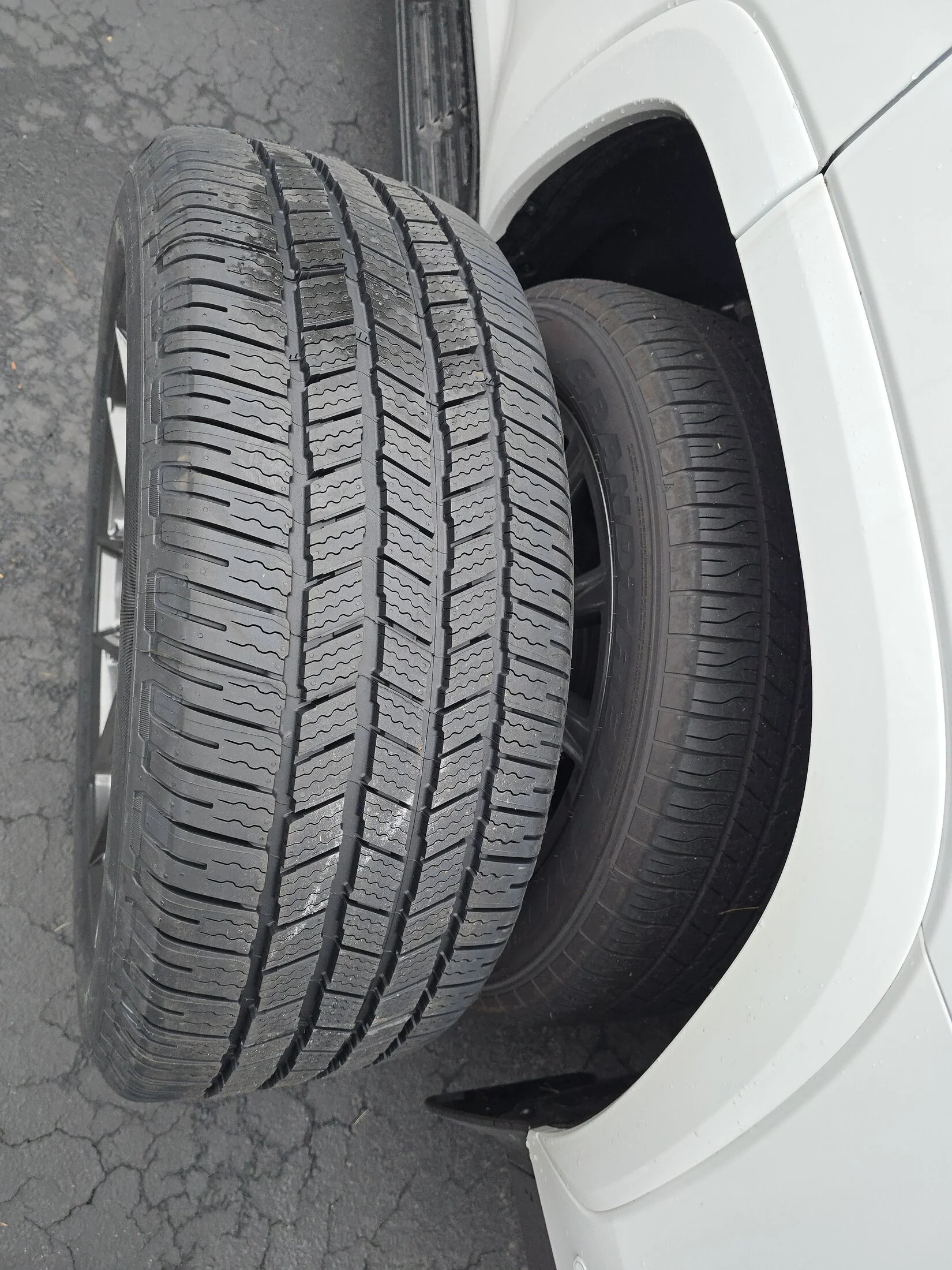

I did the same tire and size. Need to go pick them up and get them installed on my vossens. Not sure the stock rims are wide enough and dont trust the 8 inches width although tire rack says it's fine on their website.
Why not post some pics so Subliminal can see them since he asked. I am not much help there…

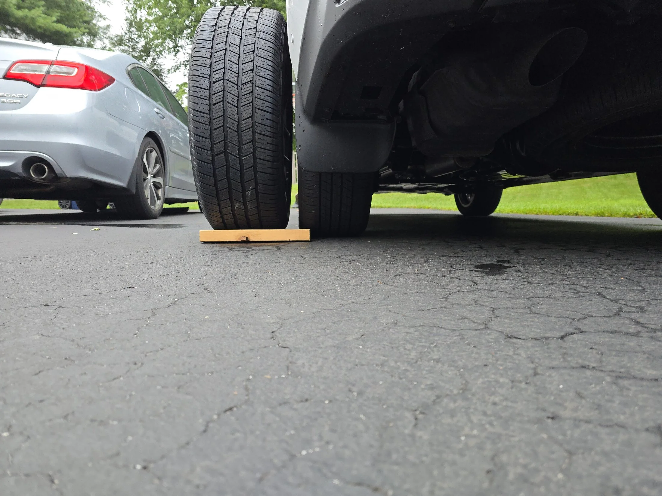

So i got my vossens 22 x 9.5 30 mm offset and michelin defenders 275 50 22 size. The wheel and tires are indeed massive and weight is about 80lbs i believe. The stock tires are just under 10 inches wide and the new 275s are 11.25 inches total width. Very big tire. Cannot imagine folks putting wider than this. Will do a trial fit tomorrow but based on info in this thread should fit nicely.
Interestly on tireracks website the 275 50 22 and 285 45 22 profile tires have same section width. Contact areas on pavement for 285 is more.
