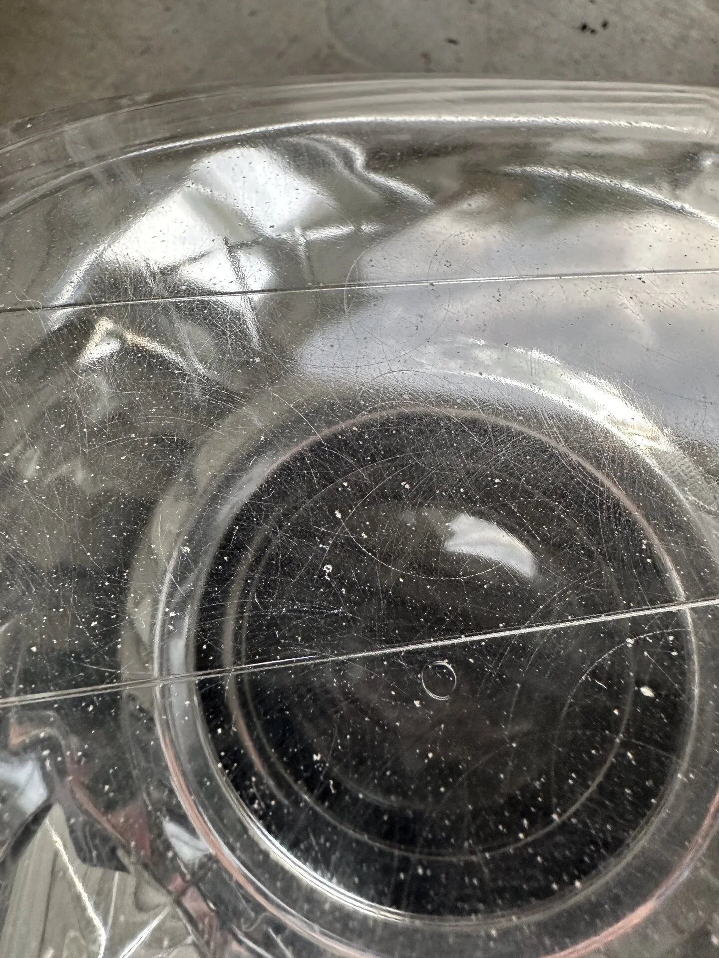

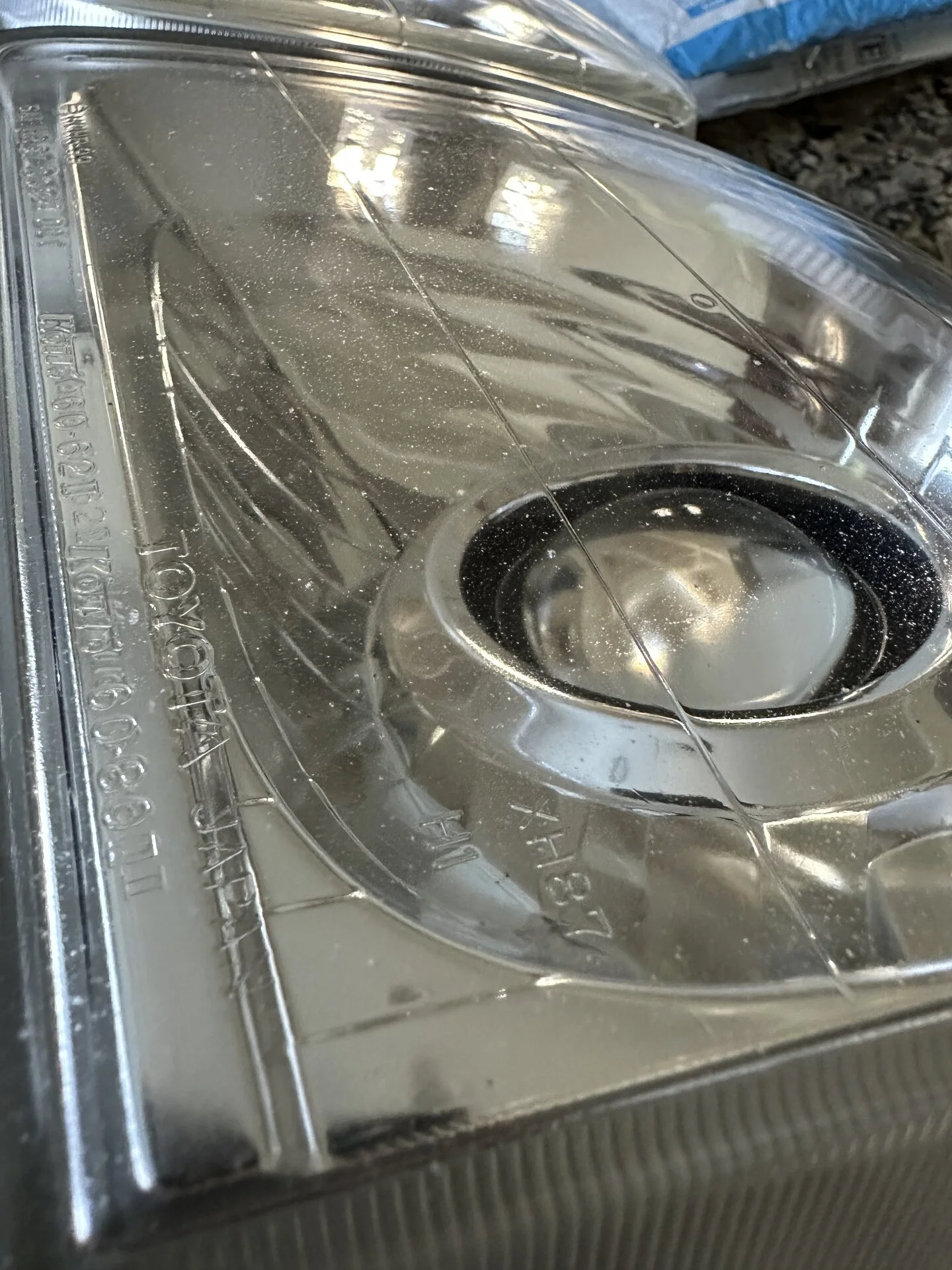

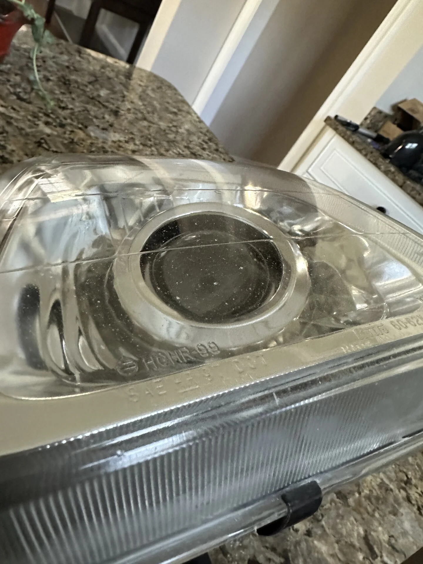

I would put some kind of protective film on them. I just picked up some used ones off eBay that were supposed to be in great condition and they have a bunch of pitting all over them. Has anyone tried sanding glass headlight lens?

Yes and never again. I used Ceriglass with an appropriate pad, very marginal improvement. As you are shaving a fine layer of glass off, glass itself becomes steaming hot and can break if you go overboard.

I tried it and I made mine worse. I watched a bunch of youtube videos on how to do it and what people used and didn't look too hard but I think the glass Toyota used is way harder than normal glass. I tired braso, toothpaste, baking soda, Scratch X, pumice hand cleaner with rubbing compound, cerium oxide powder. I used 3M wet/dry sand paper starting at 240 and working my way up to 2000 but it didn't work. Mirka Abralon is supposed to make good products for glass so I'm going to try ordering some better stuff to atleast correct the damage I did.
If you search eBay there are couple of replacement brand new polycarbonate covers you can consider. Once the glass have pitting and/or nicks, it is close to impossible getting them removed.
