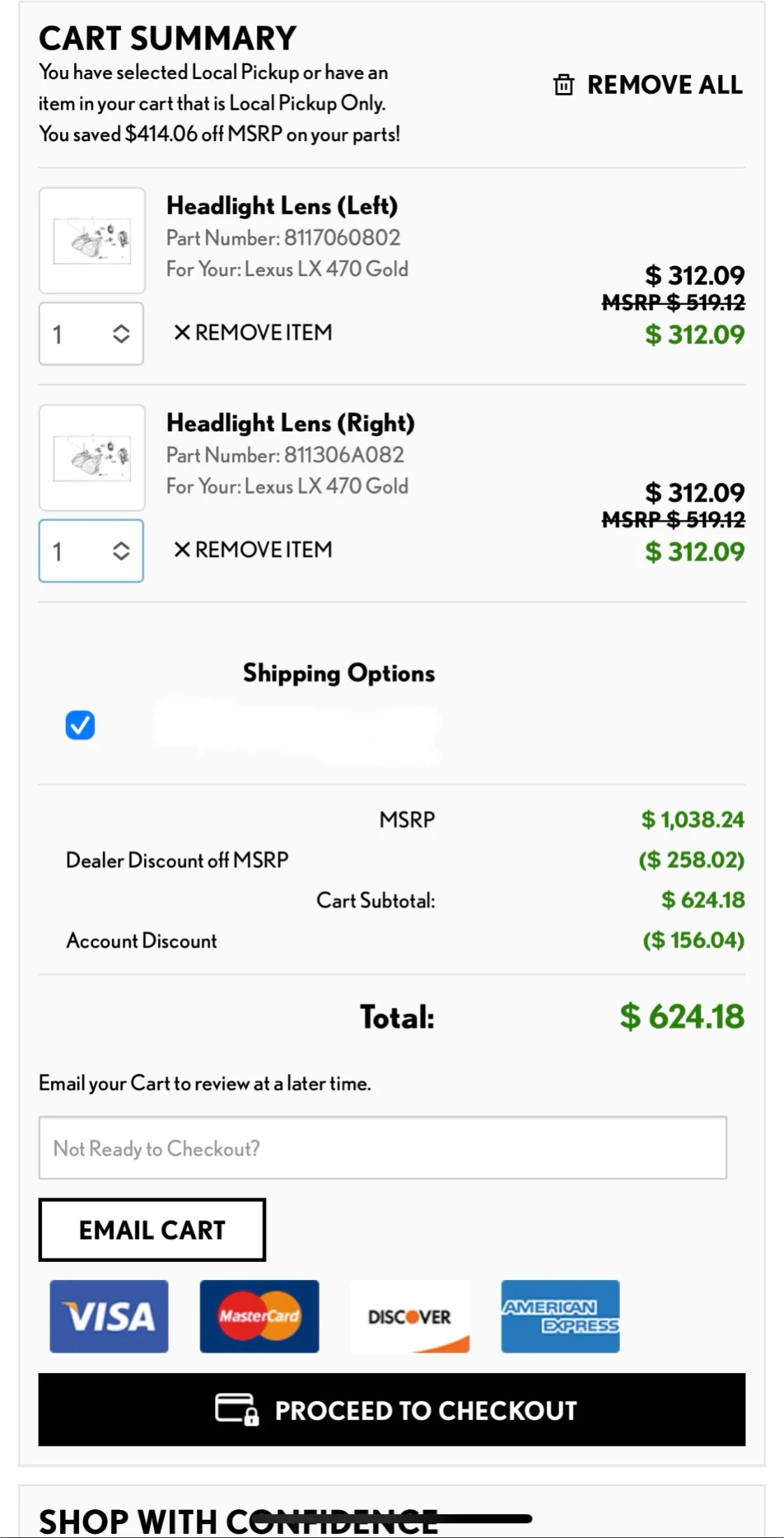

Can anyone confirm these are the correct part #’s for the left and right glass lens headlight housings?
Seems like a pretty good price.

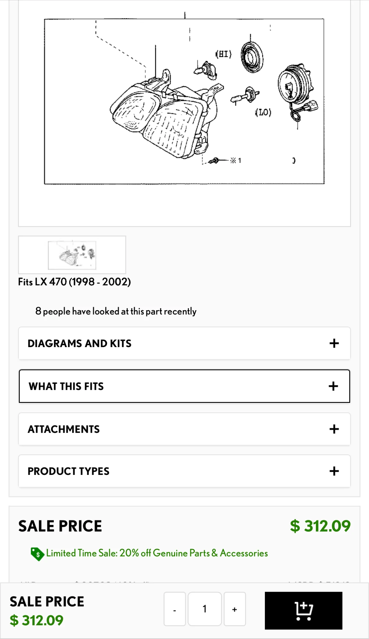

On my 00 that has factory glass lenses. PartSouq has 8117060800-01-02 listed as parts for it. The 02 being the most expensive on there and the heaviest. But its only a .016kg difference.
Same for the RH one. 811306A081-82. But for some reason the weight difference is .1kg with that one. XD
Would need to compare part numbers with a factory plastic one. Unless the hive know whether or not Toyota changed the part but not the number.
Sorry, should have included this photo before. It says 98-02, making it appear as though there’s one sku for all years.
