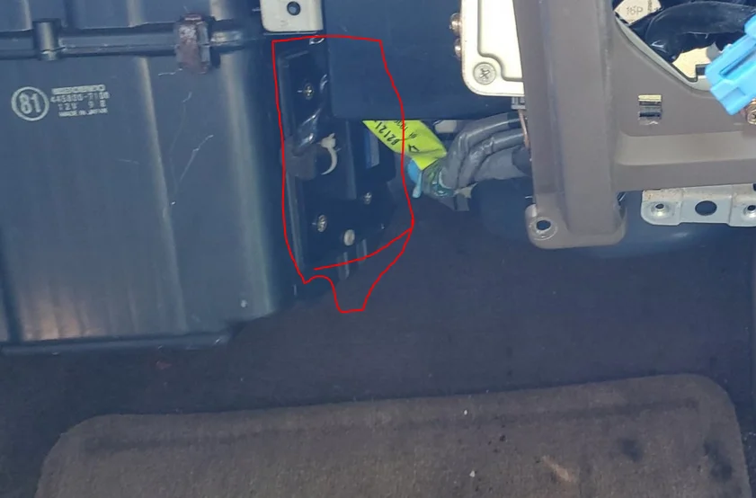

Blower Motor Resistor sounds like it might be the culprit.
Its a box that mounts to/through the front of the blower and that blower's harness is plugged into.

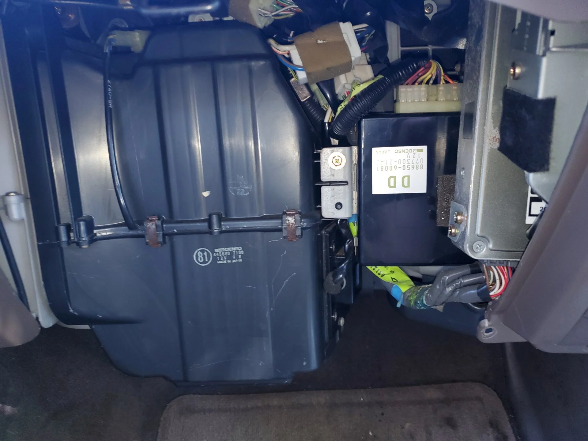

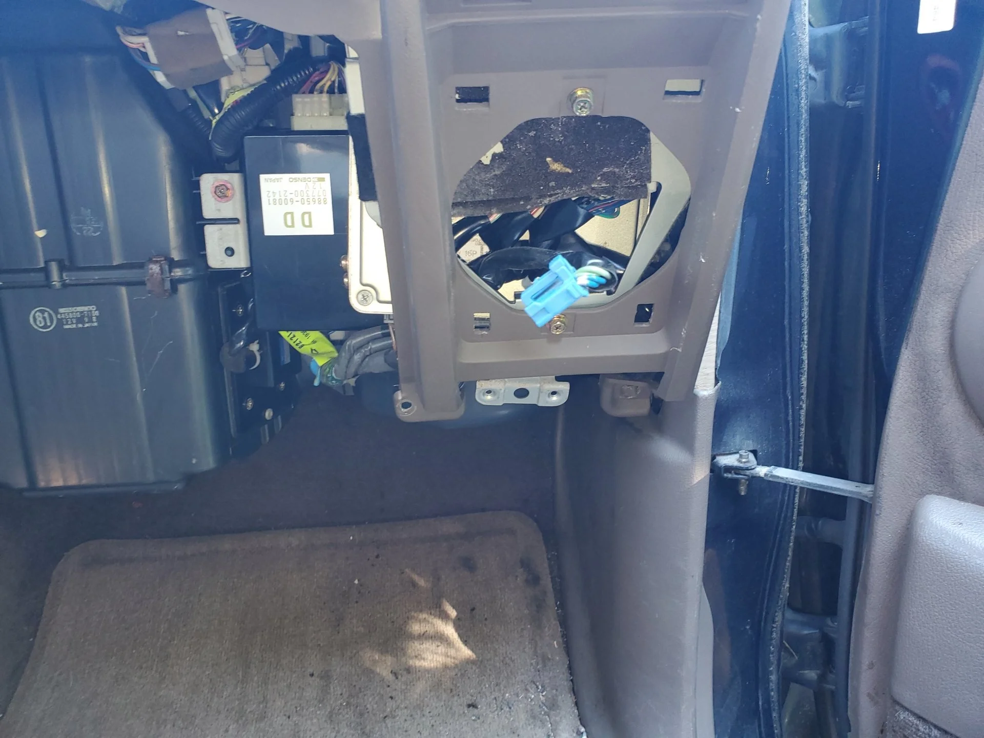

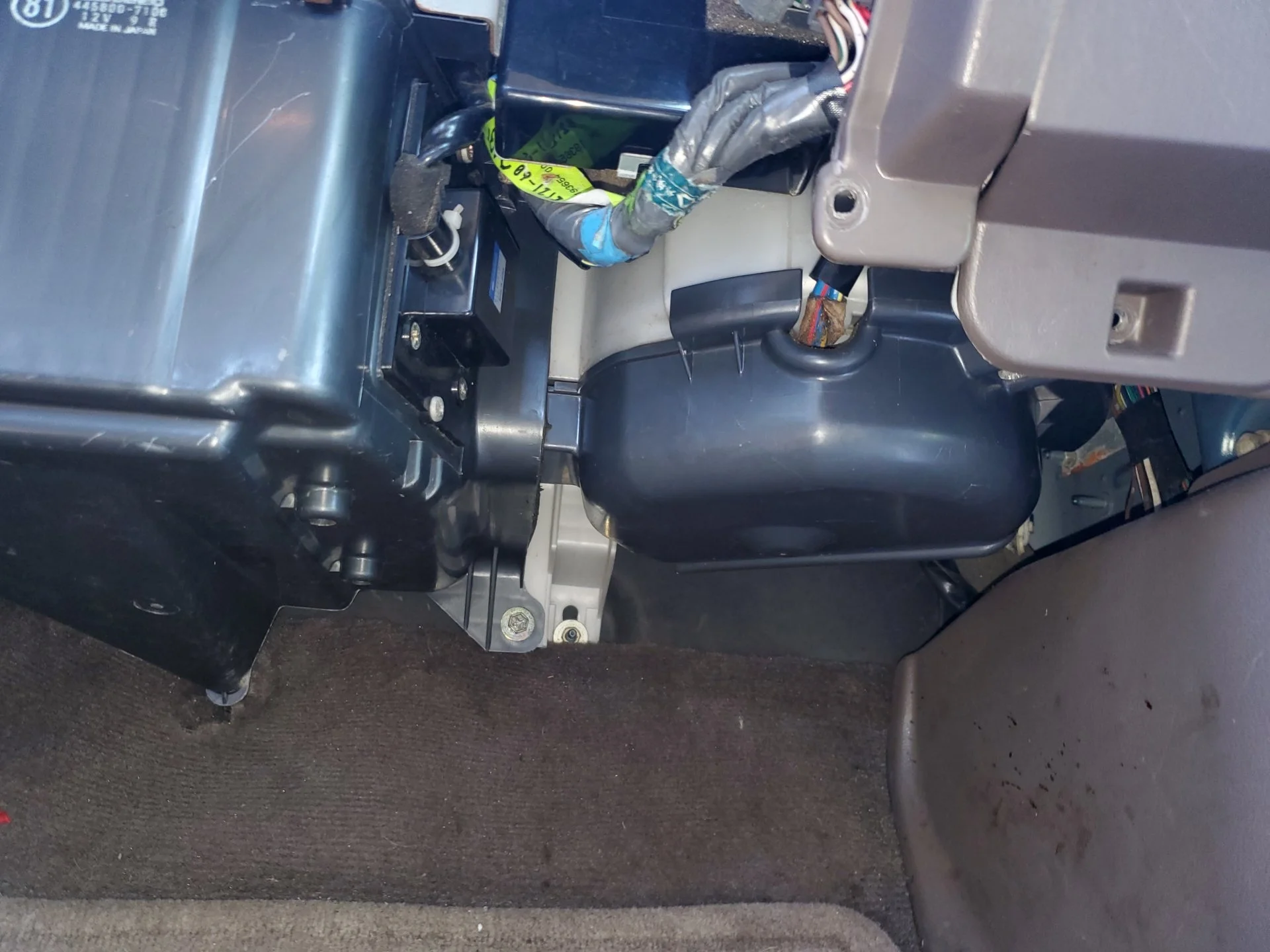

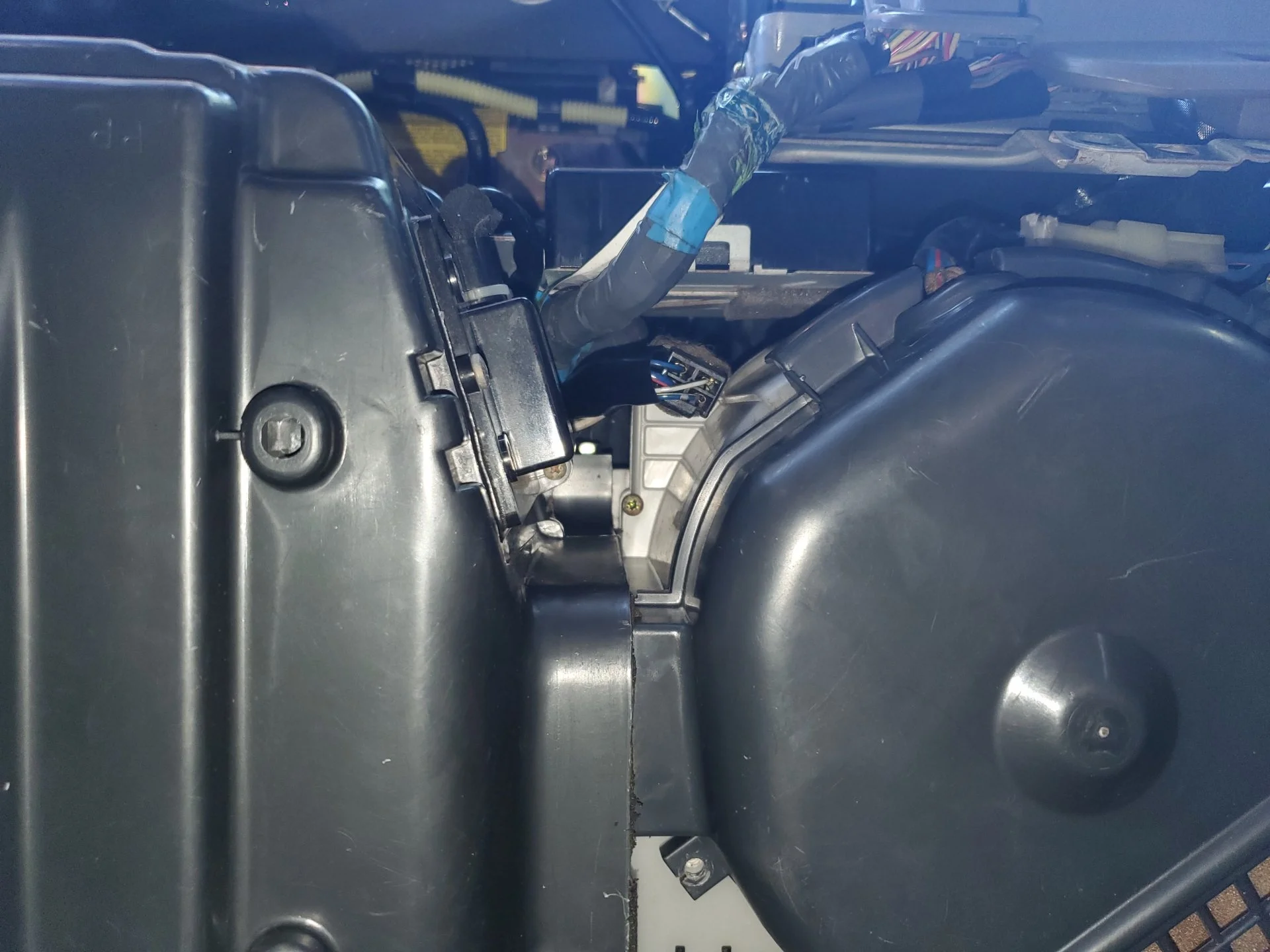

Here are three pictures of the blower motor area, could you point out where it's kinda going to be and what I should remove to access it?

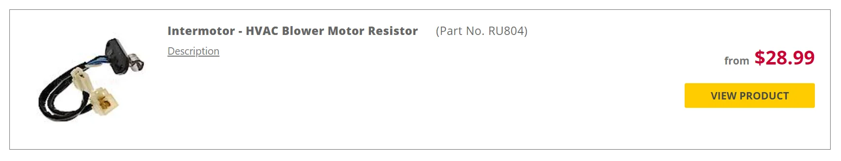

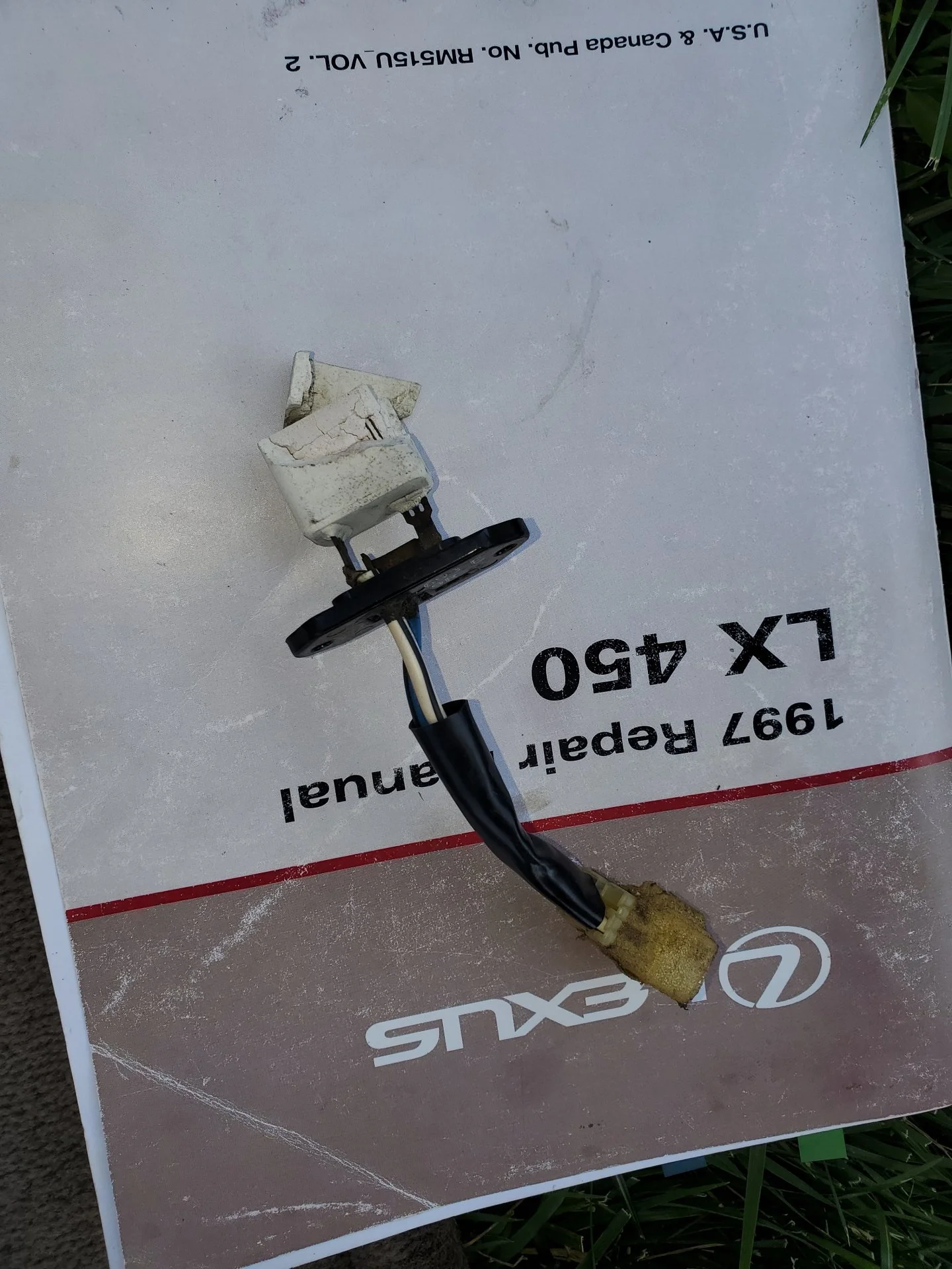

Our blower motor resistor looks like this
I was wondering where I could buy the whole resistor with the cable.
A lot of parts online look different and lexus told us that manafacturing is discontinued.
Toyota told us the part number corresponded to the 97 FJ80 anniversary edition but the part looked different.
Please let me know if you have any idea where I can find it.
Hey i was wondering if you could help me with one last thing.
The LX450 and the FZJ80 Anniversary Edition both had the automatic climate control feature that operated the blower automatically at variable speeds, which is why the resistor design and part number is different than resistors for a non-AE, 1993-1997, FZJ80. A decade ago when I was searching for a new one, I think I had to find a salvage unit. I would try Amayama, Megazip, or PartSouq first and if not, ask Cruiseryard if they have one.
