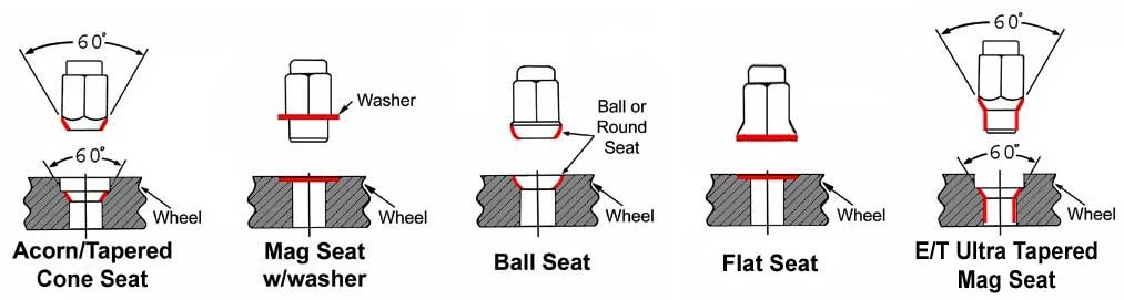

As long as the nut seat matches the wheel, it doesn't really matter. Some would feel safer with name brand, some would argue its all the same. Arguably, the only wrong choice is a hardware store hex nut or a a nut with the wrong seat type.
