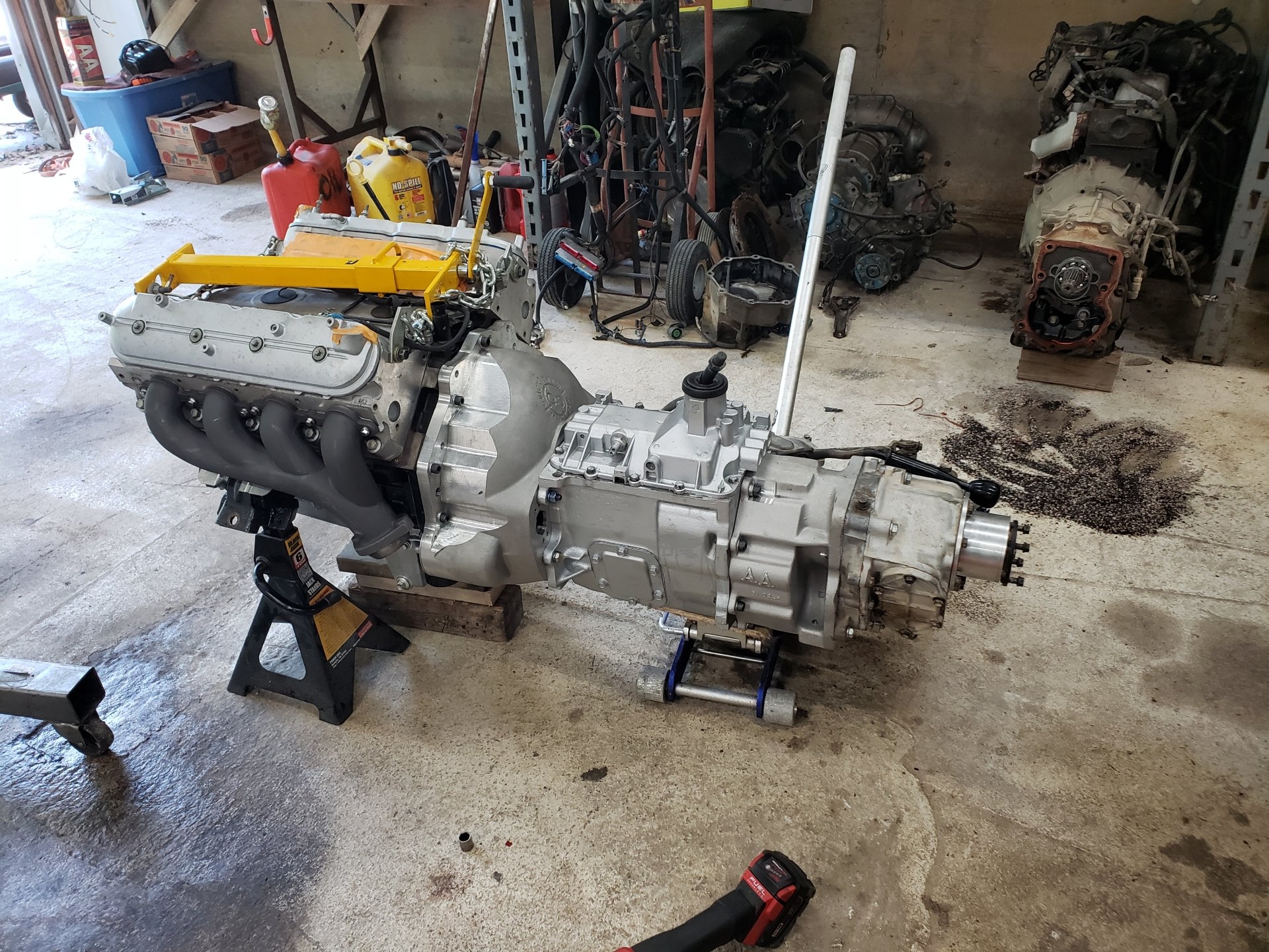

I just swung this into my 62 yesterday. NV4500. They are very stout and although the gear spread is not as "nice" as an H55 an LS V8 doesn't care. Especially an LS3. I have no love for 4L60s. If you are doing a GM engine there are 2 proven options IMHO, NV4500 or 4L80.
