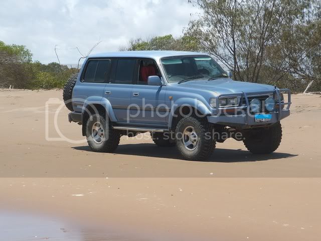

Just read the thread from start to finish & you sir , are one lucky S.O.B. If an engine swap was on the cards for mine, I would either have a 1hdft or the LS3.
Love the colour on the truck. We don't get that colour down here in Australia. My bus is due for a respray this year & because my factory colour is a bit unique I'll stck with it, but if I was to change colours, yours would be at the top of the list.
Cheers, Mike.
