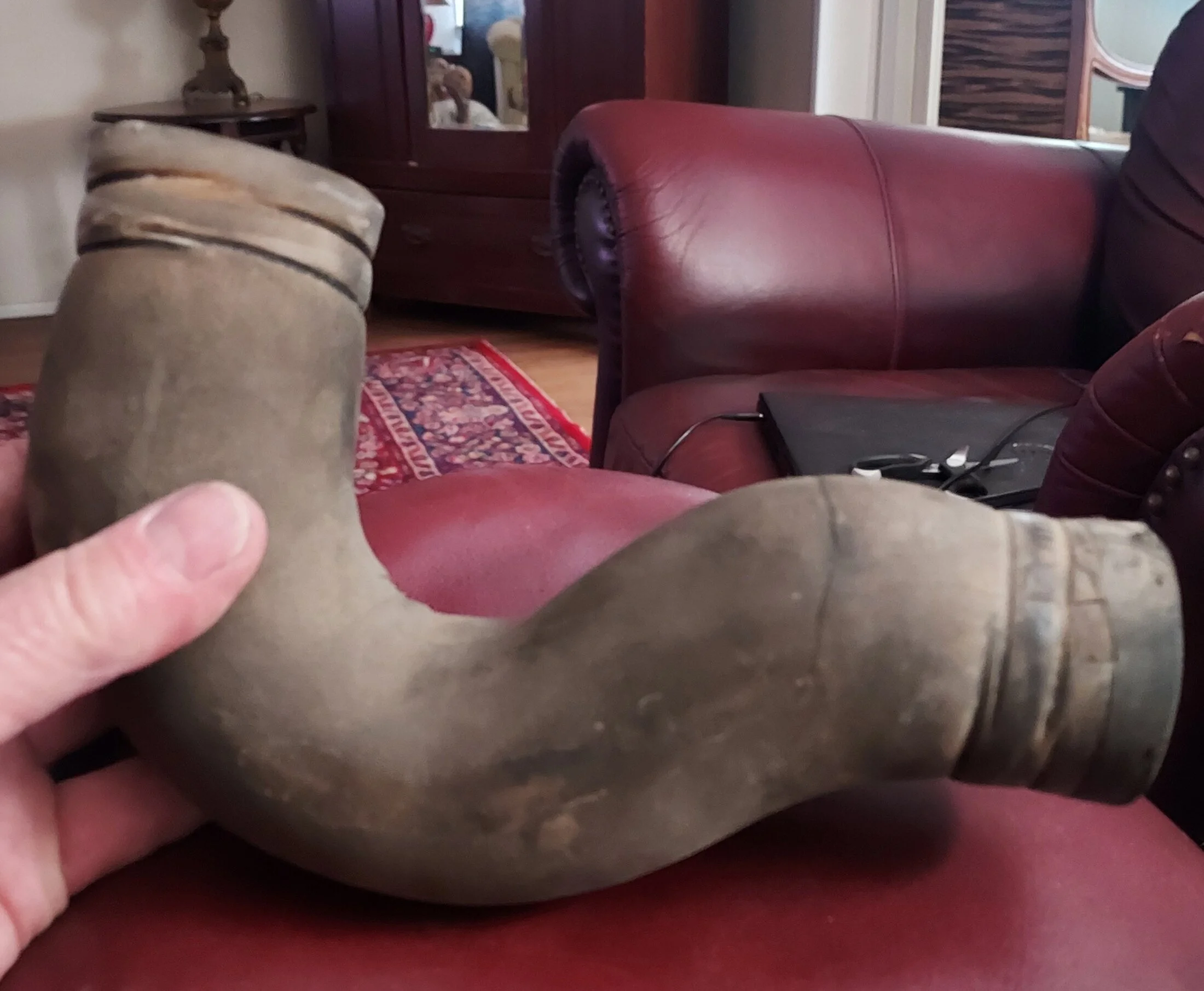

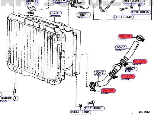

Anyone have a replacement part number for the lower radiator hose ? This is what I found discontinued Toyota 16571-60091
NAPA has one.
I replaced mine a month or so ago, 1978 pig with 350 Chevy.
I don’t have the part number, but they will match the style you have. I had to cut off about 4” on the radiator end.
Mine was not as twisted as yours, looked more like an “L”.
The one I purchased fit great on the radiator, but was super-tight on the Chevy water pump.
