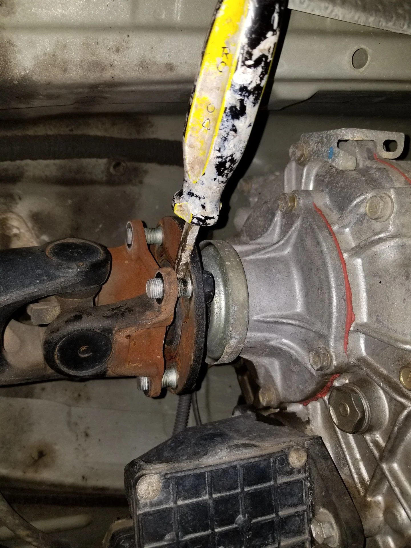

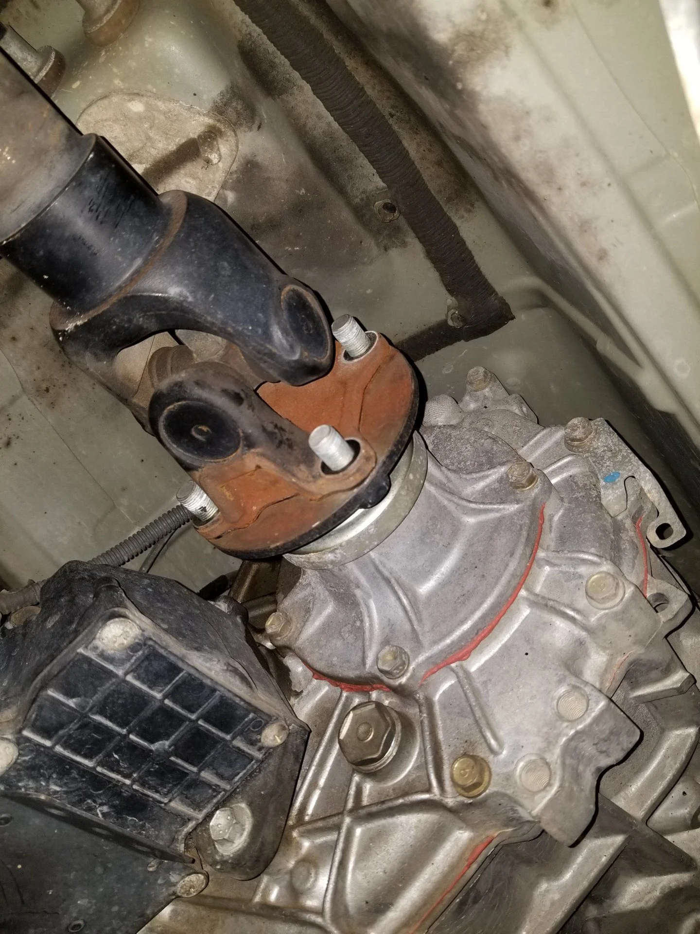

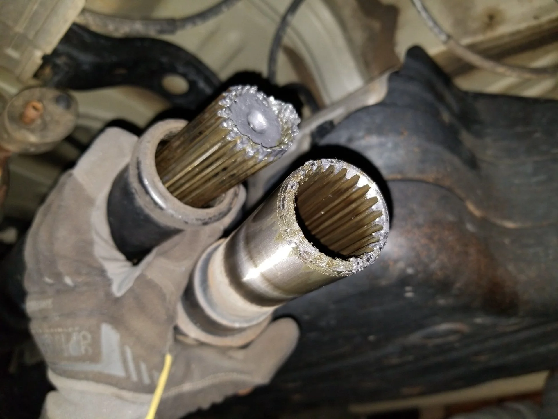

I greased my zerks last night, followed what @langsen mentioned above and separated and cleaned the drive shaft for good measure. It was easy enough. I ran out of grease halfway though so I'll crawl under again soon, but for now the thump is gone.
Removing the bolts from the drive shaft up front and you can swing the drive shaft down while still connected at the rear. Splines separate and you can clean them and reassemble and fill with grease at the zerks. I was surprised the amount of grease I pumped in the drive shaft section because when I removed it, (seperated the splined sections) it was empty aside from old residue. I had to vibrate the shaft a bit to get it off after I removed the 4 bolts. What worked best is tapping a length of pipe with a hammer that was wedged into a section on the shaft to knock it off from 14 years of security. Also a bit bummed that this GX was dealer maintained and there are comments of "costomer complains about rear thumping in service notes" and they didn't replace the drive shaft....at least I don't think they did if I was experiencing the thump. I think the dealer gave attention to brakes at that time per notes.
I had GX on jack stands so I could turn drive shaft by hand while transfer case was in neutral. Then had to put in High or Low to tighten/loosen bolts.
