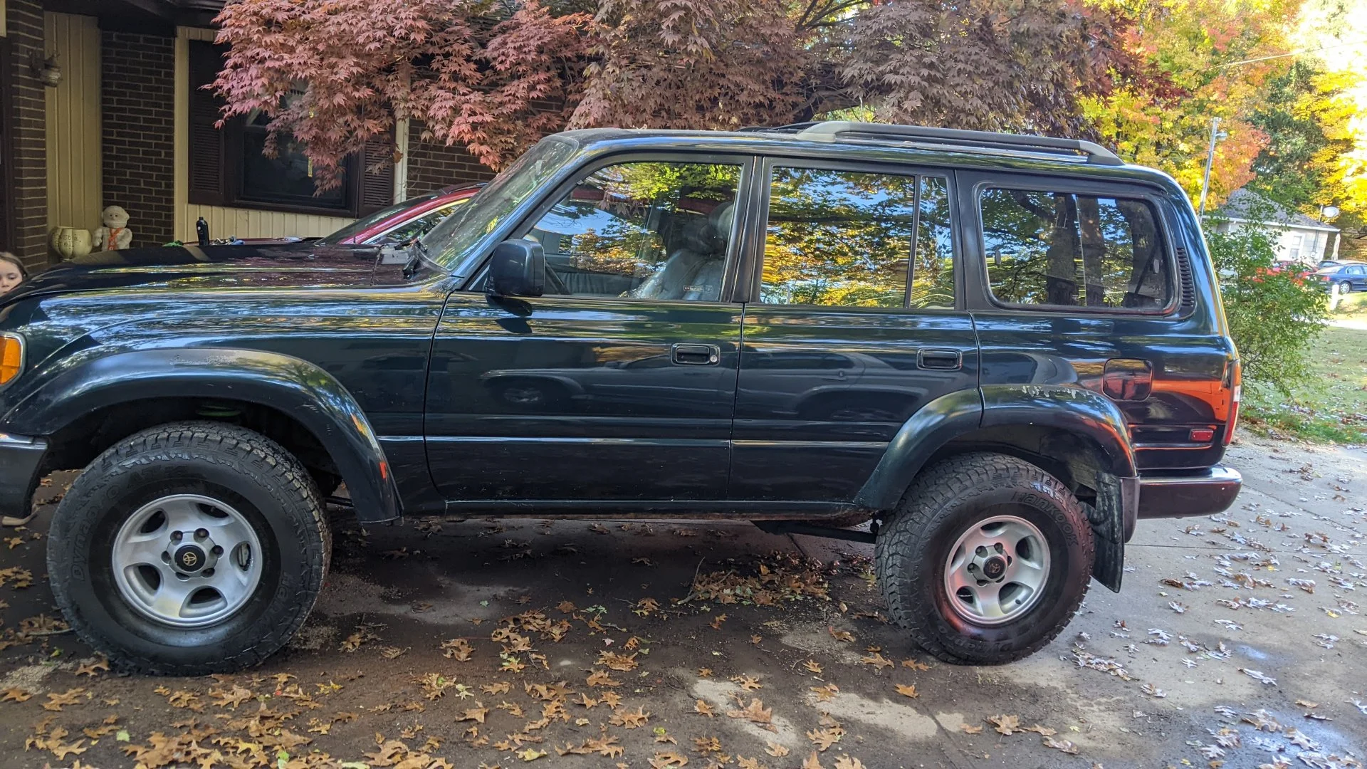

I got this one for virtually nothing out of a Kohl's parking lot in June and only then because I've always wanted one. I'm probably somewhere between 200 and 300 hours in and I'd guess $2500-$3k in parts (a lot of that was a completely new suspension) and it's still not road ready. A LOT of that time was fighting rusty bolts with extractor sockets, map/pro, and O/A so if you're in a dry climate you'll have less of that to mess with. I also took like 15 times longer than some of these guys to rebuild the knuckles, so my numbers may be off. Right now I'm fighting the braking system, but feel like I'm about to figure it out because there's not much left for me to replace. That all said, it's been a really really fun project and the trucks are some of the sexiest vehicles ever on the road, so if you have time it'll be fun.
