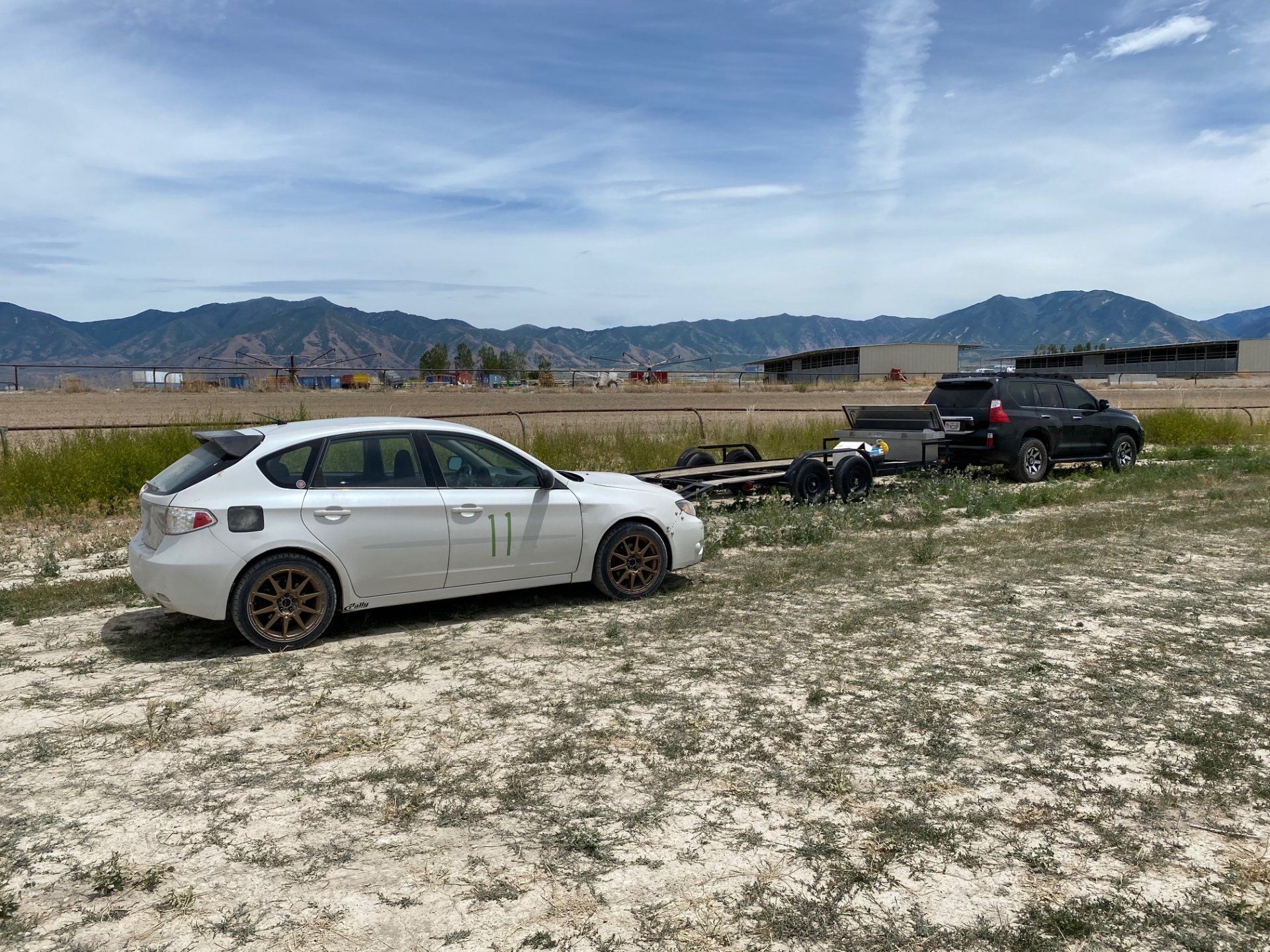

I think a GX would be a great choice for you. I have a '10 GX, '04 STi and a '08 WRX. I have towed both Subarus and the GX is capable, albeit not a complete towing superstar. It tows great on the flat but on one mountain pass I go through it's a little sluggish and trans temps can creep up on that section of road. But I also have sliders that add weight and a heavy steel trailer and hope to get an aluminum trailer soon as that would cut down the towing weight significantly. I have a Fastway hitch that has sway and weight distribution which is a game changer for towing. Make sure you get the hitch that fully attaches to the frame and not the less robust hitch with a lower tow rating.
35" tires is ambitious. 17" is a good size to go. I have 17" TRD Trail wheels with 265/70/17 Wildpeaks and E load rating (better for towing and tougher for off roading). I have a 265/70/17 full size spare in the carrier spot.
I have a Victory roof rack and it's awesome. There are a lot of options out there but lead times to production can be long.

Nice WRX!
I love the look of 35's but I'll have to see if it's feasible or go down to 285 tires for a 33" setup.
Thanks for the information on towing. If the GX 460 I purchase does not come with the towing package which adds the transmission cooler, can Lexus retro-fit this so that I can stick to OEM parts?
