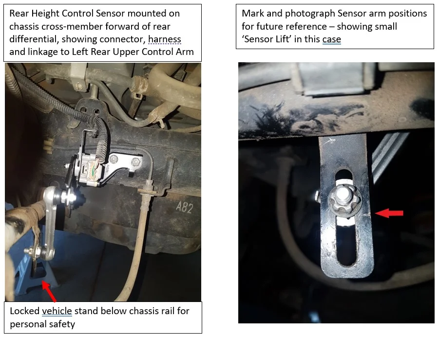

Late Edit -- Side Notes:
Height Control Sensors
These have not been mentioned in the inquiry by @TheSackettWay. These ‘wear items’ are located in the harsh underbody environment -- exposed to hot, cold, mud, sand, sticks, stones, etc. As mentioned by @uHu, these Sensors are longlasting but like other wear items -- they do eventually ‘wear out’ or are damaged or degraded and fail, sometimes with mixed and confusing symptoms. Lack of a Height Control Sensor DTC does not by itself provide assurance that the Sensor is healthy. On a vehicle which is now 19 years old, it is worth including replacement of these 'vital-to-AHC/TEMS' Height Control Sensors in the maintenance plan -- with NEW, definitely not ‘pre-owned’ parts, nor non-OEM substitutes. Some details, Part Numbers and discussion can be found in this post:
Height control sensor - https://forum.ih8mud.com/threads/height-control-sensor.1306616/#post-14851883
