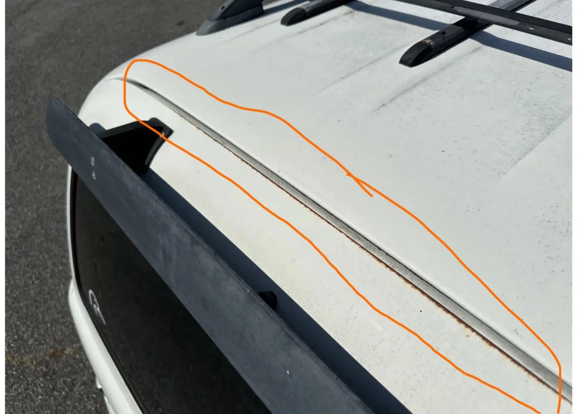

Personally, I would pass. Look for something with much less rust.
How does this rust happen? Is this a common rust area for 80-series? This is not the first truck I’ve seen posted here with rust along that upper edge of the hatch. I’m scratching my head trying to understand what would cause that area to rust?
No idea, but edges can have thinner paint. My guess, based on the rust, is this truck lived near the beach most of its life. Constant salty air blowing over the roof. I mean, it has rust in areas that I don't normally see...
My 180K mile Northeast truck does not have rust there.

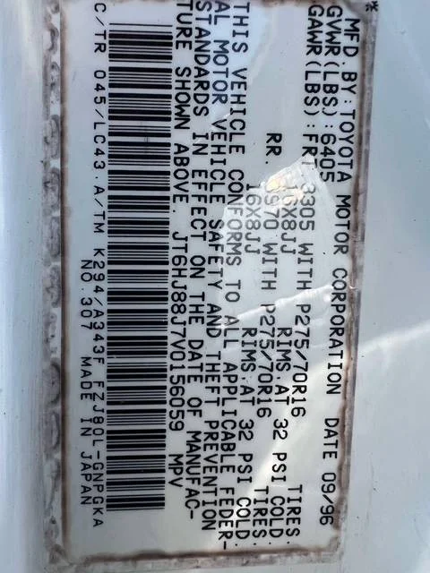

Is there a photo of the VIN? I didn't see it on the sale ad.
I like posting the VIN on the thread as a permanent record of the vehicle history if someone does a future search.
That's crazy. As a data point I have that exact truck, minus the lockers, I'm planning on listing for probably only a few grand more than that. No rust, mechanically refreshed, and out west where most examples look far better than what you're considering. I feel sorry for whover might buy that for anything close to asking
you need to look in the SE/SW for a clean truck..... that thing will eat you alive and never be rewarding, in that there will always be the "next thing to go wrong or to be repaired" that keeps it from being usable... I've had and built seven 80's so far - rust is my only non-negotiable ......
