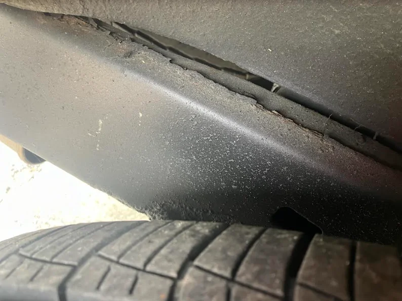

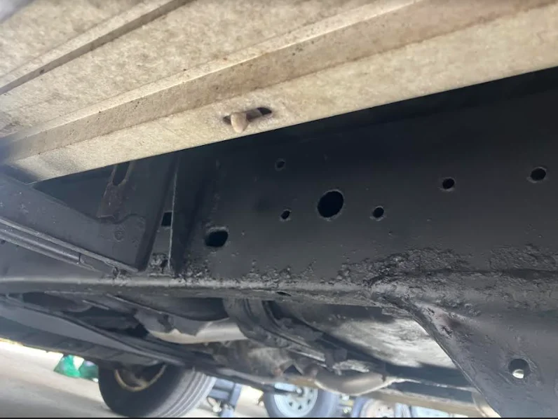

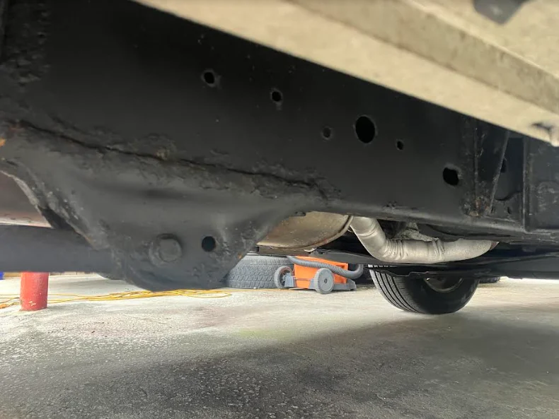

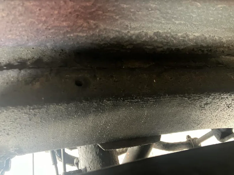

A relative of mine is considering purchasing this truck in Florida. 2005 Toyota LandCruiser. He has asked me for my thoughts, and in general I think it looks OK. The attached CarFax shows low mileage and number of owners, pretty good dealer maintenance history, but also that it lived nearly its entire life in the NE so rust is an obvious concern. Some underside pics are attached - there is some rust and it looks like it was spray painted over to obscure its true condition. That being said, I've seen 100 series with a LOT more rust, so I'm trying to get a sense of whether this is an immediate non-starter, or just something to keep an eye on in the future. My thought is that it's the latter but I have never owned a 100, and definitely didn't enjoy working on a rusty 60 years ago. If the body is rust free, would you proceed?

I would recommend that he, you, or someone you guys trust take a look in person at the undercarriage. Yeah, someone took black paint to the frame.
Considering that the body looks good, it's unlikely the frame is too bad, but ya never know.

Thanks for the reply. Yes, the current plan is to have someone local check it out and take it for a spin. I advised him to ask the selling dealer about the paint too - sometimes their response in a situation like this can be illuminating. Nice 80 btw. My old 80 is the car I most regret parting with...
That frame is crusty. I am not one that is afraid of rust, but I do fear what a shady dealer might paint over. The exhaust piping probably rusted away and has been replaced with poorly fit aftermarket. Looks like the fuel tank skid has rotted away too. Based on the asking price, I'd give it a solid, "NOPE."

Its obvious that they painted over some rust, it doesnt look bad but its definitely something i would have a pro take a look at, even if it cost $150 before a purchase. I would find a shop that does custom metal work, somewhere that deals with metal. If its bad rust it could be really expensive and might not even pass inspection in some states.
Pass, yall live in the south. The paint on the frame looks more like cover up than proper sand and repaint. It’s going to trap moisture instead and accelerate the rust. You could stick a scope inside to see what that looks like in the frame rail. Drop the spare, almost always the worst area.

Don't waste your time on this one, especially with where prices have fallen lately. For 17k you should be able to find a decent mileage, rust-free, well cared for example pretty easily. There's guaranteed to be much more rust than you can see. I'm thinking the rear hatch and tailgate are probably eat up too.
