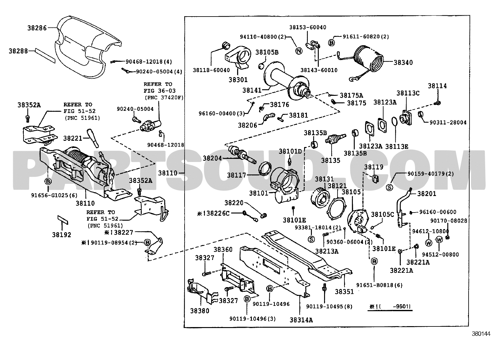

I know this might be a long shot as there isn't much out there in google world but I am looking for some info on the Factory PTO Setup for an 80 Series .
It looks like I have one on the way to fit onto my 80 series so any help would be great in locating a parts schematic or any details on it .
It will be going onto a 1994
pic
I would check partsouq. It will be easier if you could find a Vin number from a vehicle that came with one then you could plug that in
Good luck with that, going to be hard to find the transfer case parts and I think only offered on the early year 90-92 FJ80. One link with some info but i'm sure with searching there will be a few more.
yeah I have a 94 wit a PTO AWD T-Case so it should bolt on, gear is inside so from what I can find it should work but as I am finding out very few people have actually seen them yet alone worked on them.
