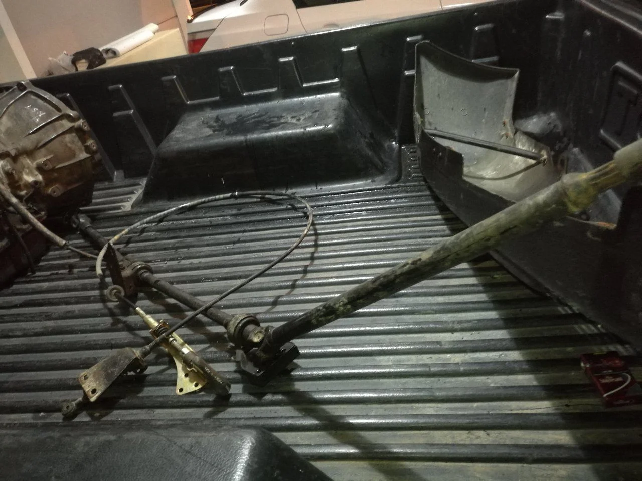

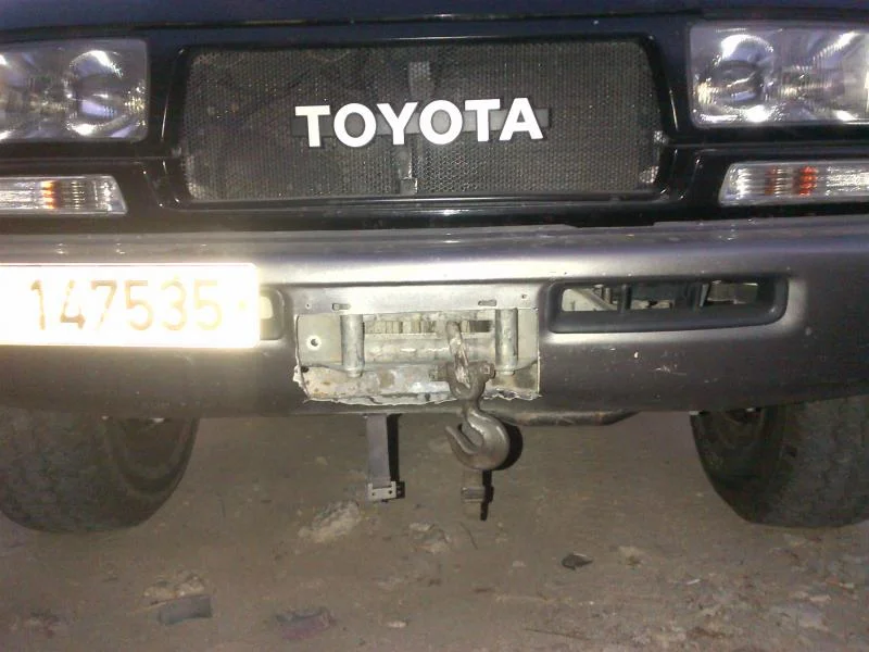

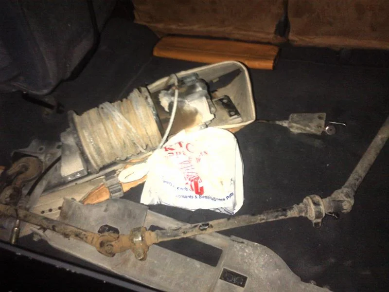

Hope my post is clear enough to understand the situation. I have attached a picture of the parts i have and a pic of the winch installed on the vehicle.

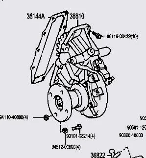

From your photo, I don't see the PTO gear case that attaches to the transfer case. Here's a diagram of it:

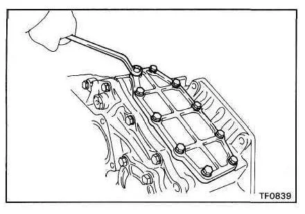

And here's the cover on the transfer case where the PTO gear case attaches:

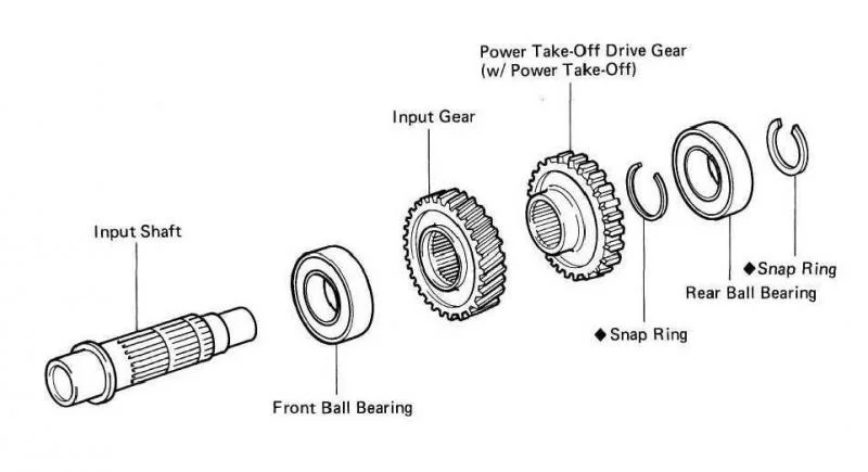

It looks like you'll have to add the PTO gear inside the transfer case as well. There may be a spacer there now?
And as far as I know, the H55 was not an option on the 80 Series. Only the H140F, H150F and H151F. All will work with the stock transfer case.

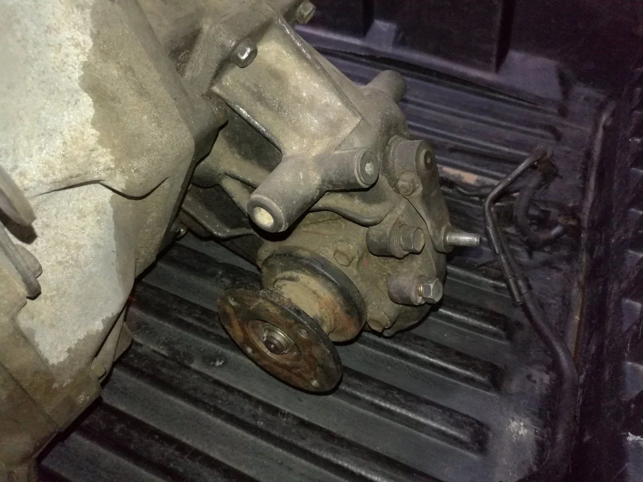

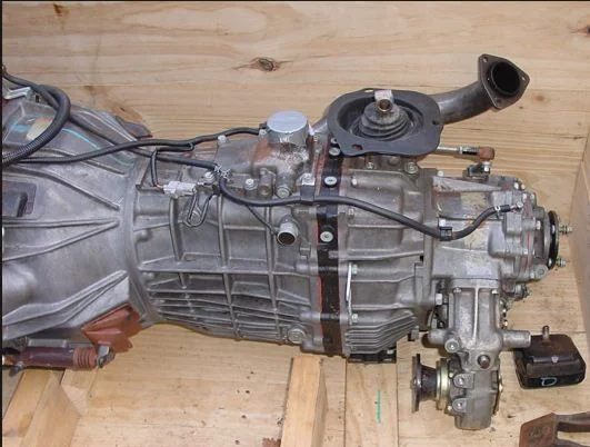

I just found this photo of the PTO gear case attached to the transfer:

The first pic of the part which attaches to the tcase is in the plastic bag in my first photo. It also includes the gear protruding from your diagram. My stock tcase does not have that cover in your second attachment. It's molded shut from factory which is why I believed it was a complete different unit.

I bought an electrical winch replacement bumper from the dealership since they did not carry a PTO winch bumper. Thought they looked similar, all went well only the opening at the top of the bumper by the grille is not large enough to control the winch activation lever on the top of the unit. I'm currently looking into modifying (extending the leaver an inch or two for it to be accessible).
The other issues im still having. I started feeling a faint vibration from the front end, could this be due to the newly mounted drive shaft? Not bothering me much but i'm just hoping its not something wrong.
Another issue is that when looking at the front of the car, you can see the winch fairlead is offset to the driver side. Its pretty annoying, my mechanic told me he would need to loosen gear mounts and shift the whole thing to the passenger side.. Didn't sound too right to me although this whole install is a learning experience for me.

I've attached the only pic i have for now.. was too busy and worked up to take any through out the install (sorry for that, i'm sure many would've loved to see how that went), I'll take some more this evening and post them too. Let me know if you'd like to see any specific shots.. The pic of the bumper on here is my stock bumper modified for the application. That didn't go to well which is why i ditched if for a new one with a factory opening. You can see from the pic though how the winch is slightly offset.
