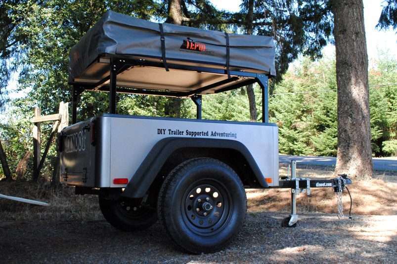

Garage sale Dinoot trailer:
Nice anyone have experience with these?
Yeah, People are sure $$ proud $$ of their trailers. Seems like finding one far away or building one out is the best bet.
If you have some skills and resources...there's lots of folks willing to help you along the journey. The biggest obstacle can be the "base" trailer...as far as tacking stuff on, it just depends what your needs are and your budget can bare.
He's been building them for a while, might look to see if users have posted on Expi. I think his user name over there is "compactcamping" or something like that. Started out making a tent that could convert a 1/4 ton mil sized trailer into something very similar to the VenturCraft TrailBlazer. Unfortunately it looks like those tents are out of production.
It does suffer from the same tongue design flaw as the trailer above, but if not going to be loaded full of gravel or similarly dense material it may not matter.
