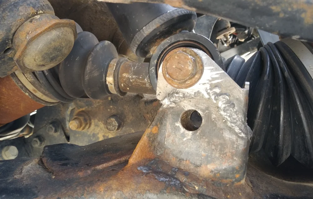

On the front, it really is easy to add droop by adding a spacer at the bottom of the shock, where it mounts to the control arm. I started with the Japan 4x4 spacers, but wasn't thrilled with them since their size allows the CV boot to contact the spacers at large steering angles. I eventually took them apart and just welded a piece of them onto the top of the shock mount on the control arm.
This is actually too much extra imo but it's very close to correct. On the driver's side only, the UCA just touches the mount at full droop. When I replace the LCAs eventually, I'll weld similar extensions onto new arms with very slightly less height difference. Remember the motion ratio here - I added about an inch of extra height at the shock mount, but that translates to something more than an inch at the wheel. Also, I get pretty drastic toe-in at full droop now as well - the steering rack is outside its happy zone for sure.
I am thinking about that now ... time for new LCA bushings for me so I might buy some new LCAs that come with all the bushings etc ... then I can take it to a fab shop and have them cut off the factory lower shock mount and put a 3/4" plate there and then reweld the factory mount. I wonder if you could ... move the mount inboard or outboard ever so slightly if that would have any positive effect. Unlikely but from your experience I wanted to table the idea. If I could find a fab shop that could make LCA's but two inches wider/longer I would have them fab UCAs and then a custom axle that is also longer ... build a coil over AHC shock like the 200 series with custom buckets ... but ... I will keep it simple and just try and squeeze an extra inch of droop at the wheel. That will make me happy.
