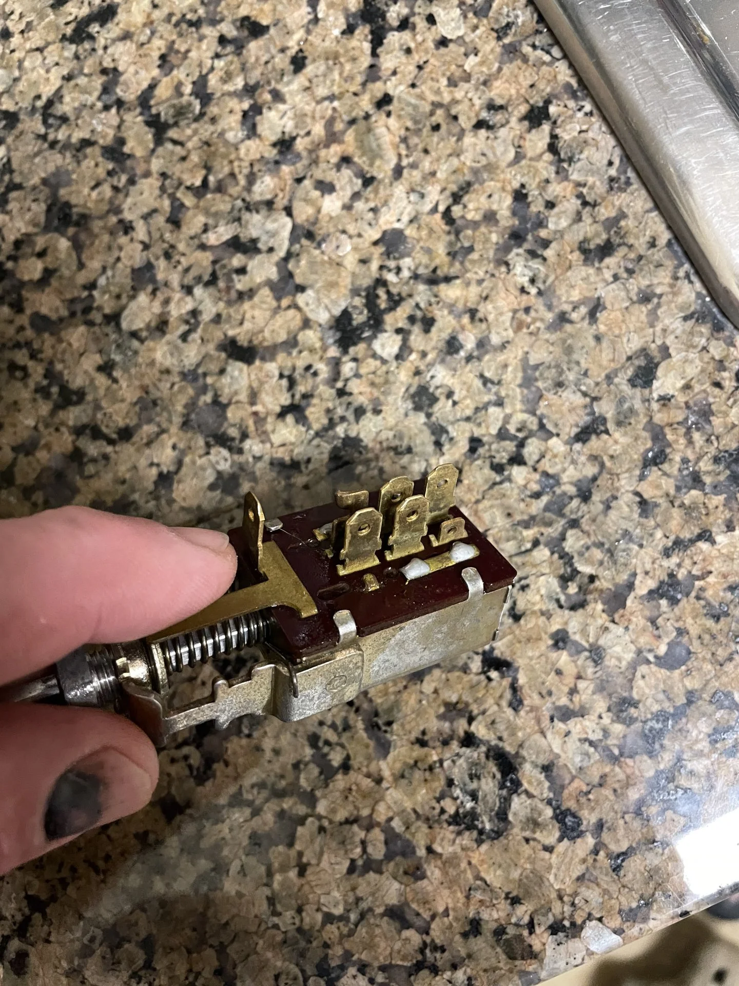

Not sure if I’ve got the correct wipe wash switch mine works the wipers but will not squirt when twisted.

Man that’s awesome, thank you. Great I’m using the correct wipe wash switch, must be a ground or something.

Make sure the switch is well grounded. Typical to Toyota wiring practices the wire from the washer motor is (should be) hot to the wiper switch. Check the wire for power too

the wire is hot, need to double check the switch i guess

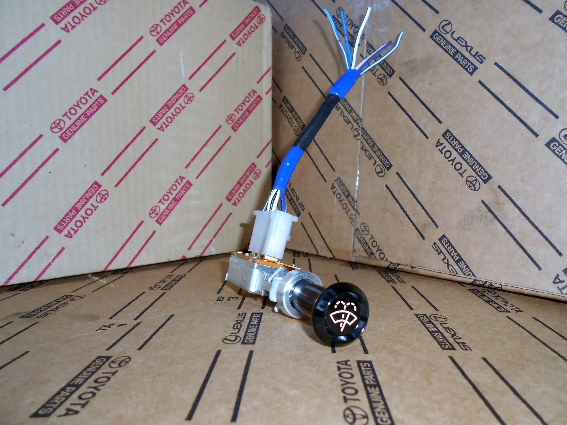

- the washer pump motor IS controlled by a GROUND path switch leg NOT a B+_
fyi
Does a wire plug into this> if so what color?

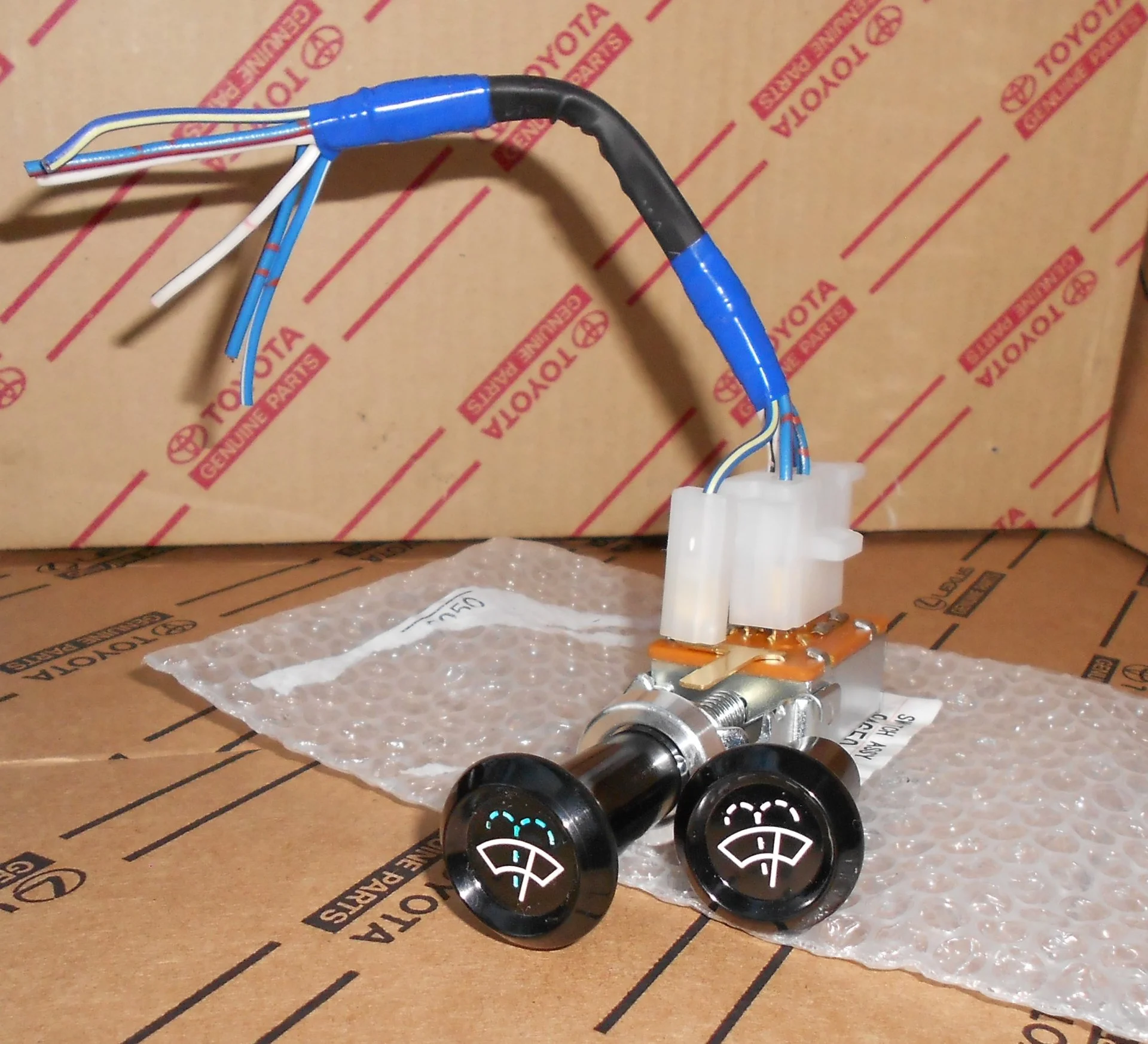

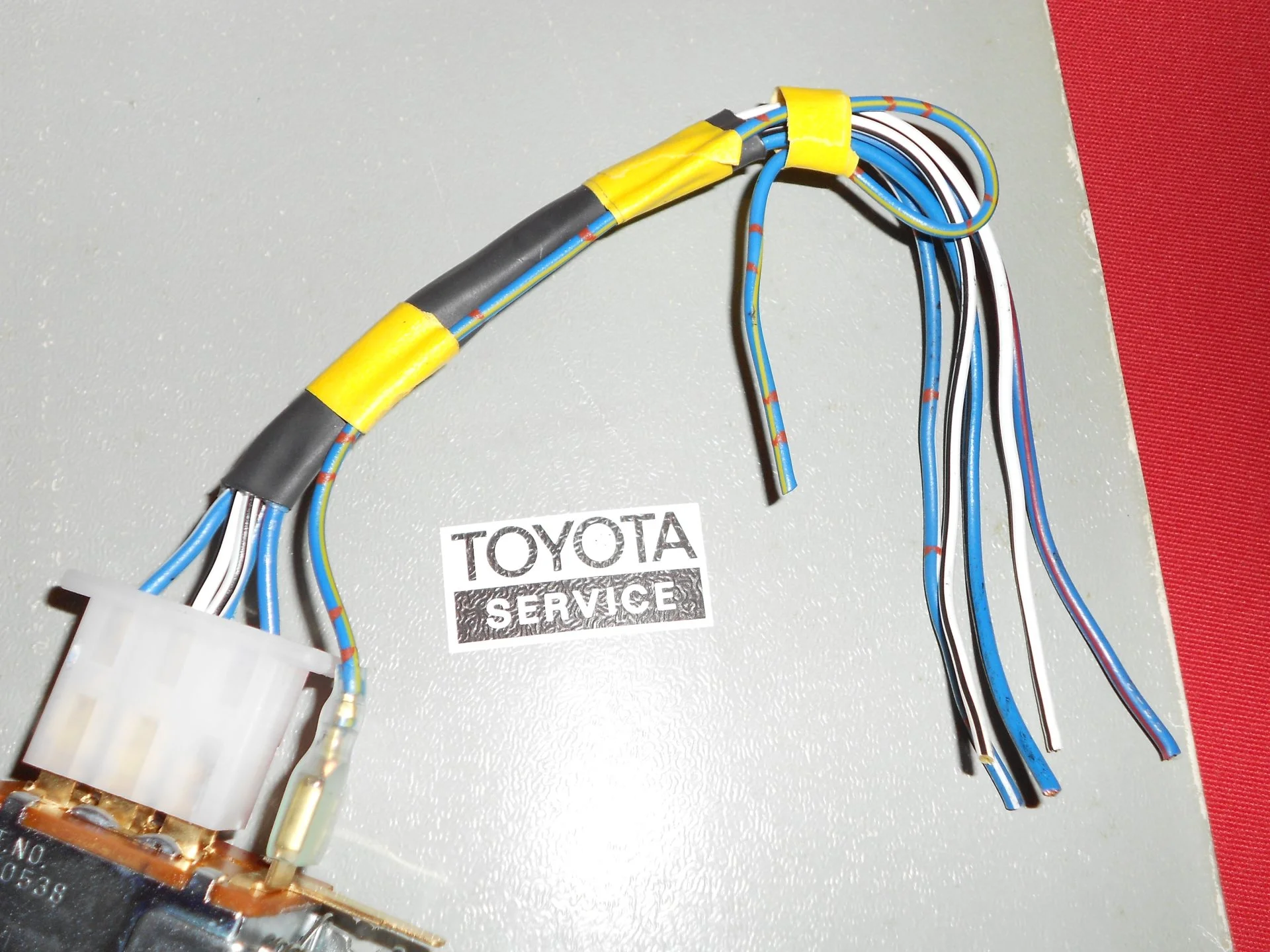

blue wire , yellow tracer stripe

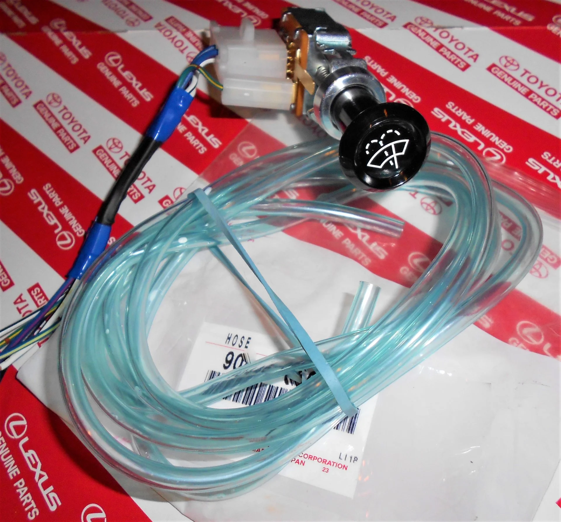

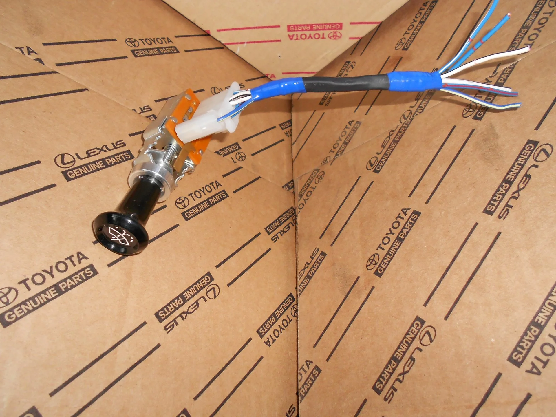

washer pump GROUND side switch leg circuit i mention above to be klear
see my TECH reference photos below of the correct wire layout inside the connectors attached to your era wiper switch
please let me know if you have any more tech questions or if i can assists you with your needed parts ?
