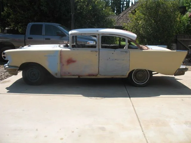

I like the way your photo chops looks, but had one little comment.
You may need to eliminate the strip between the doors, most four-doors these days just have a little bit of clearance where the doors come together. What hinges do you plan to use?
OTOH, my '57 Chevy does have a small piece there. The older cars were better made, but were they better designed?

I may end up doing that if needed, i'm just kind of winging it for now but i'm shooting for what the photoshop shows. I'm not sure what hinges i'm going to be using, going to try stock but would need to make a little pocked at the front of the jam where the fender would normally be

I would have to disagree with both statements. The older cars were not better made. Were the made of heavy steel, yes. But they didn't see the road miles that today's cars do. An old car would go 60,000 and need an engine rebuild, today's cars at 60,000 are just being broken in. Plus today's cars are much safer. Long gone are the days of a hood going though the windshield and decapitating the front seat occupants.
