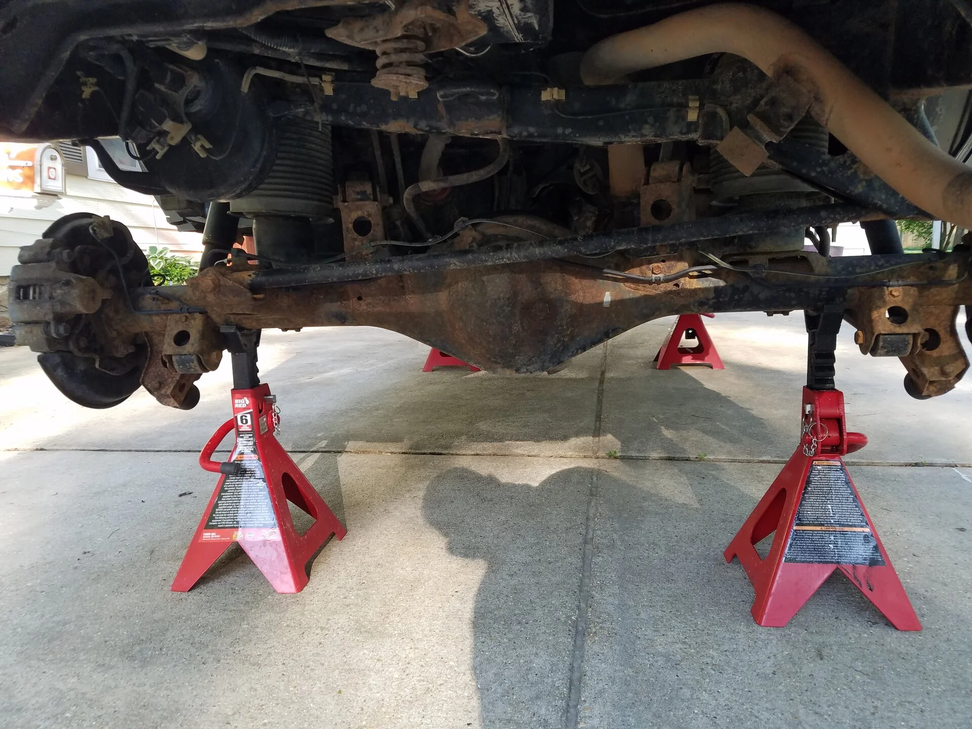

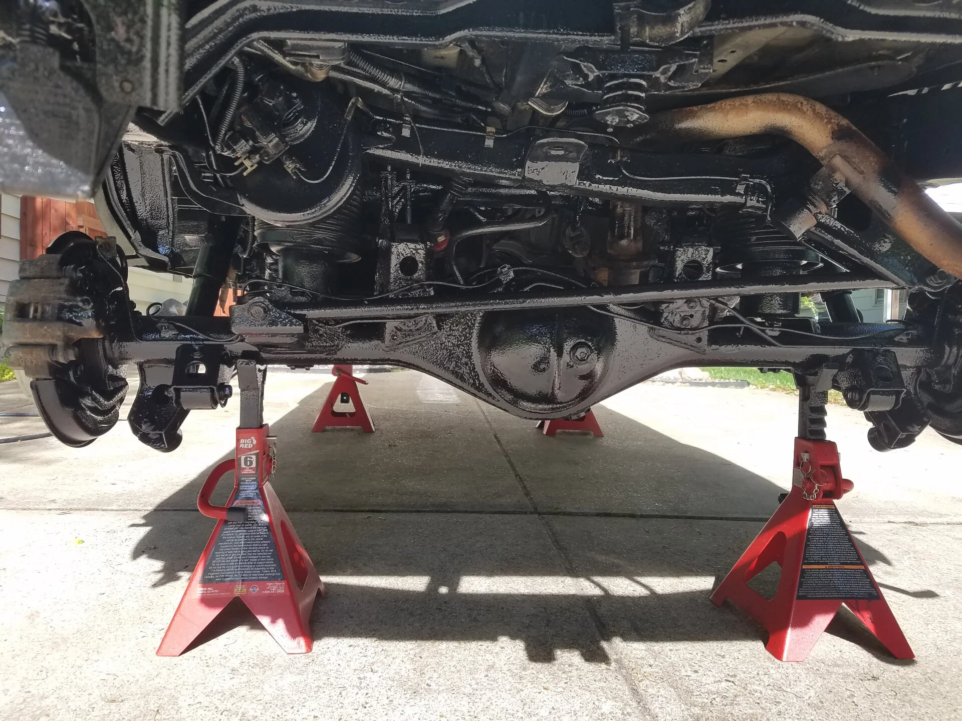

Congrats! If you want to DIY the undercoating the Woolwax gun is pretty good and you can run it with a small air compressor. On mine I pressure washed the underside, applied Woolwax Black on exposed surfaces, and put Fluid Film inside the frame. A before and after of mine is below.

Nice! Did you remove any rust beforehand? Or does Woolwax protect + stop the corrosion?
I just pressure washed it and applied the Woolwax. It seals the rust from air/water and should more or less stop it as long as you stay on top of the coatings. I re-applied after ~6 months and haven't applied in almost 2 years, but it's due for a coat this winter. I usually touch up the rear fenderwells every time I wash the rig, and they have a really nice coating on them as a result.
That Black Woolwax looks good. Better than some of the other stuff I've seen, especially when applied over a course rusty surface.
If interested in trying to remove some of the rust without wearing oneself out, try Oshpo. It can be sprayed on and in all the crevices. Let it dry for a day or so and spray choice of lanolin based sealer. Ospho is cheap, comes in gallons, sprays like water, and goes a long way.
