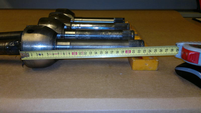

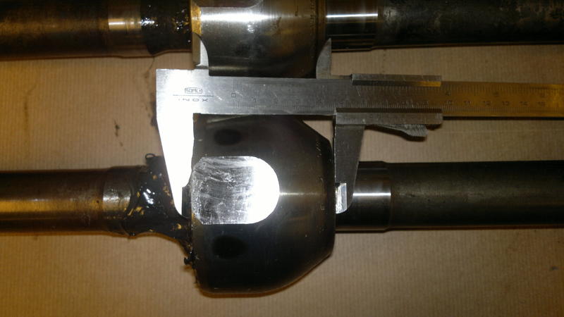

Like promised, just one week later:)

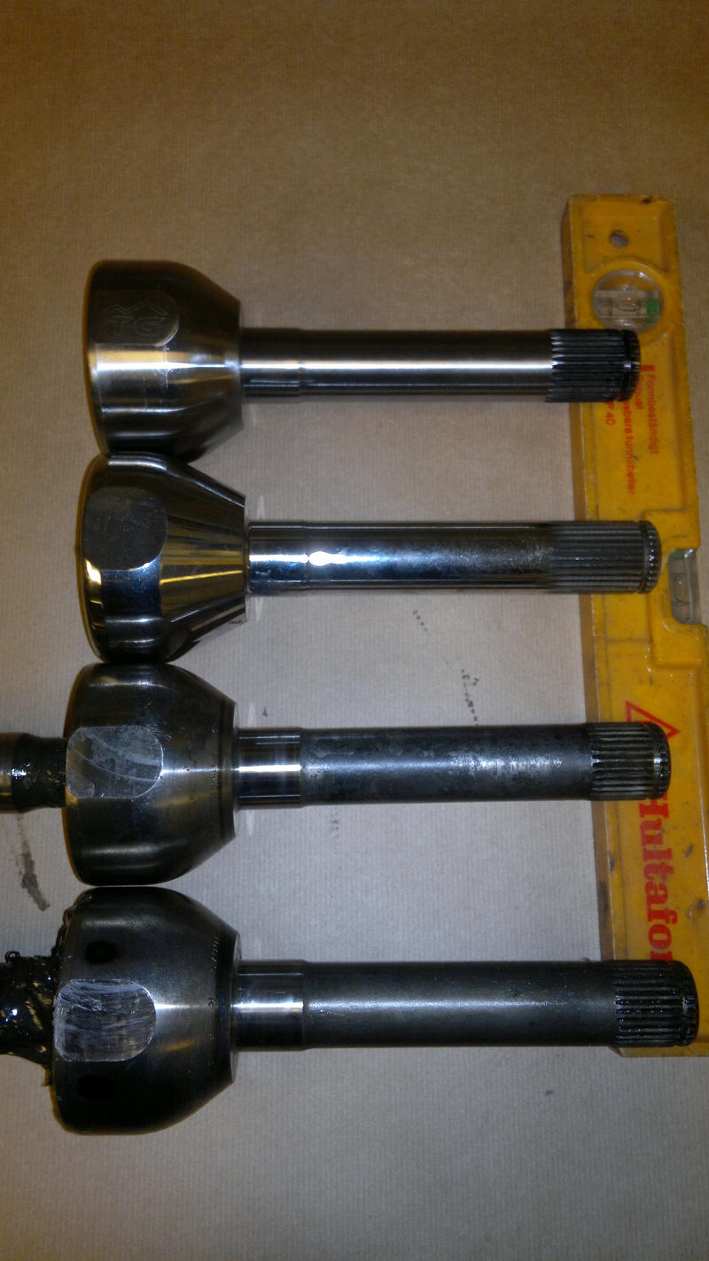

The first pic shows from the top:
1.Trailgear Hilux/4Runner
2.Longfielld Hilux/4Runner
3.Toyota LJ 70/86 Model
4.Toyota HJ 60/84 Model

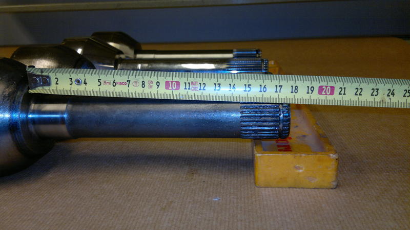

This messurment of the "bell":
1.62 mm
2.63,5 mm
3.61,5 mm
4.61,5 mm
This messurment of the lenght:
1.23,85 cm
2.24 cm
3.23,65 cm
4.23,8 cm
This messurment of the lenght from the bell til the clip cutout:
1.17 cm
2.16,95 cm
3.17 cm
4.17 cm
Make your own conclusion and decide.
Matt
Just a note that the high pinion 8" diff running in its proper direction is not inherently weaker than the 9.5" running in a reverse direction. The 80 series uses the high pinion 8" differential, and though it has a stronger casing and housing, there aren't really that many failures with them.
If I was needing to, I would run the Nitro parts - JT's supplies some very nice stuff and they are very easy to deal with.
~John
Just being curious.
Do the Nitro inner axles have the longer splines for cable/e locker as an option?
