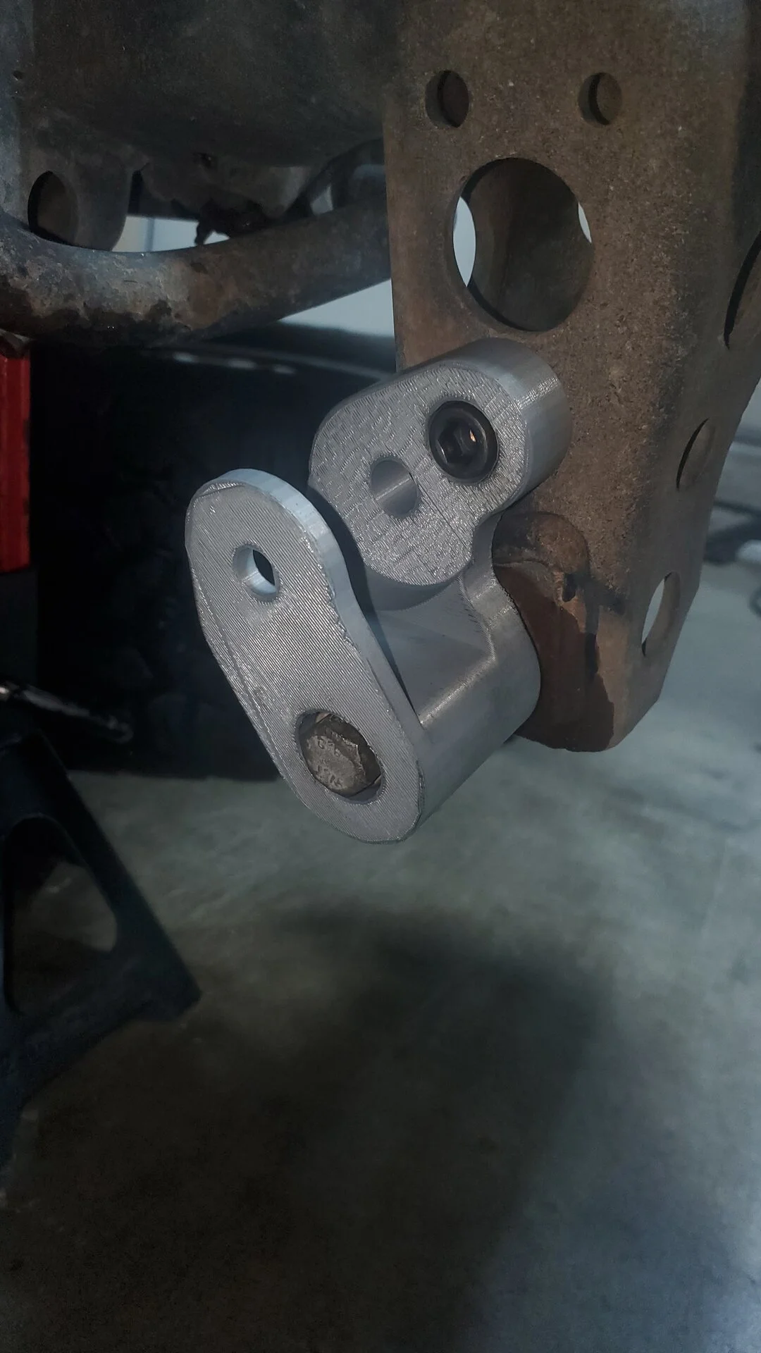

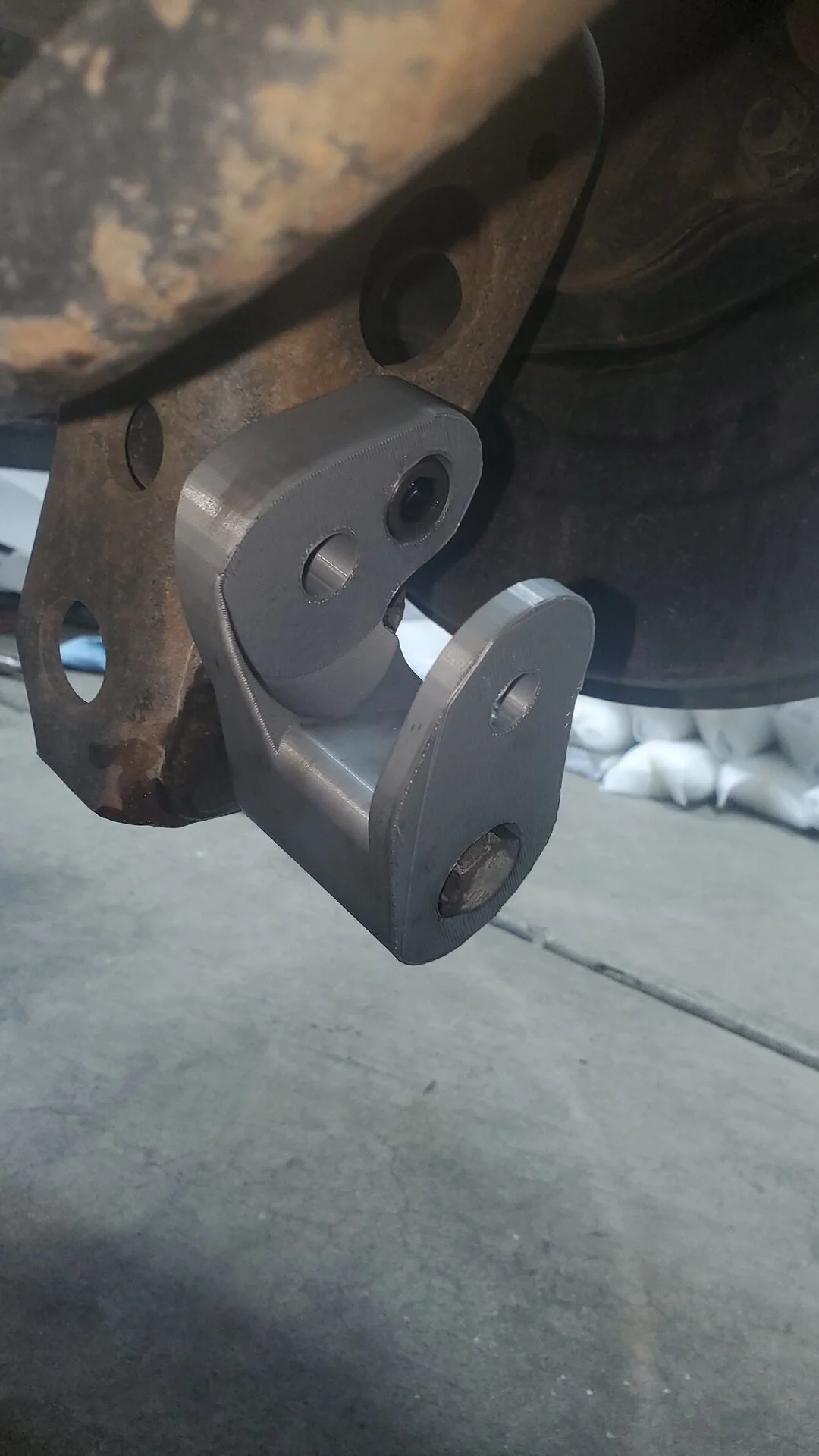

Unless anyone sees something obviously flawed, I'll make a 3d print to verify fitment on Monday.
I don't have a dog in this race (no AHC), but I know it isn't uncommon to have the lower shock stud bent a little bit with use (or the mount itself be slightly out of whack from taking rock hits). What is the tolerance for the stud and mount to be a little imperfect?
I didn't realize the stock mount had an issue with bending. Do you have any pictures of a bent mount, are yours bent?
The hole I was going to index off is ~15mm and the bolt to secure it is 12mm. So +/- 1.5mm.
I should have prefaced that I haven't seen a bent one on a 200/LX, but I know I've seen 80s and other various studs bent. I don't *think* mine are bent!?!:steer:
Also, it'd be difficult to know if they are bent or not in OEM form, simply because the shock bushing and stock mounting allow for so much variation (you wouldn't notice small issues with stock parts), and it's not a part that you could look at and easily tell. You may not notice until you tried to mount up the relo bracket.
It fits without interference.

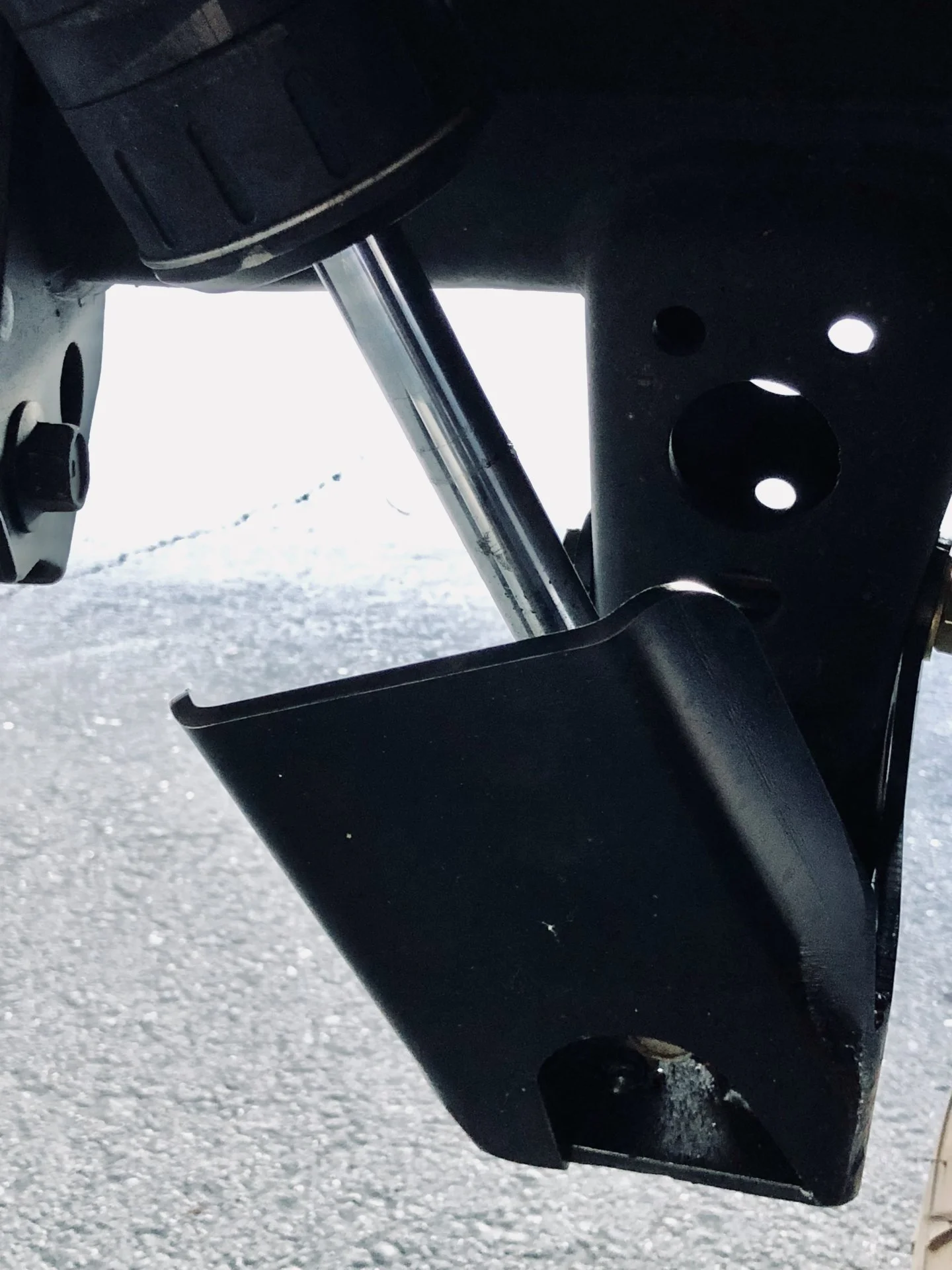

Anyone know if these will work with my TT shock guards? Just got them, haven’t even opened the box yet. Based on pictures, I suspect it’s unlikely, maybe with some strategic modifications.

There potential to modify the axle side lower shock mount by relocating that higher, but I figured it was cheaper, easier, and reversible if I modified the shock.
Post a picture of the guards? Shocks with these adapters will be 1.75" higher, maybe not needed anymore?
Weird iPad interaction, hopefully this works.
Also, I’m still in either way. If I can’t make the guards work I’ll pass them along.
I have the same guards from TT and am pretty hopeful that they'll work. Not clear yet how useful they'll be at actually protecting the shaft. Probably have to figure out how to move the guard up to the next hole as well.
